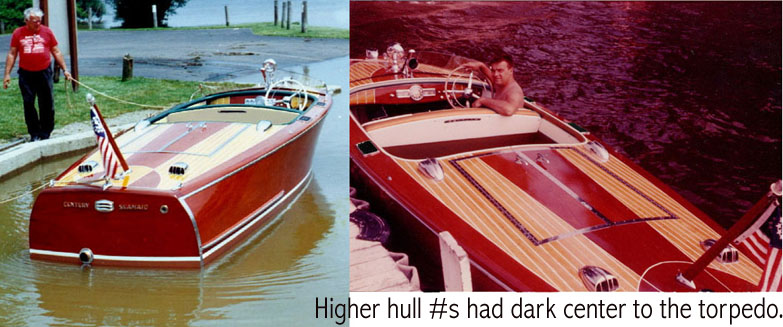

This hull #48173 and has the dark through the entire torpedo, so must be a later 48 according to the website. Thanks for the assist. Off to the Washington Navy Yard today. Back late Wed night.
