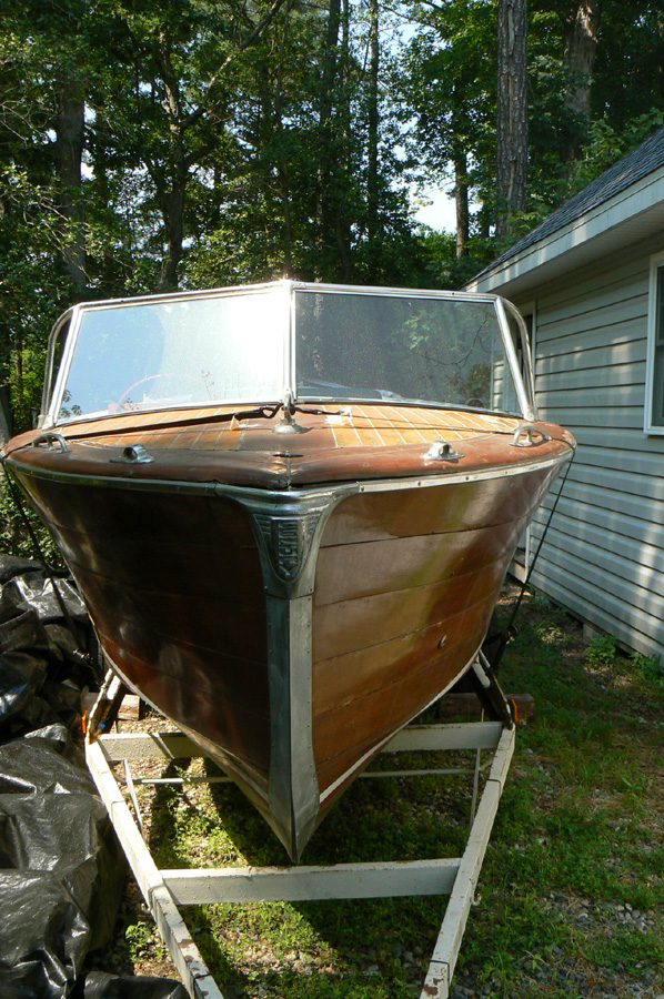

Well it's a done deal. She's home and parked next tot he shed for right now. I did cover her with a tarp but that picture just isn't interesting. :laugh:

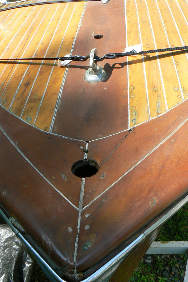

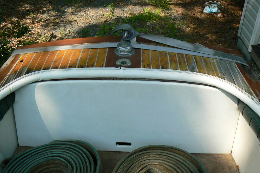

Bow close up, needs some work. I do have a new bow light that came with it. I have to find the spot light. It has the whole but no light.

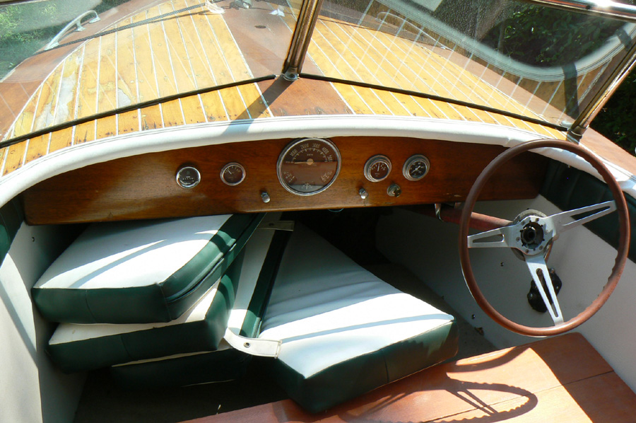

Came with the cushions too. Whole interior was done but not sure when.

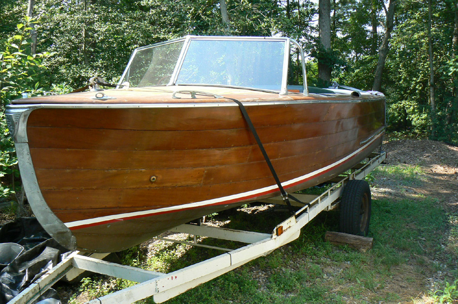

Yep he threw in the straps also.

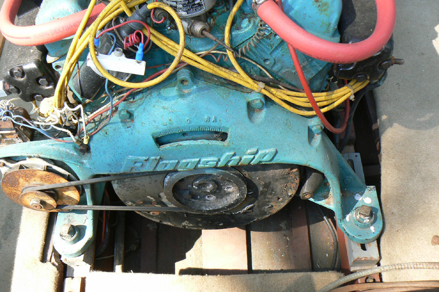

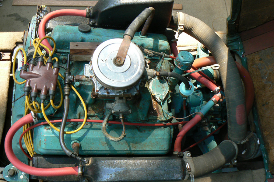

283 Flagship
Here's the "front" of the motor. This motor drives the transmission from the front. The flywheel drives the alternator, crazy hugh?

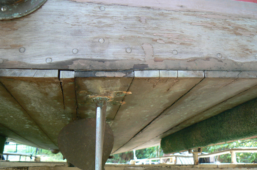

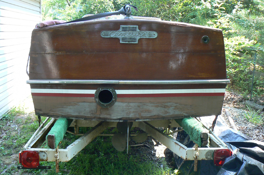

The bottom needs some work also. Was supposedly done in 2004 but it wasn't painted , at least not well and there's a couple of cracked planks.

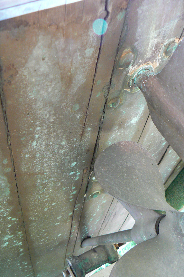

Couple of more cracks.

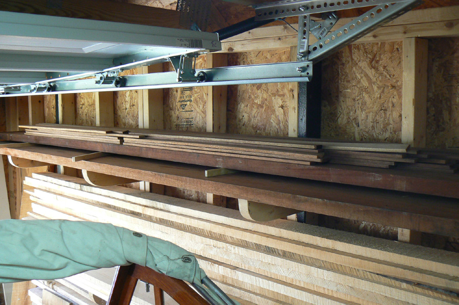

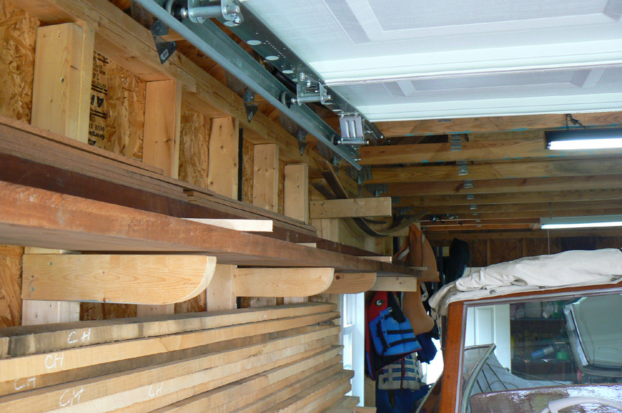

Here is the wood he threw in for the boat. Close to enough to complete the whole boat. Well top side and sides but he didn't figure in the bottom. Can't complain it's Mahogany and the narrow deck planks are already done just need to be bedded.
Another shot of the rest of the length. It's a 5/4 8" x 14' and a 5/4 12" x 14'!

1) Do the narrow deck planks have to be the same size as the originals? The ones he gave me are about 1/2 or 3/4" narrower.
2) Where should the build plaque be? Looked all over the boat and can't find it. I'm assuming it should have been on the inside of the transom. They may have taken it off when they reidi the transom and didn't put it back on. I'll probably have to get ahold of the guy and see if he still has it, unless it's some place I didn't look.

Bob, you're going to have some fun!!! Looks good. Are you talking about the blonde planks? You want them to be all the same width for sure and you want the rest to be symetrical(sp). I don't think you'll have to change as much wood as you think. Like I mentioned before, contact Joel at antique boat center and he'll help all he can. Shoot him some pics and he will be better informed. My Owens had a plate but was unreadable. There was a no milled in the board fwd of transom and I took that to be the ser no. Again great find, have fun.

Wow, thats a sweet old boat. Is that a corvette steering wheel?

Yep it sure is. I have to try and find an original one if I can. Want to make it all original if I can. Worth more that way.

get rid of the checked planks on the bottom (obviously). I would also do the same on the decks and be sure the decks are tight. Great looking boat. That 283 Owens Flagship motor should offer you years of superior service. 185 HP Bel Air set up yes? Mine were modified to produce 220 each but were still economical to run (as long as I kept the secondary carb circuits shut). Enjoy it good man!! Happy 4th

Jim, thanks, yep plan on redoing the bottom, "again". Half tempted to "dry bottom" her. !/4" marine ply with the planking installed over it. Couple of places in Michigan restore the woodies this way, Chris Craft, Century, Garwood. Not sure about the Bel Air setup. It has a Quadra jet on it.

wow bob she sure is beautiful,i love that nose peice and keel guard,you will make it even more beautiful,i have no doubt of that!

Looks like quite a find! Check the whole bottom out, framing and transom bows are the areas than go bad. The bottom planking is usually about 3/8" thick. You got a project on your hands but it looks like you're better off than a lot of others I've seen. Good luck.

Century has all the old records of their boats. The hull number will be stamped on the engine stringer, and also the lower starboard transom waterline area, outside. The engine configuration is not unusual for these boats, my Century Sabre has an AMC 327 with flywheel forward, runs like a champ. Hook up with the Century boat club, it's a free forum on Yahoo and we will all give you the best of the best in restoration. Dannenbergs books on wooden boat restoration are the bible for what you are undertaking.
