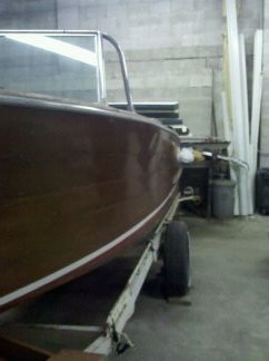

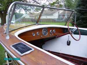

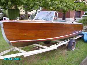

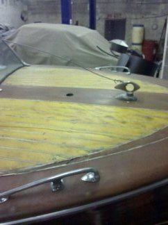

OK folks, need an opinion here please. Is this boat worth $3.5K?
It's a '53 Century. These pics are from 2005/

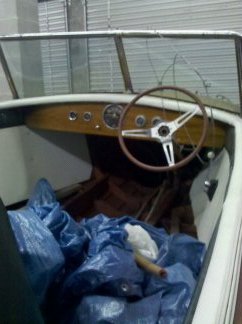

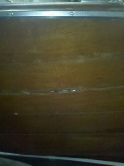

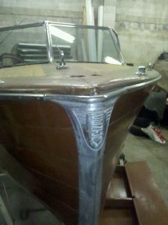

These are current pics up close with my cell phone.
Bow is coming apart a little on it's port side if you look close.
Couple of spot like this on the hull, all above the water line though.

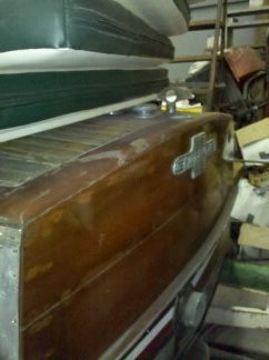

Here is the transom. The bottom and transom have been replaced, so I was told.
The bottom is suppose to be a "no soak" bottom, overlapping planking I was told. Looks solid form inside but I forgot to take a pic. The seats are there and it has the 283 Flagship marine engine that was winterized about 5 years ago, been inside since. All hardware is there but needs to be re-chromed.
Your thoughts and inputs would be greatly appreciated.

Yes as long as it is complete and all her original hardware is there including the motor. If no motor is available I would estimate $1500 to $2,000
Some boats are only good enough to be pattern boats and you should see the price people get for them. It depends on how rare, what work is needed and how original. The final outcome on value depends on how precise the restoration is.

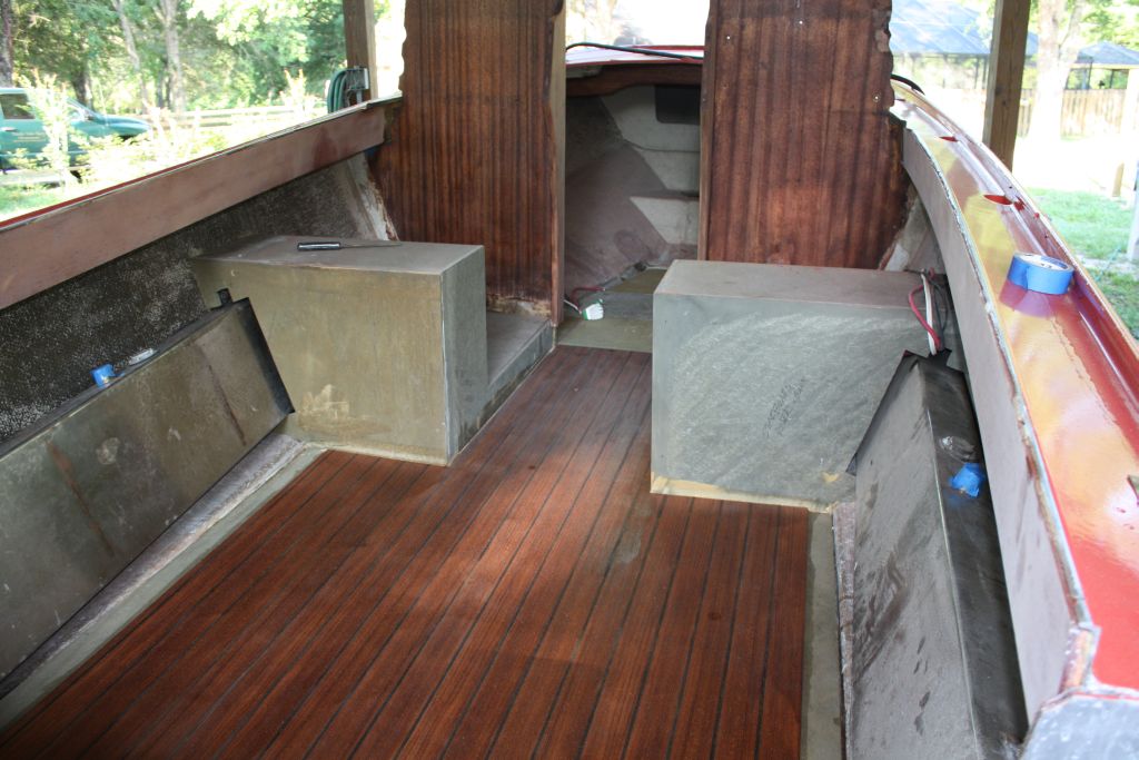

I am also a rep over at Antique Boat America and if you need parts for the Century I am sure Peter will have what you need. If you move forward on her just take your time with the project be sure to get a book or two and do some reading on fasteners and techniques.
If you can remove the engine etc... flip it over and check all your fasteners. being a lake boat I am sure you will find your share of them that will spin in place. The wood gets sick around the fastener. Sometimes you can go up a size or two or increase the length a little but if you find a whole frame with spinners then you need to consider replacing the frame or sistering it.

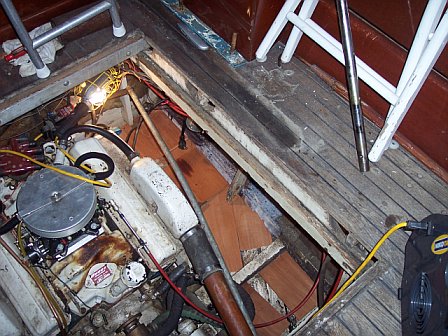

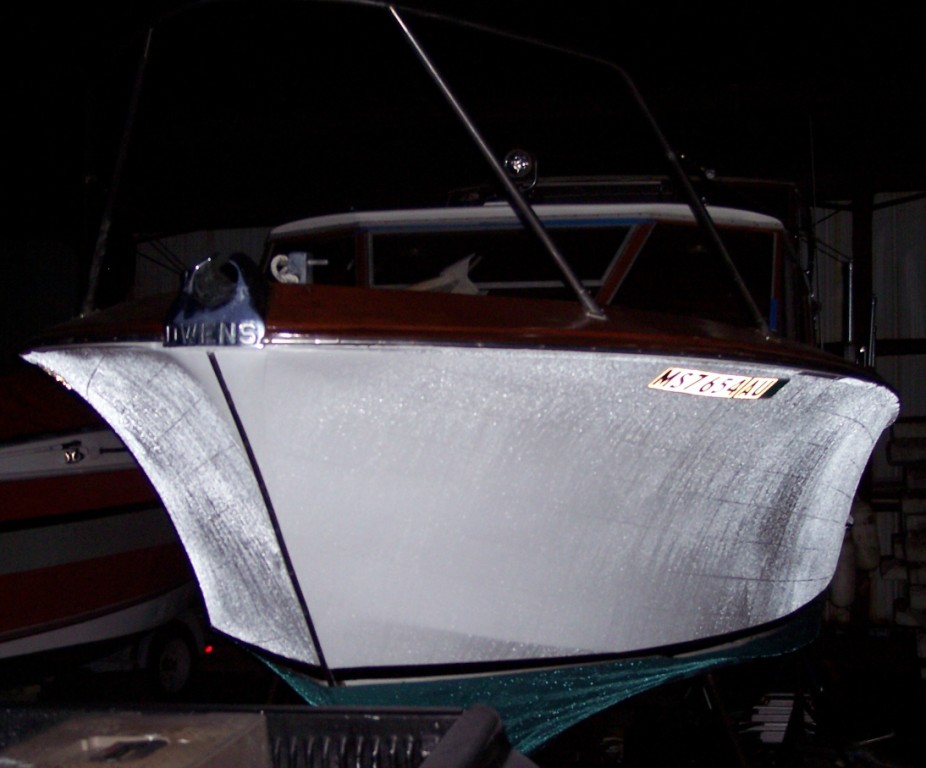

Time consuming work but it is easy work (even if you can not flip the boat) just crank the tunes and think happy thoughts of the ride once it is done. Here are a few pictures of how far I took my 1959 Owens Flagship apart. We had BIG Holes In the Bottom!!! it took me all summer to do everything I did.
Centuries are some of my favorite boats.
PS Please do not shove 3M 5200 in the seams!! fasten her well and then if you do not epoxy the bottom use Davis Slick Seam then apply your bottom paint. It is wax based what ever you put into the seam will squeeze out as she swells easily and will not be permanent. Do NOT use stainless fasteners I do not care what anyone says use good bronze. I know it is a staggered seam bottom but she will need to swell a little. Also be sure you re pack the the rudder post and shaft log bladders with fresh flax.
