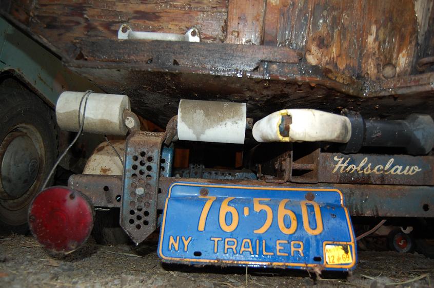

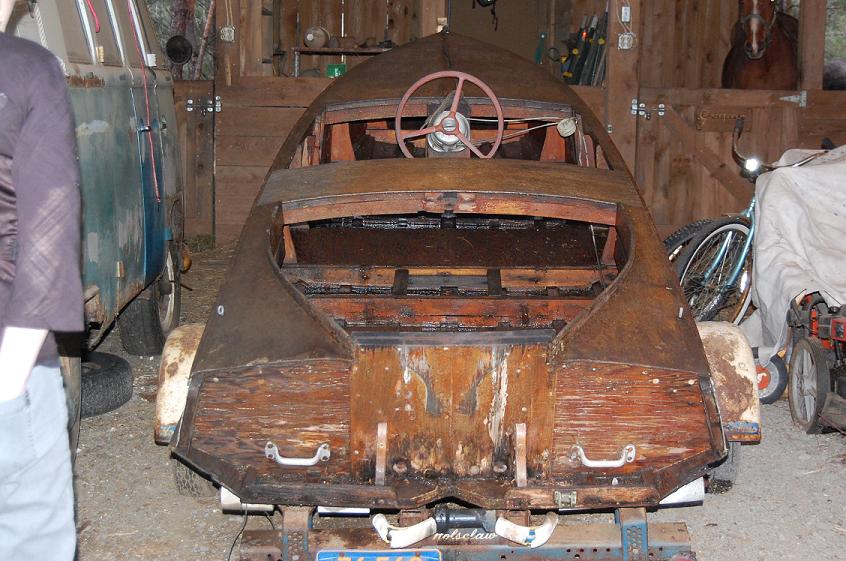

TOPIC: mid 40's Hydro plane? For sale down the road.
Re:mid 40's Hydro plane? For sale down the road. 15 years 2 months ago #31302
  • Neil
  • Neil's Avatar
  • Posts: 1997
  • Karma: 65
Grab it and hang onto it if you can.
Looks like it may have a neat history.
May be able to track the #.
Neil

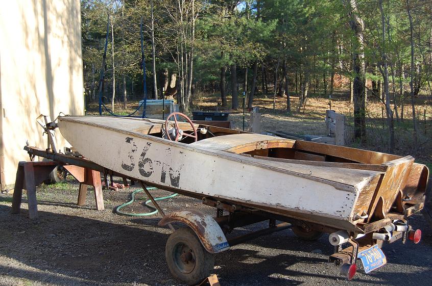

I am going to stop by latter tonight and make an offer I think, I just dont need another project I think it would clean up easily though. And would fly with my 1955 Johnson 25.... . But it is from the Southern Albany area as best I can tell this one is up in Berne NY. I will keep you posted.
Re:mid 40's Hydro plane? For sale down the road. 15 years 2 months ago #31353
I'd certainly grab it. If it is indeed 13-14 foot, a 25hp Big Twin Johnrude would be a nice set-up, ala the old 36 Class. Looks like someone moved the steering wheel into the fore cockpit. If you want to live, move it back to the rear cockpit!!
See if it has any hardware. The deadman throttles are nice finds!

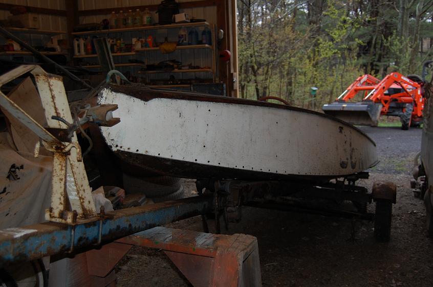

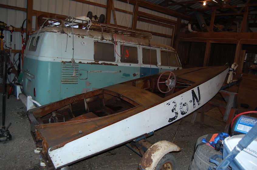

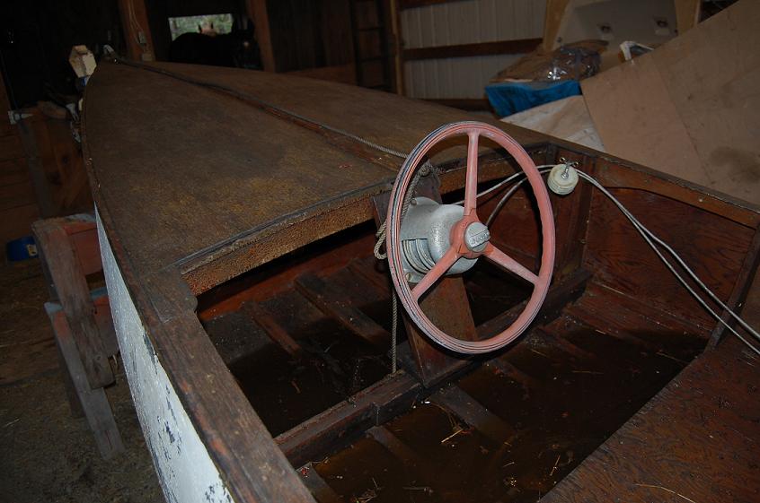

Ok so I probably shouldnt have but I got the boat... cool little thing very solid. I just vacumed out all the water from todays rain, it was full of old corn cobs from the barn it came out of that the fellow i got it from pulled it out of. Well here are some pictures. If any one has some leads as to find its history the number on the hull is 36-B and the number stamped on the transom is 0503.

So the plate says 1969 last time the trailer was on the road. Does anyone know if these would have registrations? If not is there a way to get one for a classic barn find? The boat is 13 foot long and 4'3" wide at the transom.

Re:mid 40's Hydro plane? For sale down the road. 15 years 2 months ago #31448
That is an old D-Utility, going by the dimensions. Styling is typical of the early 1950s. Could have been raced with a Mercury KG9H or Mark 40H. Maybe even a Mark 55H if it was still raced in the later 1950s. All were 40-cubic inch racing motors for APBA Class D.
The guys over at Scream and Fly's History Forum might have an idea of who's boat it was. I'd love to find one of my Dad's old boats. His numbers were 12-P, 12-N, 112-P, 112-N (also my number), and 222-N. The ones he built also had a stenciled "Smith-Built" on the deck.
The boat in the picture is one he raced in the mid-1960s and we know where this one is - in the Antique Boat Museum collection. It is a Sid-Craft "Hornet". Also a D-Utility, although my Dad raced it in 36-Class with a Johnrude 36-cubic inch 1956 30hp.

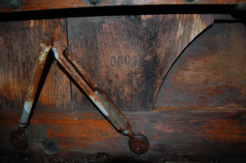

Random Question... What would these turn buckles have been used for?
Thanks
Re:mid 40's Hydro plane? For sale down the road. 15 years 2 months ago #31537
  • Split
  • Split's Avatar
  • Posts: 864
  • Karma: 32
S: CONGRATS on the racer. Looks like your turn buckels are on the INSIDe of the transom. (?) Should be a way to HOLD DOWN the high performance outboard motor on the transom during a race. & not vibrate loosen up & fly off the back of boat.

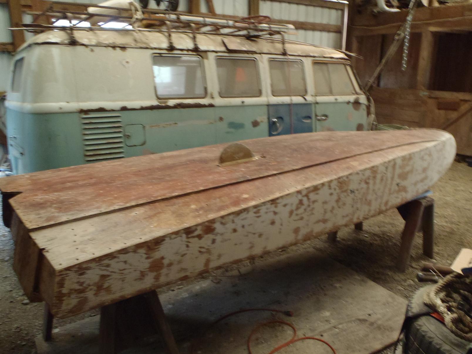

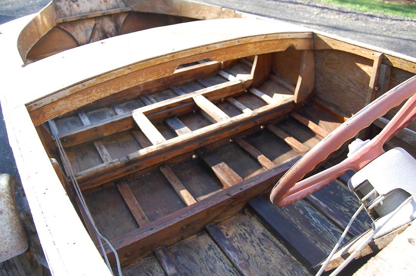

Re:mid 40's Hydro plane? Progress 15 years 1 month ago #32201
  • stashm2
  • stashm2's Avatar Topic Author
  • Posts: 666
  • Karma: 25

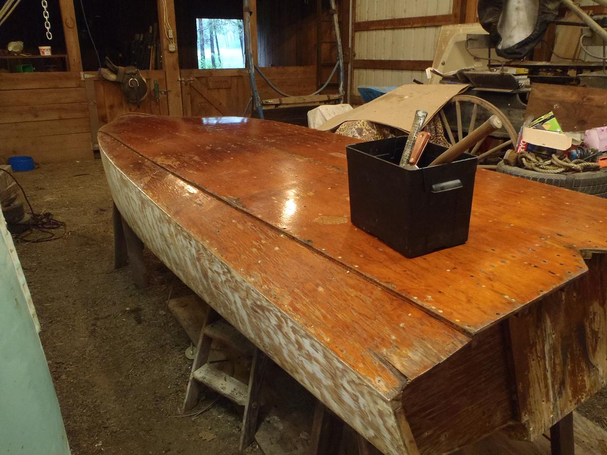

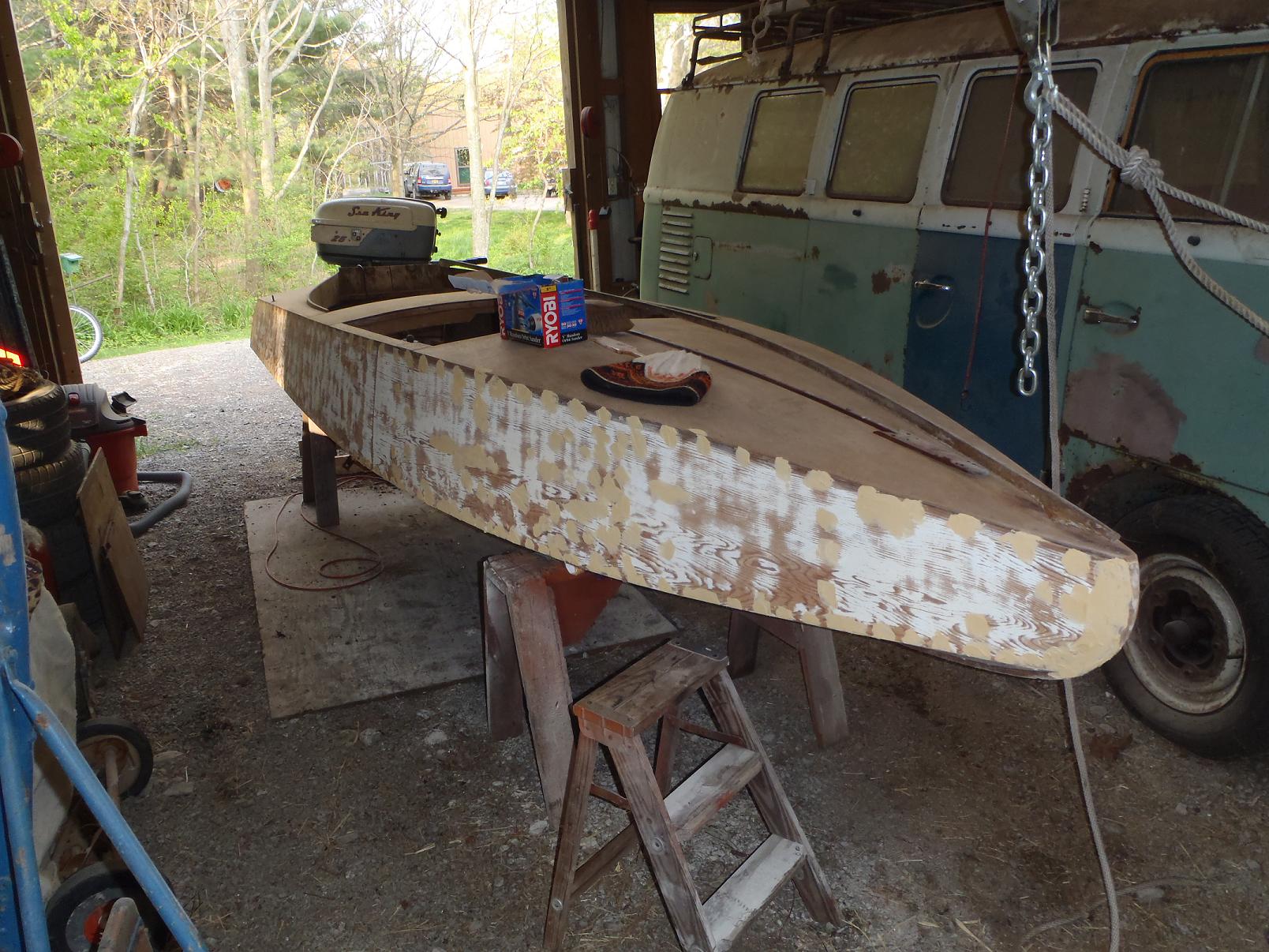

Well I have been working on sanding patching and replacing parts here all week. Going to just throw some pictues up of what I have done... May take a while today low cell signal for the internet... so check back. Heres some pictures after cleaning and draining the inside of water and.. corn.. and dust... and mouse nests..
Re:mid 40's Hydro plane? Progress 15 years 1 month ago #32206
  • stashm2
  • Posts: 666
  • Karma: 25
Here a some pics of Patching and some of flipping it over to work on the bottom.. it certainly is a flat bottom boat!

Cool, that's going to be a great project. She looks to be in pretty good shape overall. Sanding paint and varnish and she'll look awesome. Keep up the good work.

Don't know if your being facecious but point being, there's no major rot inside or out, she's completely intact, so it's mostly cosmetics. So for most wood boats getting one in that condition is a score in my book.

Good morning, No its in great shape there are a few things that needed replacing and I will have to do a careful.. grafting... on the exterior transom boards.. cant see a good way to take it out without dis assembly of the entire stern but the drain hole rotted about 3 inches off the bottom the inner and ply transom parts are fine.. so its just the outside should come out ok though.

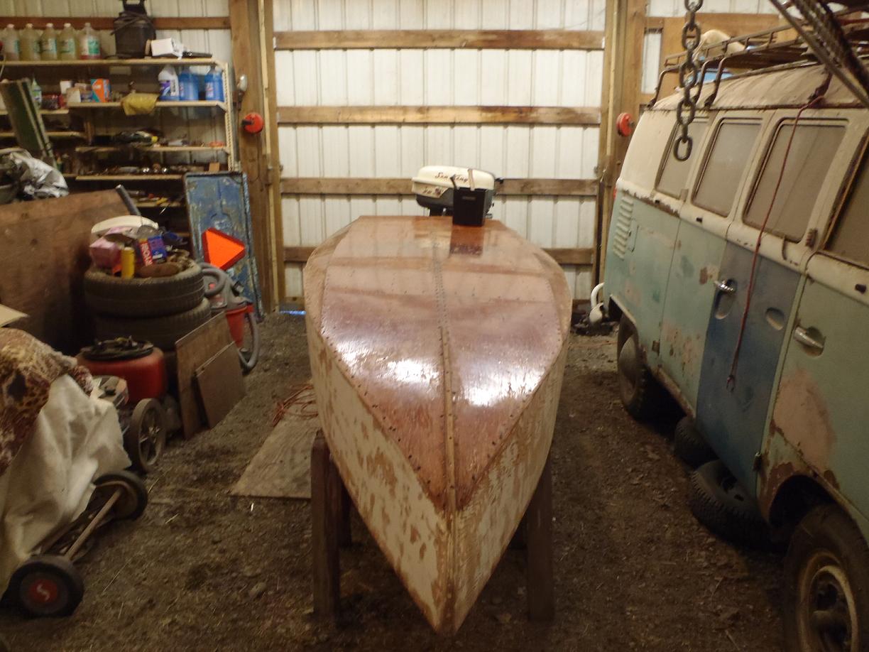

Took some time to just clean the bottom. I wonder if the whole thing looked like this when it was taken out of the barn, what a shame!

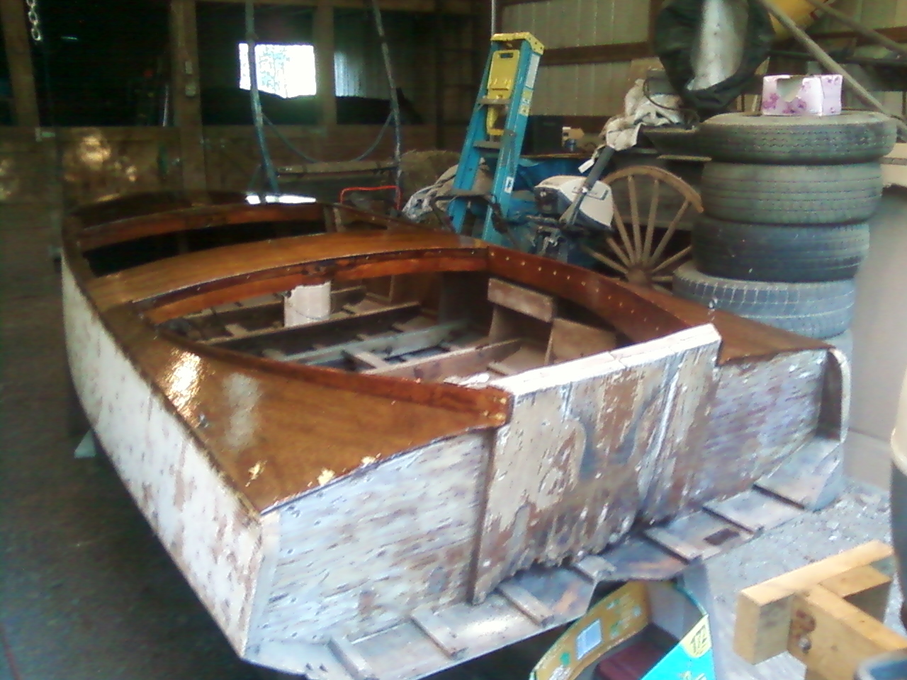

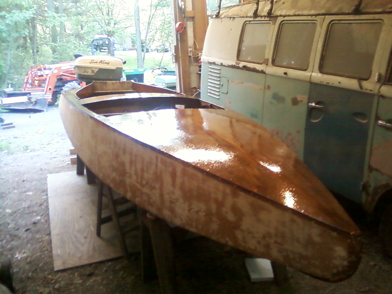

Just a little progress here. I chose not to re-do the whole transom just do a "Dutchman" to the bottom sections on the outside layer it is very solid within, But had been cut down from its original height to fit a short shaft engine. I will be runing my sea king 25 on it I thinkn so it will work well with that engine. If I Feel more ambitious at some point I will disasemble the stern and raise the transom to the original height.
well heres a bad picture with some polly on it.

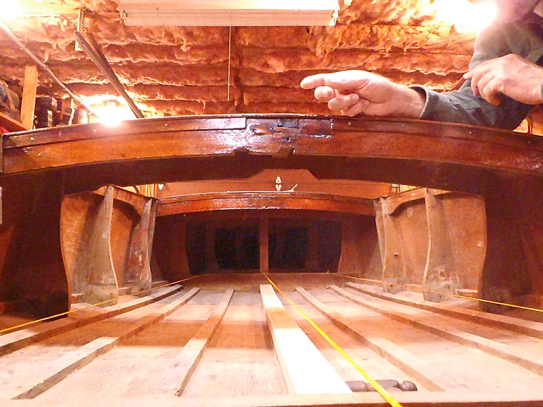

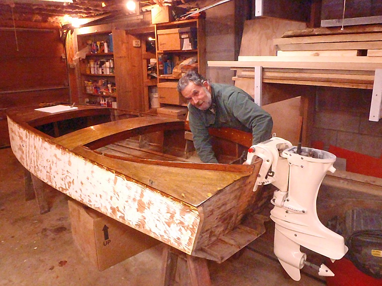

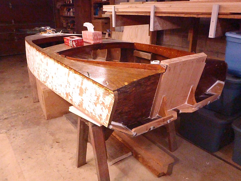

So its only been seven months since we started to work on the old Hydro, I have been working on the engine as most of you know... and my father (Gerry) has been working on the boat. So here are some pictures of what he has done .. A little heavy on the 3M5200.... I will let him fill in what's going on in these pictures. Well here they are.
Jesse

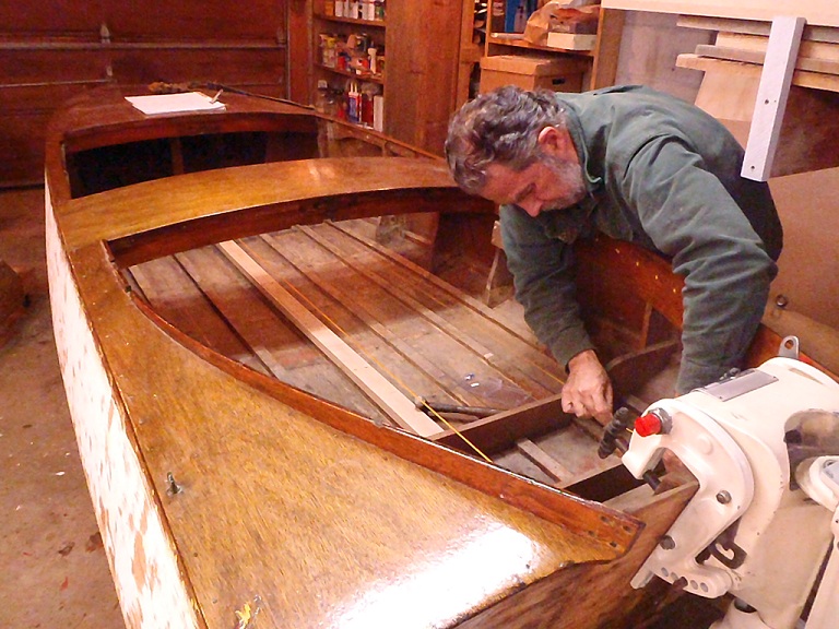

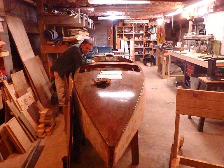

Hi: I'm Gerry, Jesse's Dad. I have been around boats since I was an infant, and owned a 12 foot PenYan runabout when I was a teen. This is my first wooden boat project since then.
Here is "Little Dipper" in our workshop.

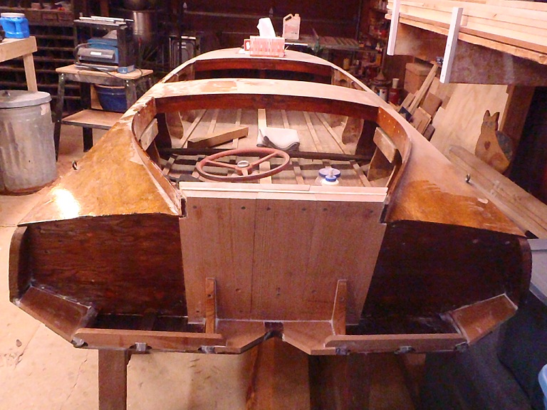

The lower frame members (numbers 4 through 9)were deteriorated. The boat had sat outside through a NYS winter, and the accumulated debris was hard on the spruce boards.I intended to make patterns, but there wasn't much left! White oak will be used here.
We tested the engine hieght by temporarily mounting the engine bracket to the transom. Jesse was satisfied that the Mercury cooling inlet would be submerged at speed.
We decided to use white oak for the new transom inner and outer boards. I eliminated the old drain holes, which were bored through the stern with cork plugs.
The various pieces of the stern were used as patterns and duplicated. Stainless steel fasteners were used to replace the steel ones we removed. The 3M #5200 bedding compound was used liberally. Jesse and I had "differences" about the resulting white lines at joints. I am concerned about water infiltration and maintaining flexibility...Jesse is going for the appearance.
We added a wooden brace between the keel and transom. This won't interfere with the rear floor or the engine, but should add a lot to the rigidity of the stern. This will be bedded and fastened with stainless steel screws through the transom, floor/keel and last frame.
There is a bit of fairing and sanding to do.
Jesse has located a steering bar and proper pulleys for the boat.
