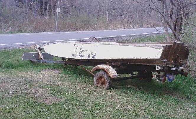

This is for sale around the corner... so to speak all wood, mid 40's been in a barn for 30 years aside from the winter its sat out.. been eyeing this. However i have too many projects as is. They want 600 for it no idea about registrations ect... cool though.. maybe... 14 feet if that..

Grab it and hang onto it if you can.
Looks like it may have a neat history.
May be able to track the #.

I'm with Neil. that looks too cool to let go. It would look great with a Tower of Power on it.

It would need to be a short stack... probably 50 would be too much for that little guy. 18 or 20 would do more than enough. Its cool though.

STASH: Good Catch.. Great to know my old area , TROY , has a few gem[s left. Any more top pics.?? The bow & white sides has a 1st look of a RAVEAU,! Which would be a great score. Did you get history from owner.?? Could be mid 50's.?? This pic is of the reproductions that were offer by Bob W. Brian S, Crosby-boat would know the design, but history here COULD be more valuable than soft wood condition. . I had pulled a De-Silva out of a barn in Poughkeepsie, so all that area was RICH in activity from mid 40's with the famous ALBANY- New York City marathon racing. ..Side # of 36-N..?? ChineWalker would know...Could be SPEED-LINER..?

I am going to stop by latter tonight and make an offer I think, I just dont need another project I think it would clean up easily though. And would fly with my 1955 Johnson 25.... . But it is from the Southern Albany area as best I can tell this one is up in Berne NY. I will keep you posted.
Re:mid 40's Hydro plane? For sale down the road. 15 years 2 months ago #31353
I'd certainly grab it. If it is indeed 13-14 foot, a 25hp Big Twin Johnrude would be a nice set-up, ala the old 36 Class. Looks like someone moved the steering wheel into the fore cockpit. If you want to live, move it back to the rear cockpit!!
See if it has any hardware. The deadman throttles are nice finds!
If you can grab it before Saturday, drag it down to East Sidney Dam, near Unadilla, just off I-88 and you might be able to resell it, if it's not something you are interested in personally. The AOMCI, NYS Chapter is hosting a swap/wet meet at the Recreation Area at East Sidney Dam all day Saturday. Even if you want to keep it, the meet might be a good place to find out more about it, as there'll be some ex-racers there...

I will look into it more, I didnt notice a dead man throttle but it may be there, Planning to look closer tonight.

Ok so I probably shouldnt have but I got the boat... cool little thing very solid. I just vacumed out all the water from todays rain, it was full of old corn cobs from the barn it came out of that the fellow i got it from pulled it out of. Well here are some pictures. If any one has some leads as to find its history the number on the hull is 36-B and the number stamped on the transom is 0503.

So the plate says 1969 last time the trailer was on the road. Does anyone know if these would have registrations? If not is there a way to get one for a classic barn find? The boat is 13 foot long and 4'3" wide at the transom.

That is an old D-Utility, going by the dimensions. Styling is typical of the early 1950s. Could have been raced with a Mercury KG9H or Mark 40H. Maybe even a Mark 55H if it was still raced in the later 1950s. All were 40-cubic inch racing motors for APBA Class D.
The guys over at Scream and Fly's History Forum might have an idea of who's boat it was. I'd love to find one of my Dad's old boats. His numbers were 12-P, 12-N, 112-P, 112-N (also my number), and 222-N. The ones he built also had a stenciled "Smith-Built" on the deck.
The boat in the picture is one he raced in the mid-1960s and we know where this one is - in the Antique Boat Museum collection. It is a Sid-Craft "Hornet". Also a D-Utility, although my Dad raced it in 36-Class with a Johnrude 36-cubic inch 1956 30hp.
