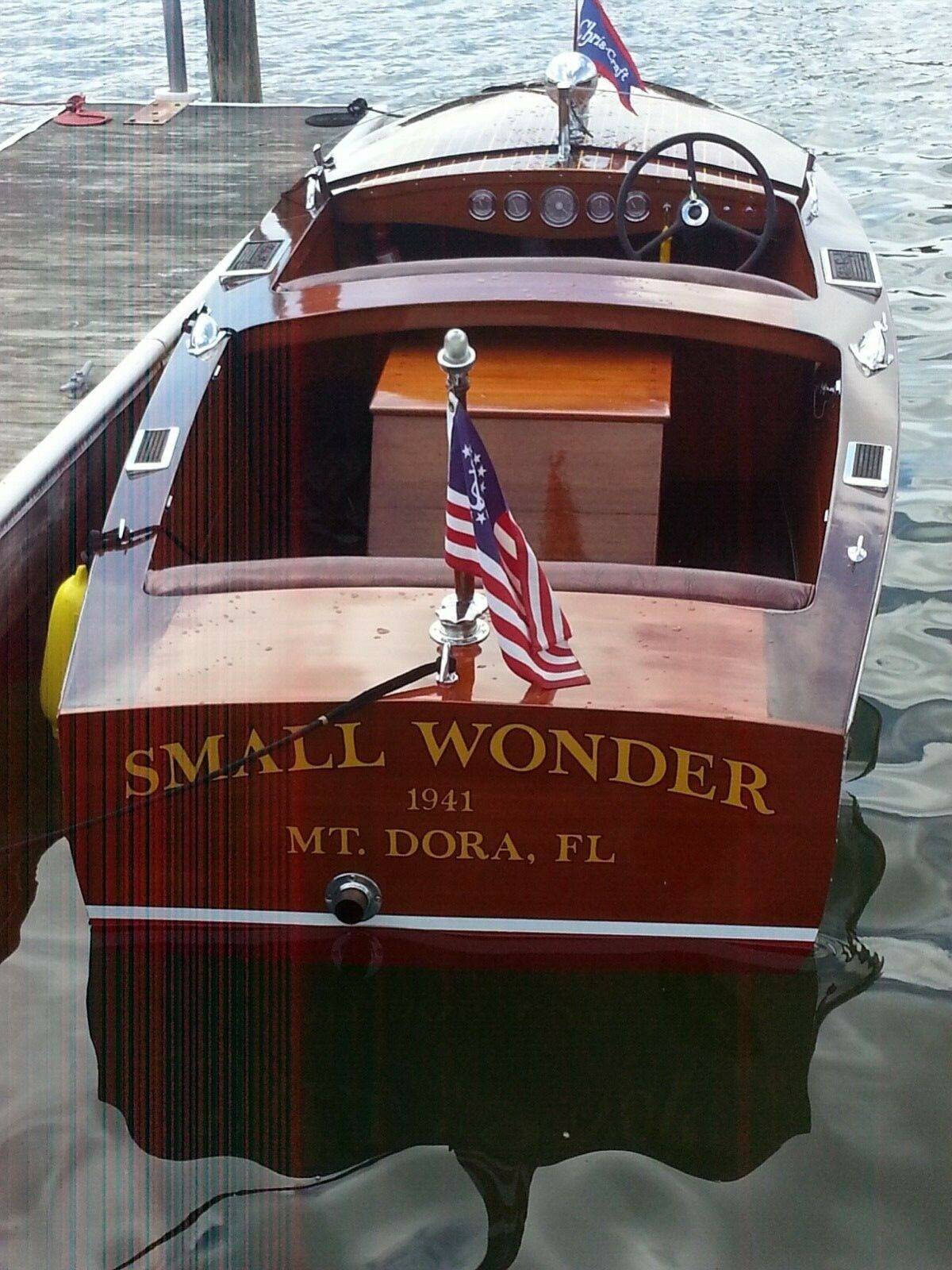

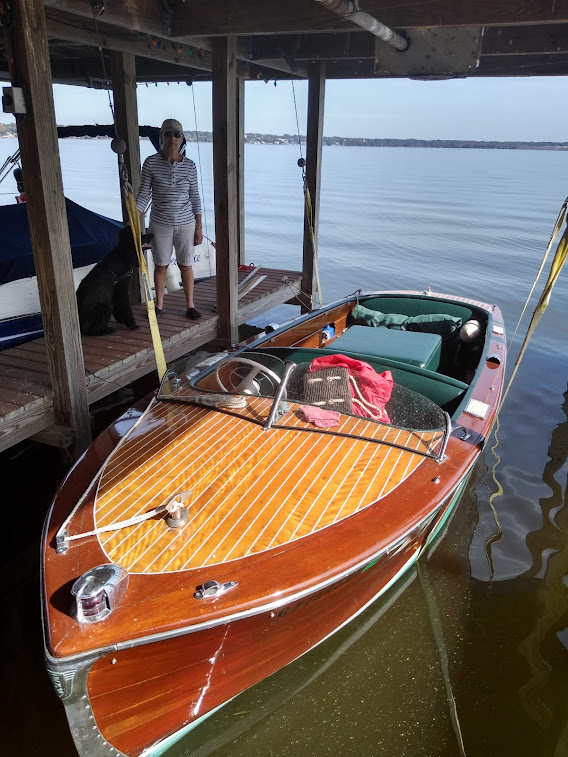

I bought myself a little 1941 Chris Craft runabout. I figured it was way past time to own a wooden boat that actually runs! It's turn-key, a show winner and needs nothing! Should be a lot of fun. I pick it up at the show in Mt. Dora next month. Maybe I should stuff a big block Chevy in her. (?)

Beautiful...
What's it powered by currently?
Why change it?

Jan, sorry late to this was out of town. She looks awesome!!! Can't wait to see her in person!
Lenny, yes you have to swell them, unless it has what's known as a "dry bottom" installed.

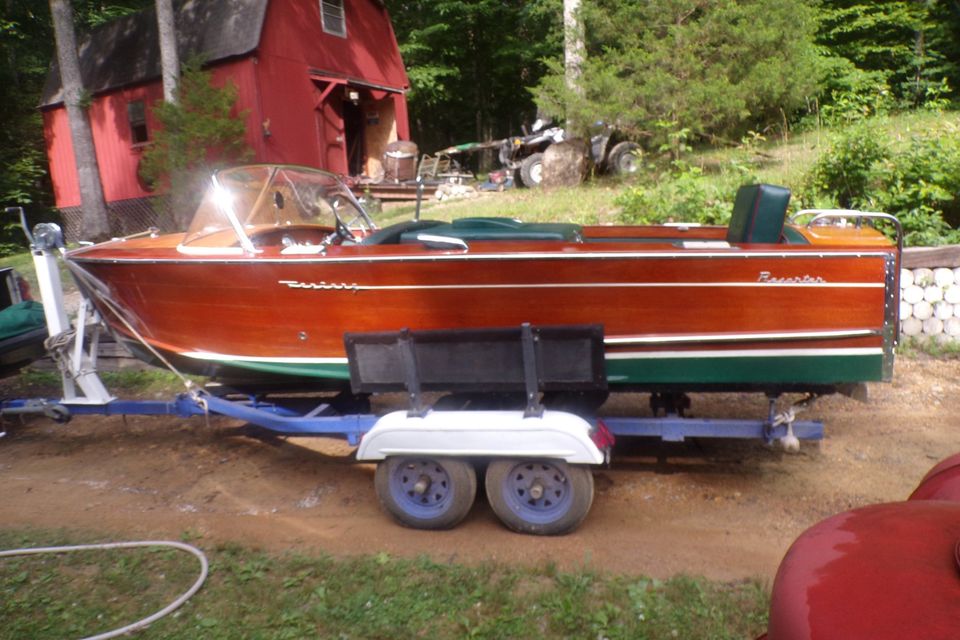

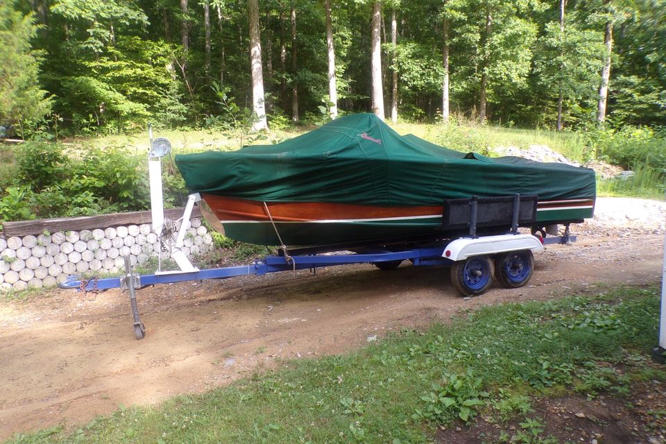

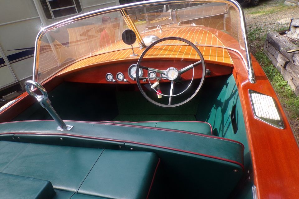

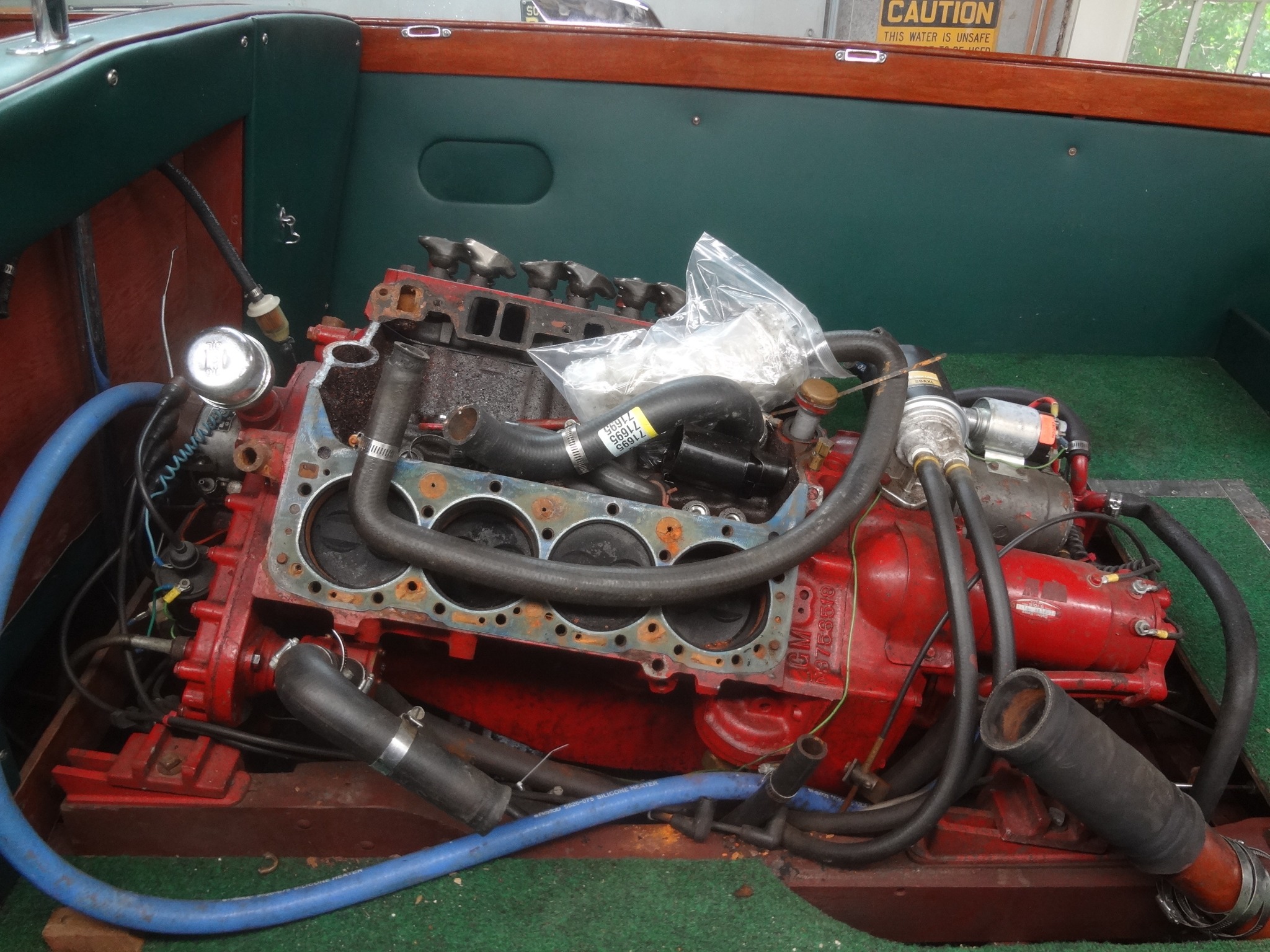

...and ANOTHER one: 1959 Century Resorter, beautiful inside and out but with a cracked block, 283 Chevy...got it cheap. It's kind of a rare bird...has a factory original gas pedal. I just happen to have a new high performance 350 sitting on a cradle in the shop. "Chance favors the prepared mind."

That is beautiful! Do you have to do anything other than engine work?

No...just pull out the old and drop in the new.

Nice score! Congratulations.

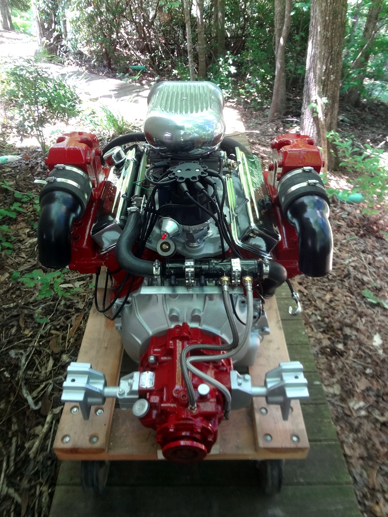

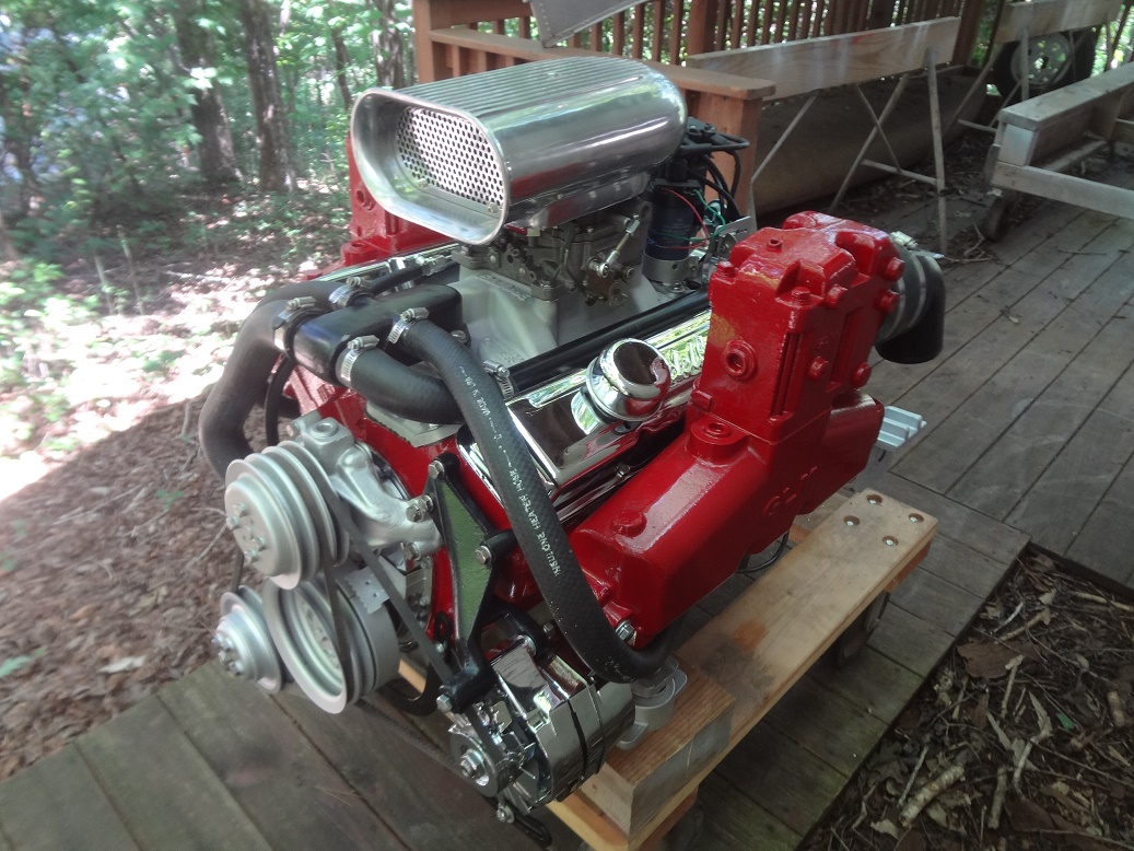

Finally finished the new 350 engine with GT heads for the '59 Resorter. It should be a serious increase in performance.
Here's what I bought:
Here's the 350:

Wow....that does look like a serious piece of 'kit'.
Will you keep the tunnel ram intake or go with something lower profile?
What is the rpm operating range?

Nice!!! Well that definitely isn't going to fit under the "dog house"! LOL

I'll have to get rid of the air scoop with the built-in flame arrestor...but it does look good! The operating range is right around 4,600 RPM. I'll be turning a 13X14 wheel.

Agreed the scoop looks awesome but alas it won't fit. The 4600 sounds about right. I think mine will be somewhere around there. Not sure on the prop yet. Was thinking of calling ACME and see what they suggest.

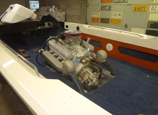

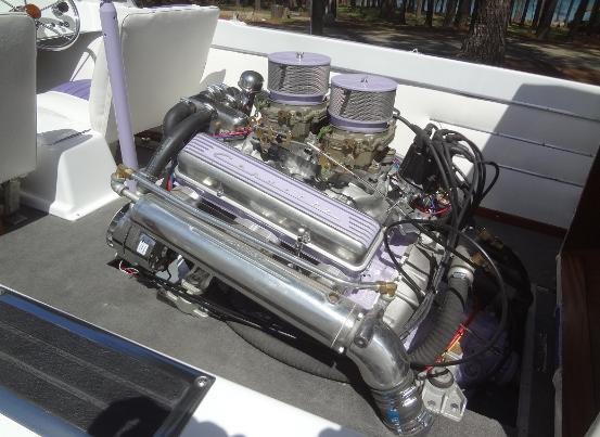

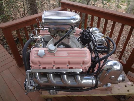

I'll be using two Edelbrock #1409s, 600 CFM...my go-to carb for V8s. Here's one I built a few years ago.

That's really cool. The Corvette valve covers are timeless.
Tell me more about the exhaust manifolds. Are they custom? How the the water cooling work?

I can't read the name on them but I believe they are vintage Edelbrock manifolds. The one I'm building now will be using vintage Nicson manifolds. These types of vintage aluminum manifolds for a small block Chevys are getting harder to find but I have an Ebay search saved for them. You can find them easily for big blocks and Oldsmobiles but the small blocks are really scarce and they need to be good ones...even harder to locate.
These types of manifolds have two 3/8" female pipe openings in the front. The water goes in at the lower fitting, fills the manifold and exits through the top fitting which is then plumbed (in this case with 5/8" aluminum tubing) to the exit fitting and out the exhaust.
They were made by Glenwood, Nicson, Edelbrock and Hardin...probably some others as well. They're not cheap but generally can be had for the cost of new cast iron manifolds with risers.

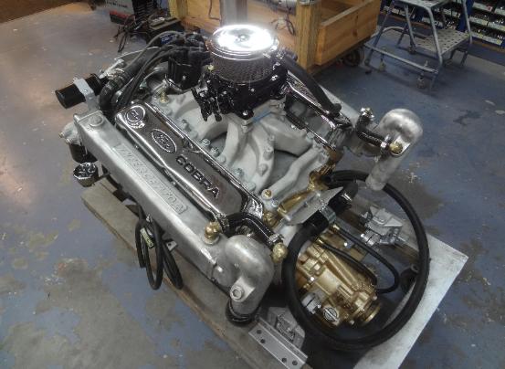

Ford 351W with old Interceptor exhaust manifolds:

Thanks for the information and pictures. I'm accustomed to the hulking cast iron manifolds. I did a quick search to find some more information. There's a site called 2040-parts.com you might consider giving a look. There are some SBC Edelbrock pieces you might find interesting and at a good value.

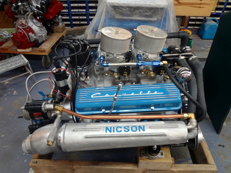

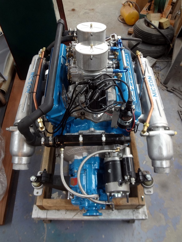

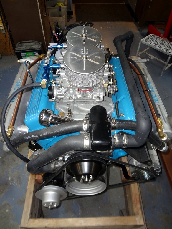

Engine for the 1954 Chris Craft Riviera is finished...2x4 Edelbrocks, GT heads, Pertronix distributor/coil, Nicson aluminum manifolds, lots of other performance goodies.

Beautiful!! I love the hard plumbing and the corvette style valve covers. With the ignition upgrade should make that pretty reliable.
