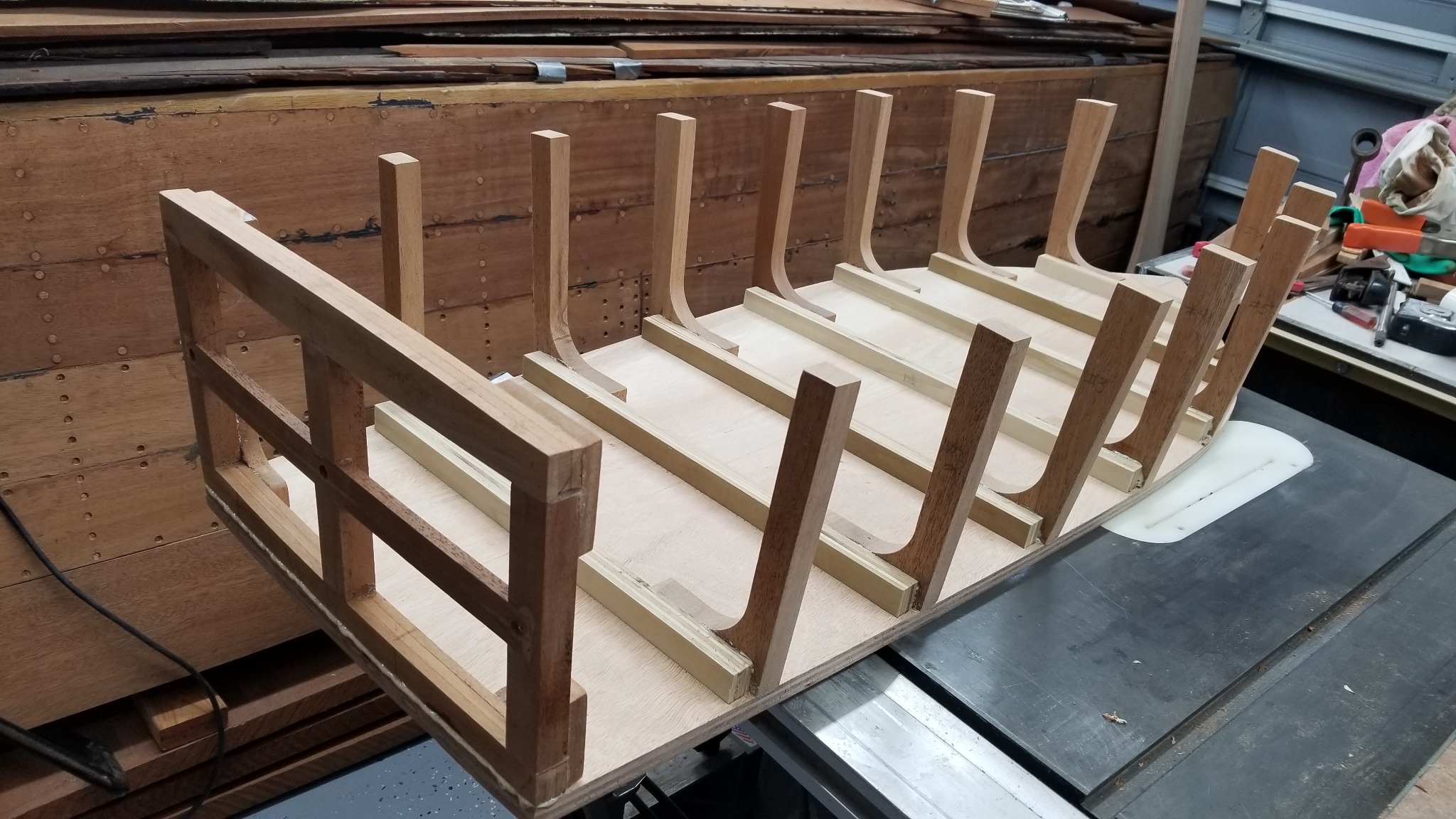

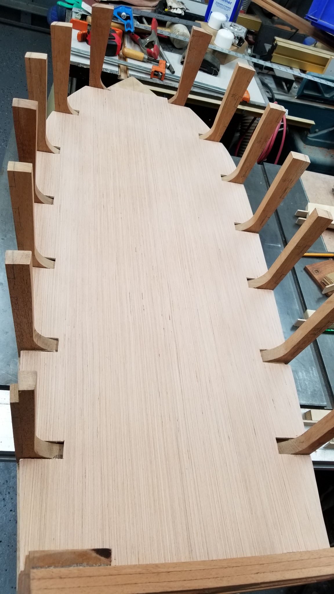

So I opened my big mouth and said my grand daughter should have a woody boat wagon from the wood on Papa's old Resorter I'm restoring.......I have until May! Now that I have the battens in with 5200 I'm not guppy with it, the sides don't arch out enough. She won't know the difference. But I will everything I look at it . LoL. It's basically a 1/4 scale version of a 16' Century Resorter. Now I need to find 1/4 scale accessories, like a bow light, windshield frame, step pads etc. lol. I guess I could find a 3d printer and print to make Ia mold and use the old screws to melt down and cast but the chroming won't be cheap and not sure I'd have it done by May.

Thanks guys. Its actually going too be a real good practice run for the full size Resorter since I'm going to finish this the same way.

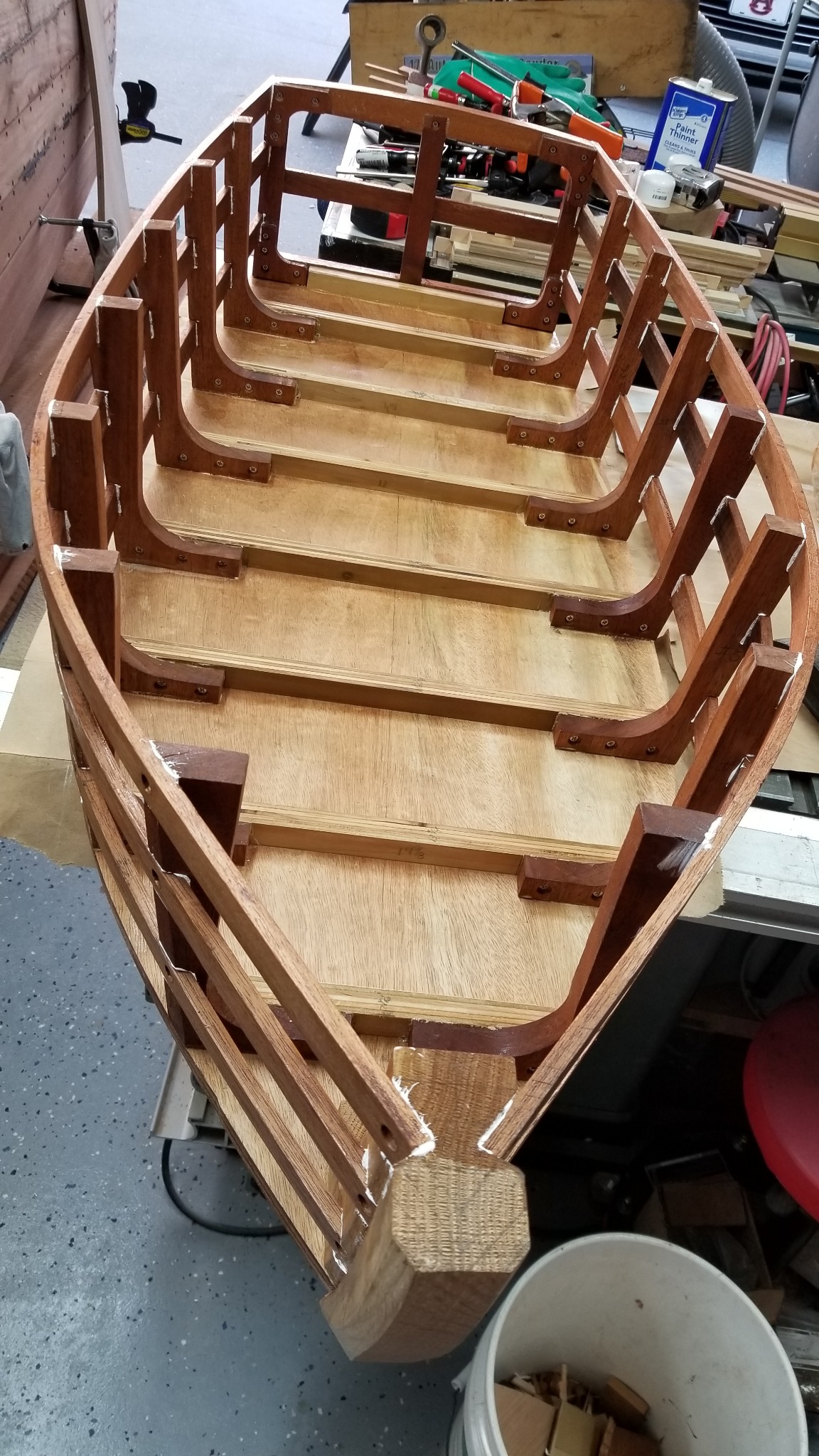

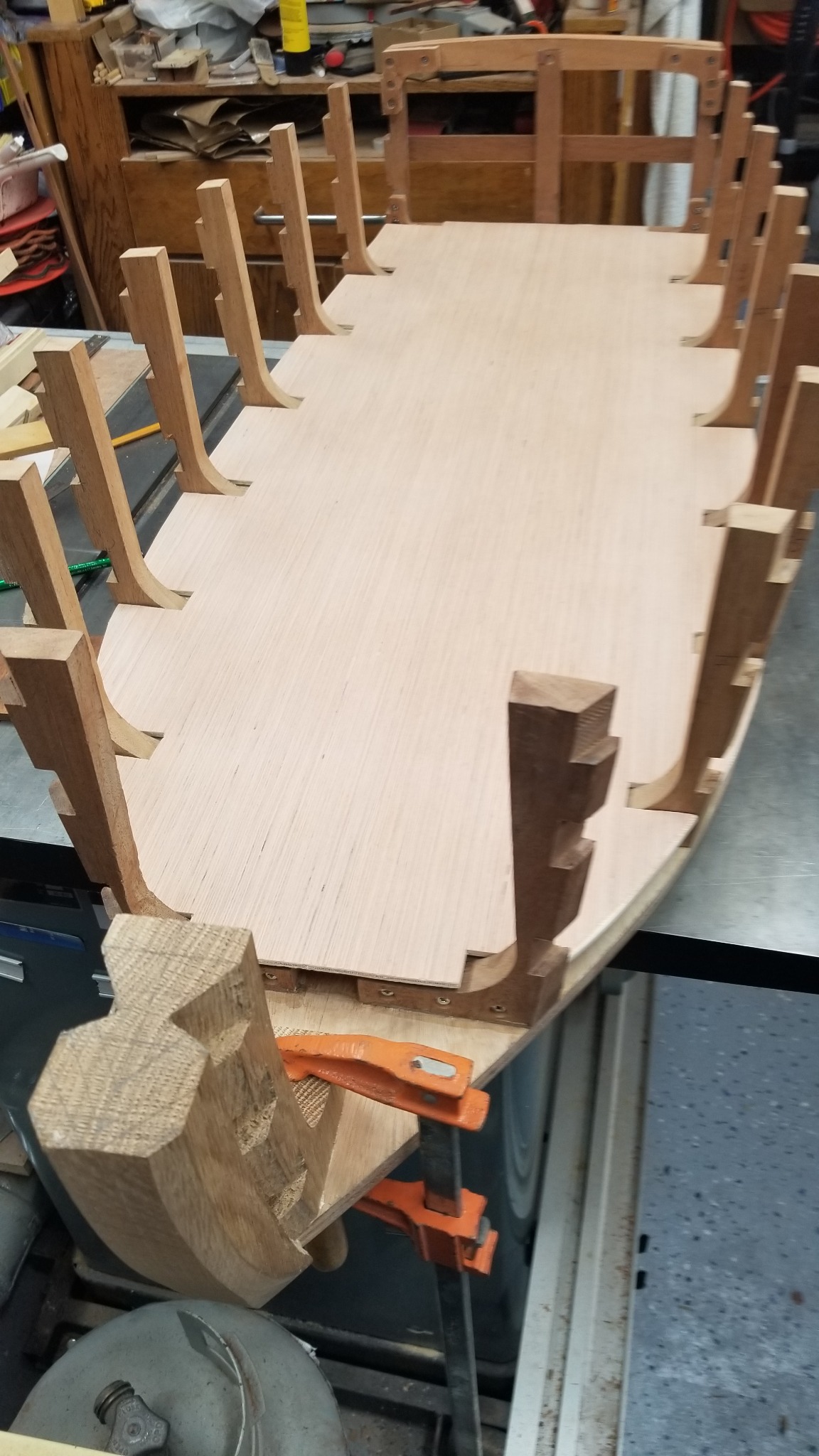

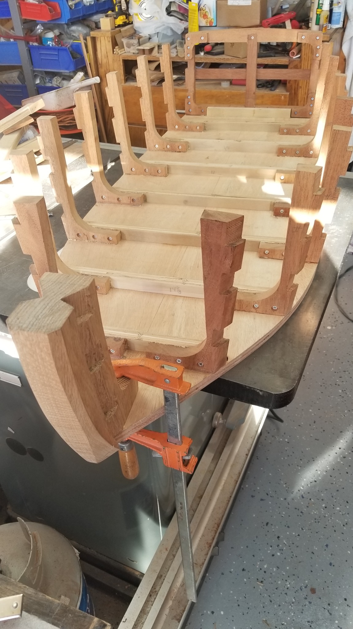

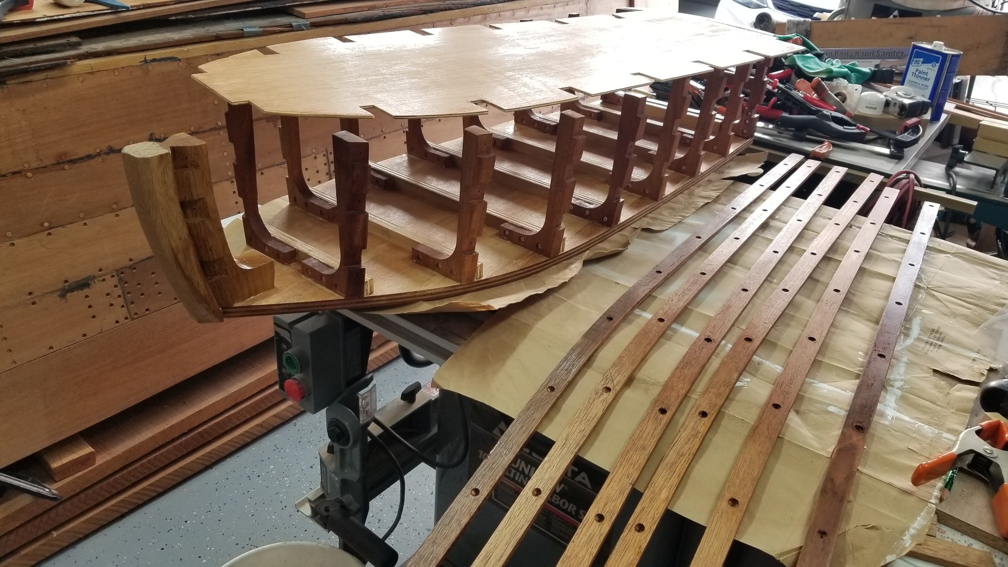

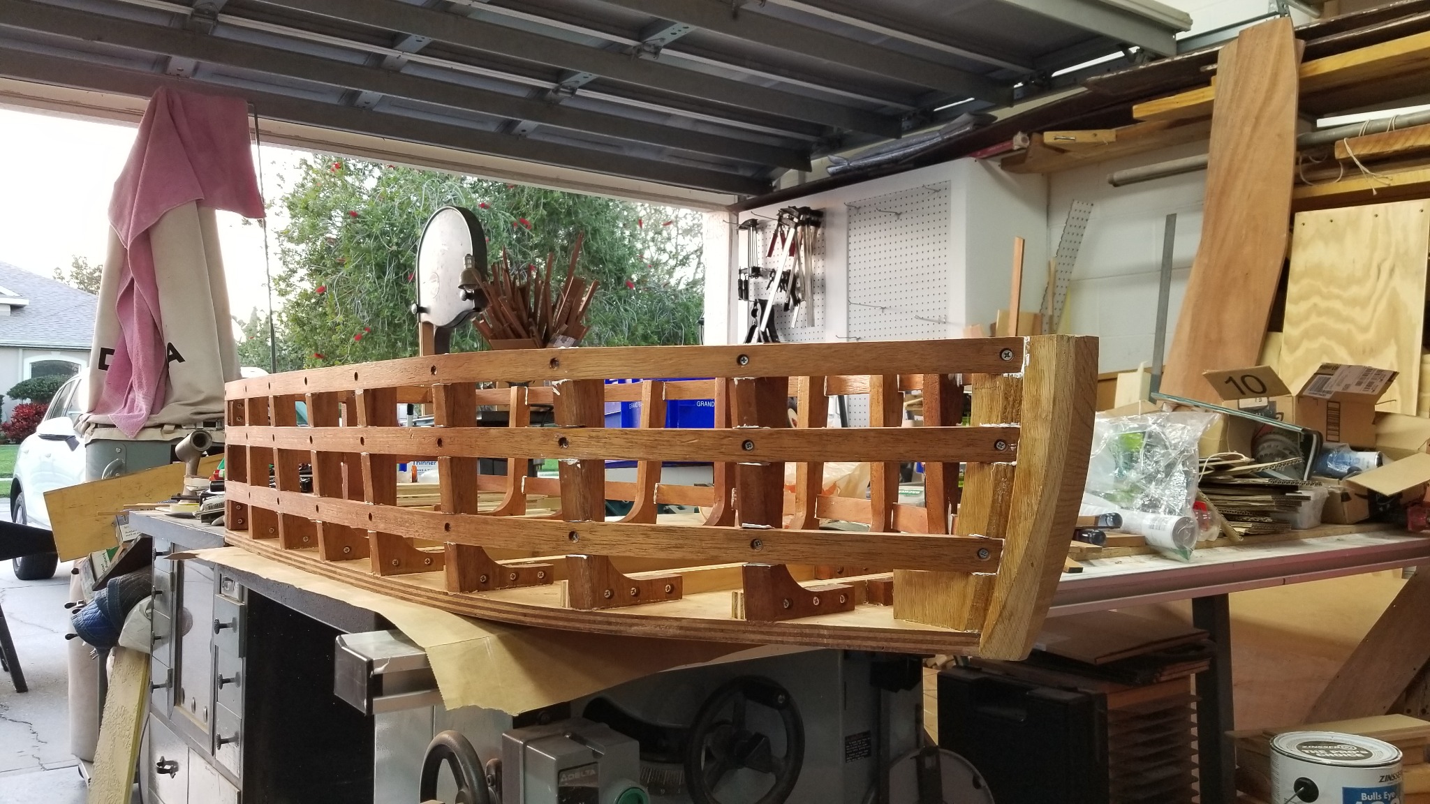

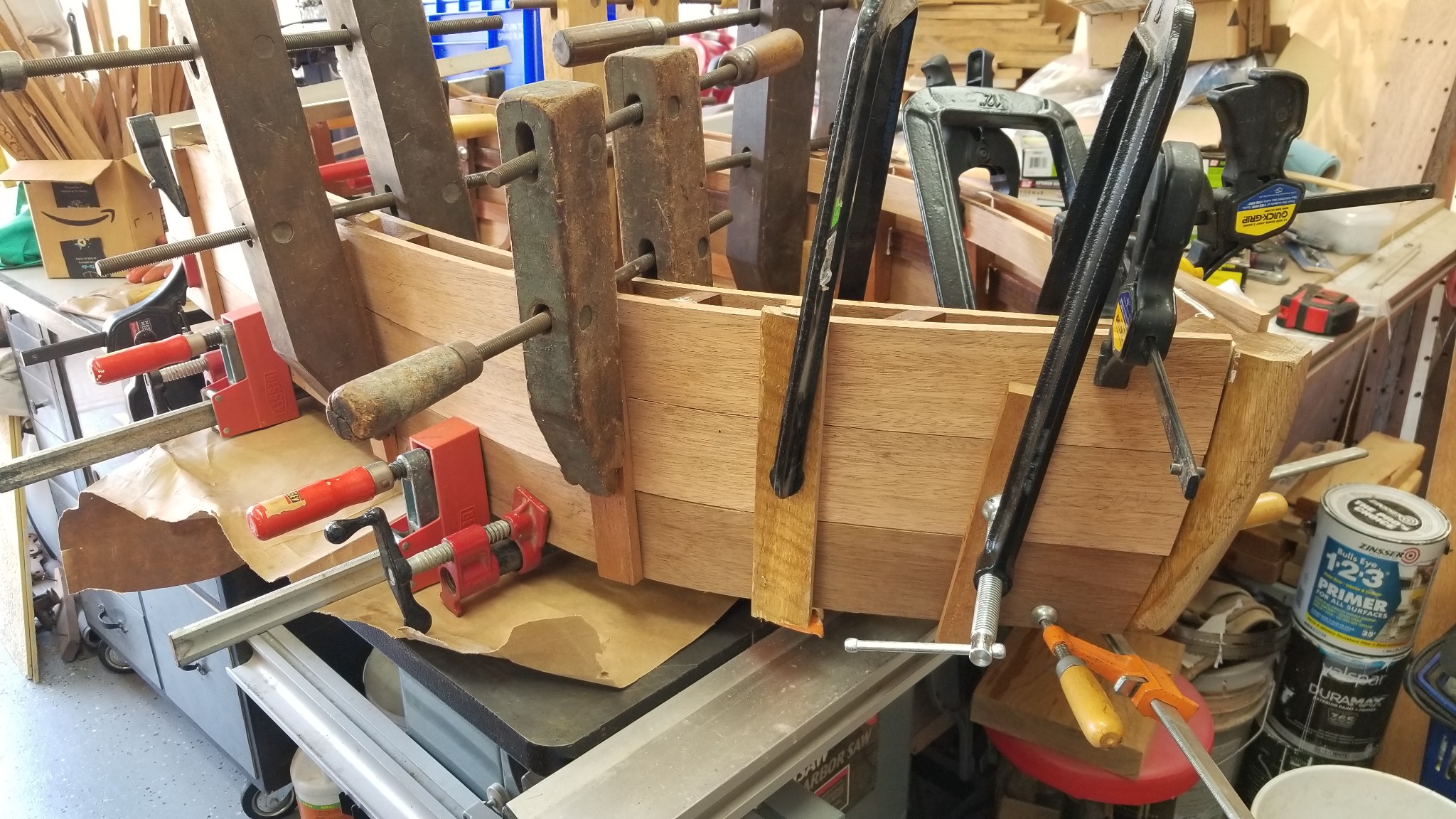

I got the side planks planed and cut to size. I also got the inner gunwale baten cut. Steamed them all today an should be ready to fit and CPES next weekend.

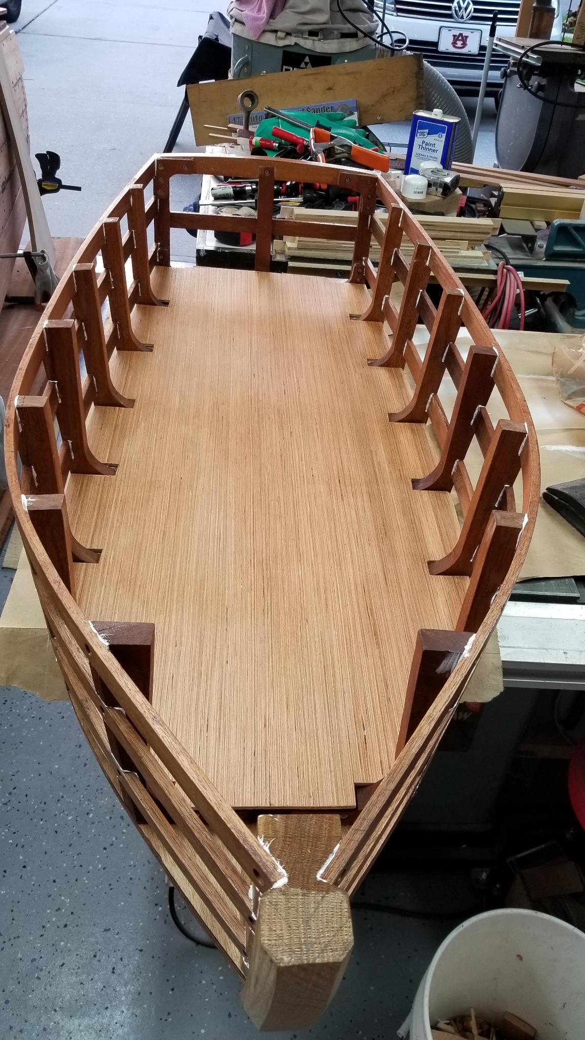

Ok so all the side planks are bedded and screwed to the battens and frames. Stem is rough shaped and will get final shaping once the 5200 is dry. Will work on transom next but has to have the 5200 dried before I can really shae the side plank ends clean to the transom frame.

Excellent work. There are going to be some excited little ones whomever gets to see it and sit in it! Hard to believe my grandpa built 4 separate boats for his family and extended family...one a year in the basement using 2 separate Brace and bit drills... one to pilot holes, the then next with a blade counter sink bit, then all hand driven brass screws every inch. Dad was in high school and would help drive screws until his palms were blistered... Grandpa worked at a steel mill since 1919 when he was 16 and he pulled hot samples with heavy tongs... by the late 30s and early 40s he had forearms like Popeye and calluses thick enough on his hands that he didnt get blisters... Dad said he could just go and go....dirt floor basement with a 5'9" ceiling a 6 foot 2 man at 250. I saw him cut his palm with a slip of a knife at about 62 and I was going to run and get grandma...he said its ok...no blood as he had not cut through the calluses yet. I used some of his tools like hand planer, rasp, and angle finder, but I skipped the egg beater drills and used power tools on my high school built boat... he was tough and patient! He would have loved your projects, Bob! I was 9 when he passed, but Dad shared his tools, his secrets, and the boating passion to get me hooked for life. I sure wish I could have built a few project with him, but 50 years at the mill took its toll...stroke 6 months after retirement and a year in bed before passing...At least he lived his boating passion along the way. I built my little 3 point hydroplane in his honor. You surely will be making lifelong memories with this project! Keep the pictures coming.

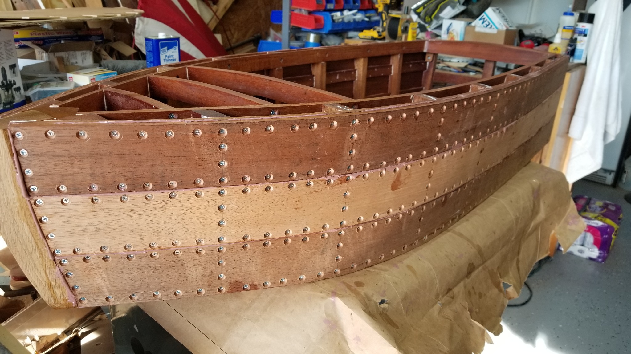

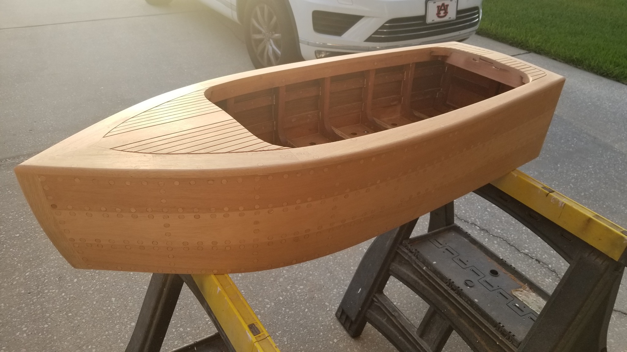

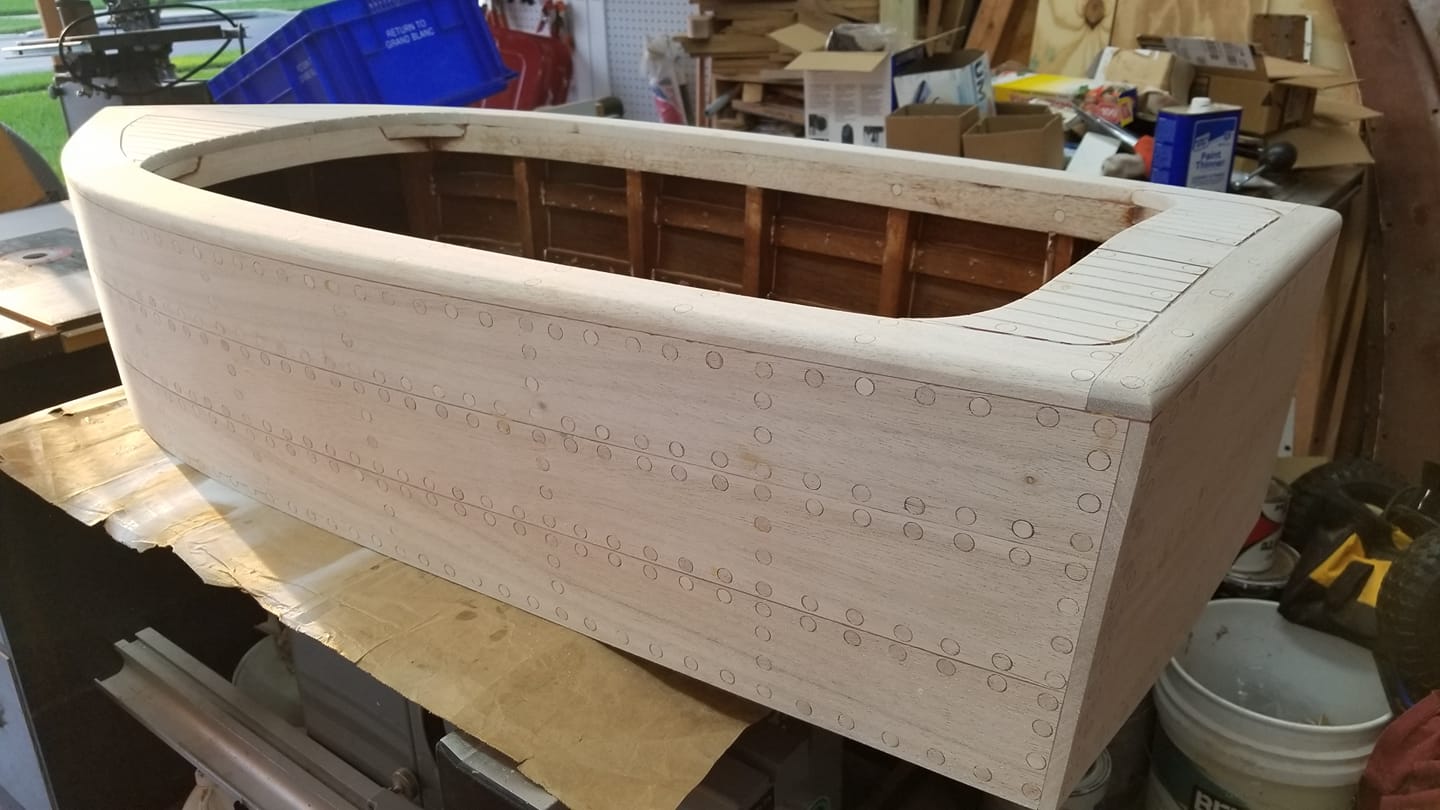

So Project Overkill aka Mini Me is about ready for bleach then staining.

What an amazing project... looks great. Also a great way to keep the woodworking skills and tools ready to get back to the big project! Built like a tank, yet fit and finished like a fine collector boat! Hope your family can keep it around 100 plus years... I still have a couple of Grandpa’s hand built wooden toys that are over 80 years old. I will be passing them down.

Thanks! Outstanding, glad you're able top keep that stuff in the family. That's what I'm hoping this will do. It's now bleached and drying, just needs the raised grain lightly sanded then stained.

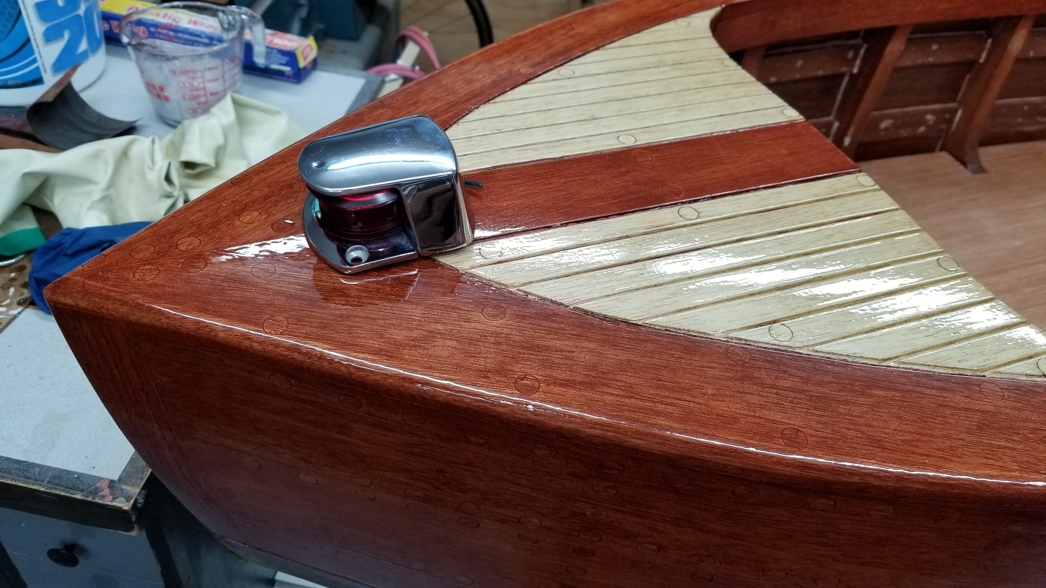

Second coat of Varnish is on but I wanted to try the light Cal sent me to see how it will look. I think it will look good, thanks Cal!!!!!!

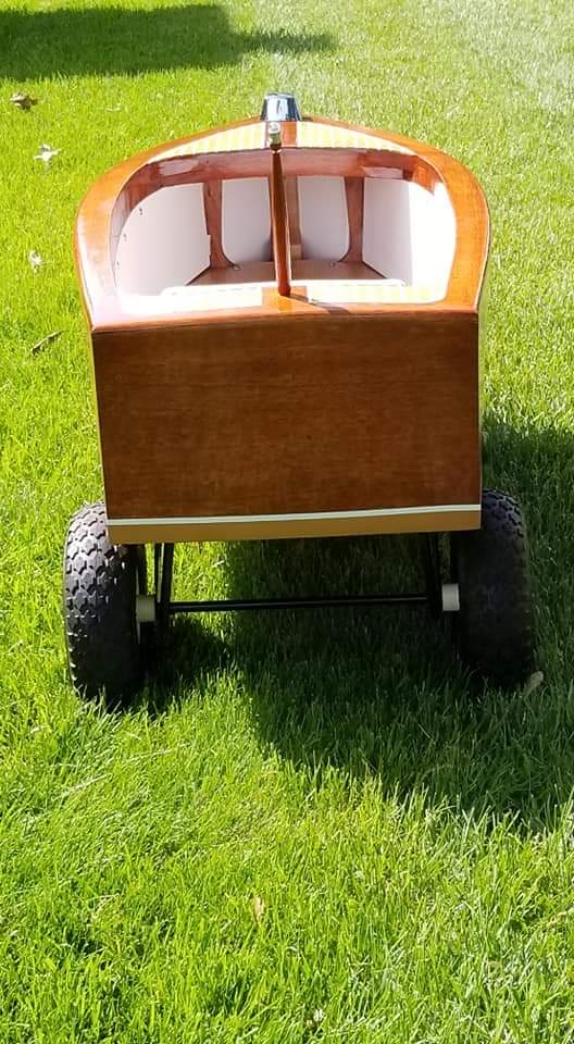

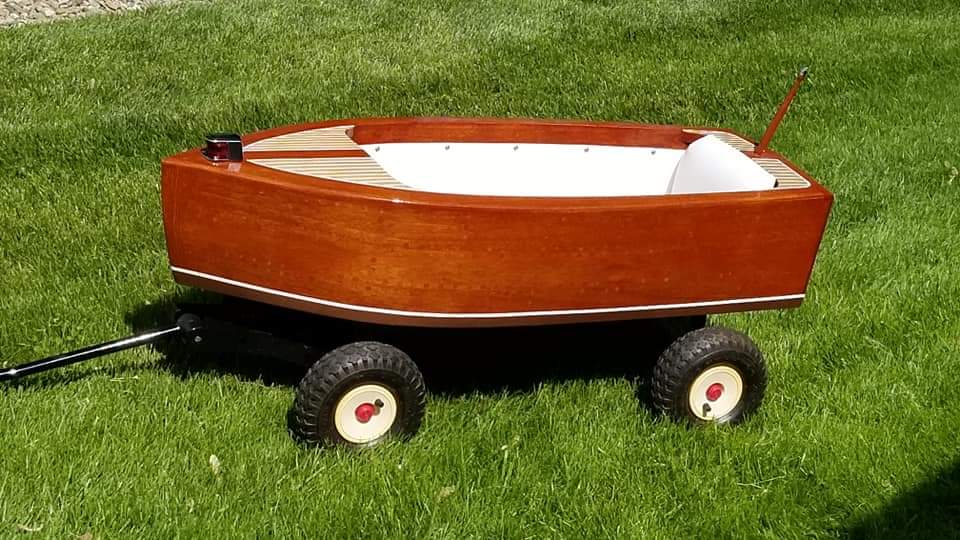

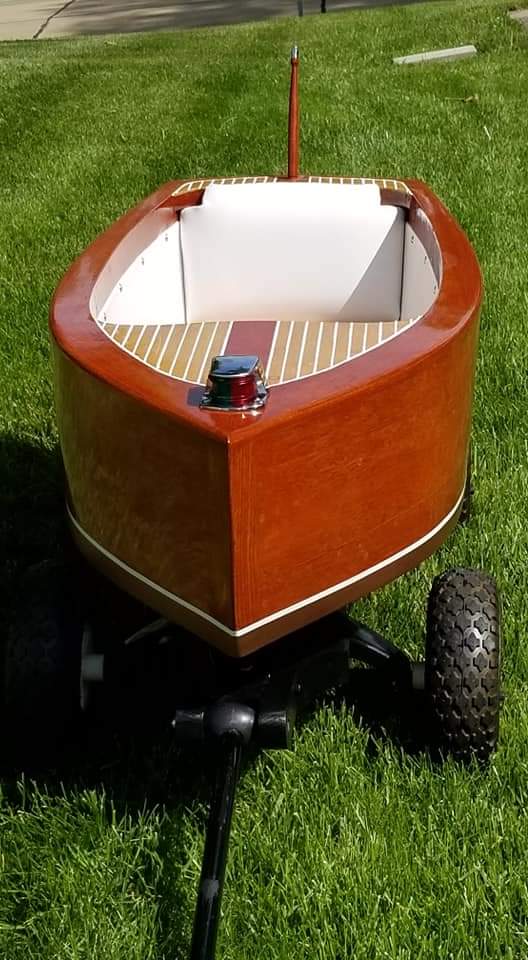

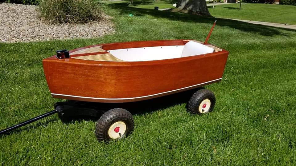

Well she's complete and delivered. Now time to get back to the real one! [attachment=56967]
1/4 scale Century Resorter 5 years 5 months ago #144551
That is so cool, makes the rest of the neighborhood jealous.
Great job.

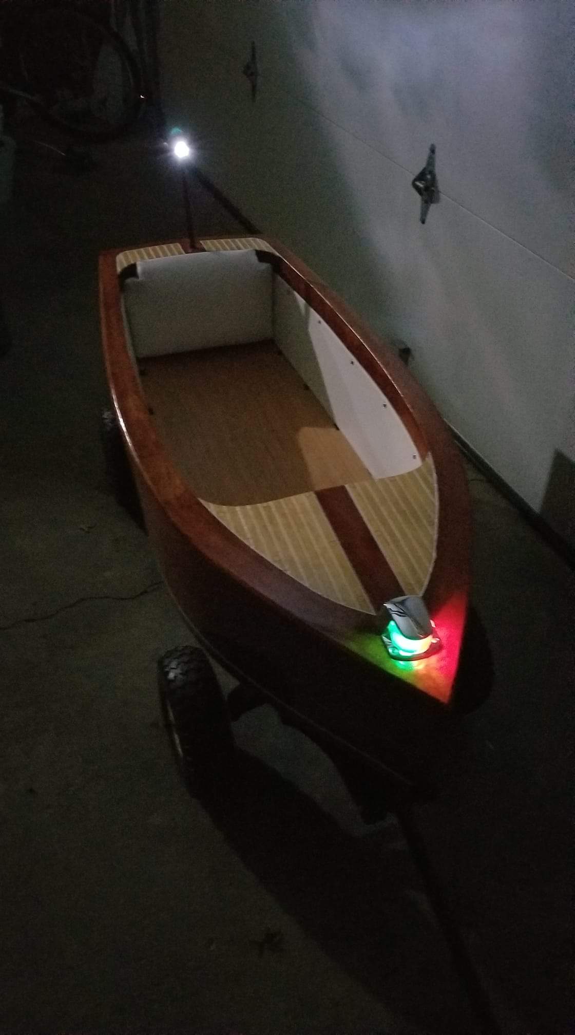

Thanks again Cal the light worked out perfect. Did a led adaption and it works great. I'll post a night pic later.

Almost forgot, the lights work too!

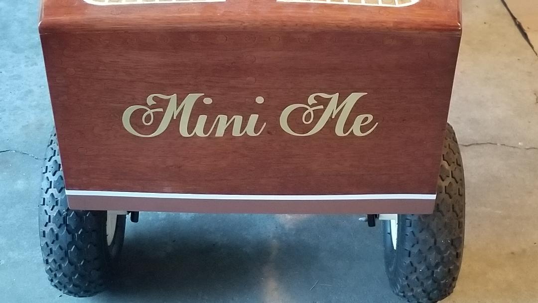

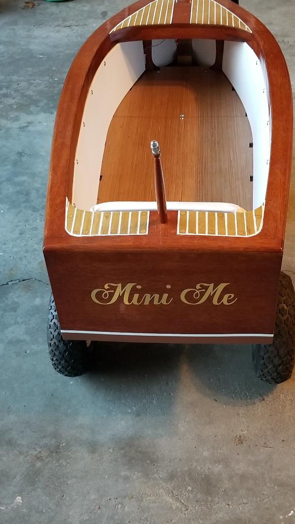

LOL, yeah I know I have to get "Mini Me" on the transom yet. My daughter had a Cricut cutter that Im going to get gold leaf vinyl latters cut and applied on the next trip up. my duaghter is also going to come up with a flag for the anchor light staff. I know it needs a burgee up front but the bow light doesn't have a mast hole unfortunately. I thought about wheel and windshield etc. I may still work some "additons" for it. ;)

Sorry forgot to post the transom pics, with the lettering.
