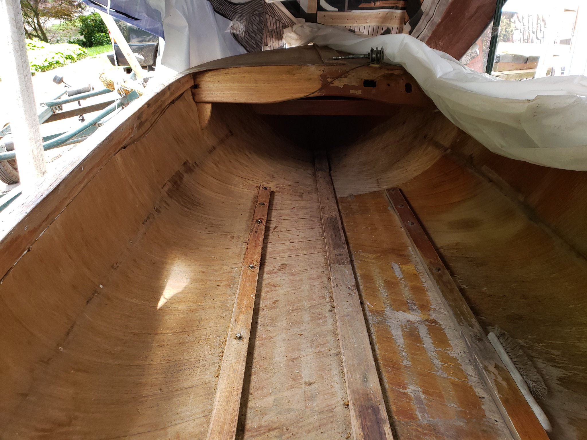

whirlwind 1961 my next project 6 years 5 months ago #142276
getting started on stripping it
any suggestions about the next steps im doing some research

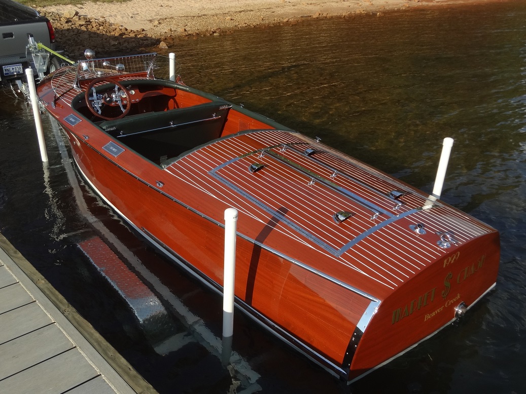

I use the same Interlux Chris Craft stain. I thin it with regular mineral spirits until it "looks right" to me...about like heavy cream. I put it on with clean shop rags, let it sit there for maybe five minutes and then wipe off as much as will come off. In a sealed container, it will keep almost indefinitely, certainly weeks. I don't like the "solid" staining technique where most of the grain is completely hidden.

whirlwind 1961 my next project 6 years 5 months ago #142504

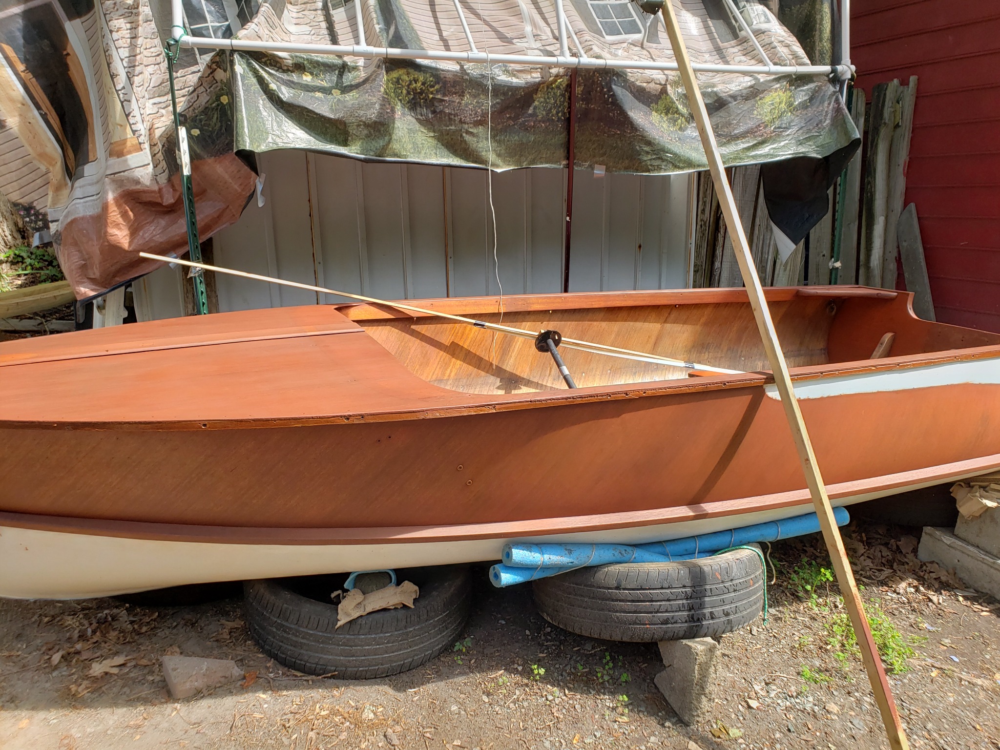

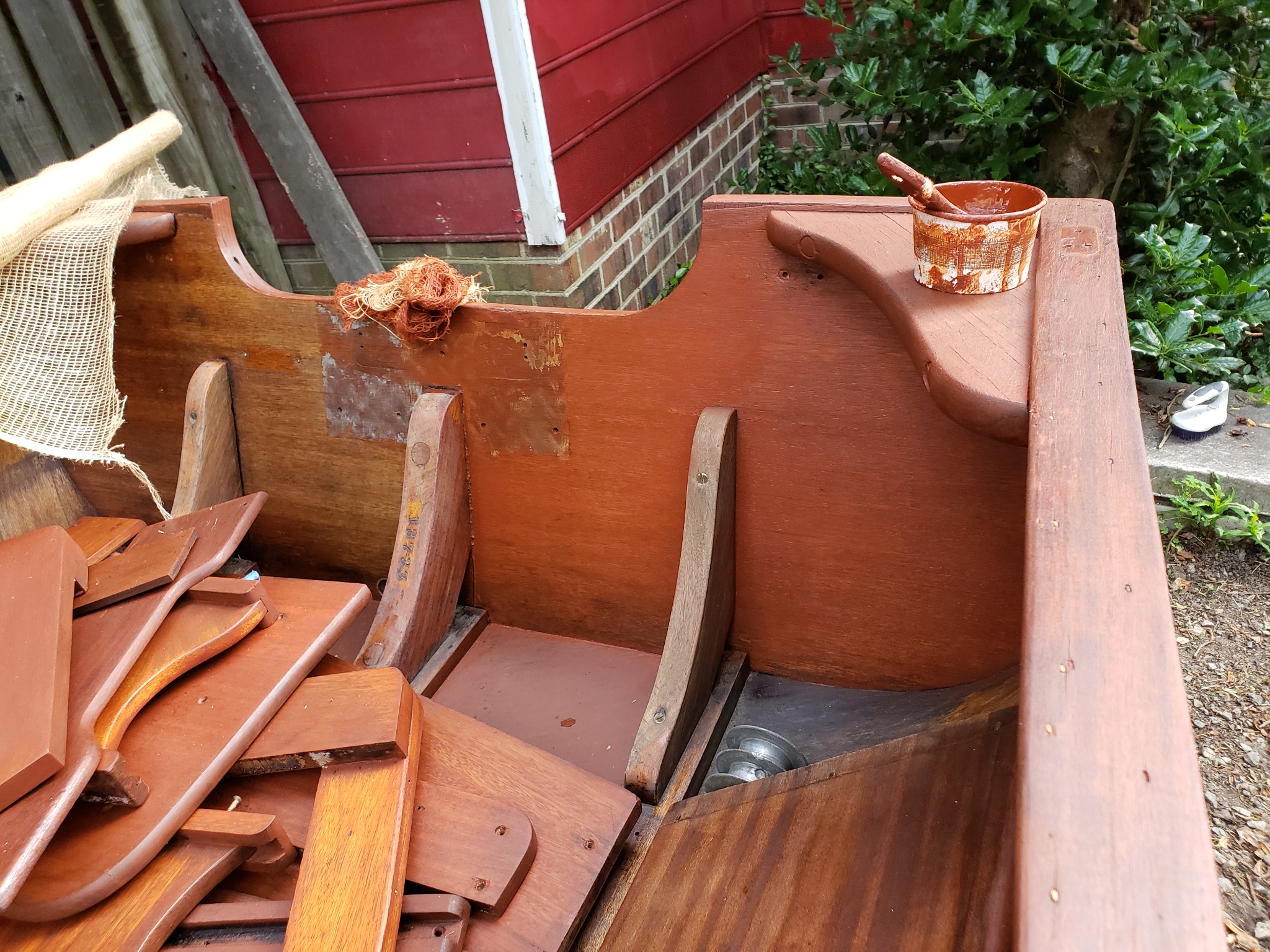

thanks for your response. Boy that boat is fantastic. I did start by testing spots that will be under the floor boards. And i finally got to a point that i liked the mixture. whereit starts to drip off the brush, used a paint brush with the bristles cut short and used is to kind of scrub the stain into the wood, used burlap to wipe up, did not wait long 1-2 min. across the grain then finished wiping with the grain. As i do want to see the grain show thru. I did a very watery 2ed coat and quickly wiped it off the same way.
A few pics
i am thinking of using TotalBoat Gleam Marine Spar Varnish
whirlwind 1961 my next project 6 years 5 months ago #142509
Nice job, I think you found the right combo. Whatever works for the technique. Post pictures after you get it varnished.
