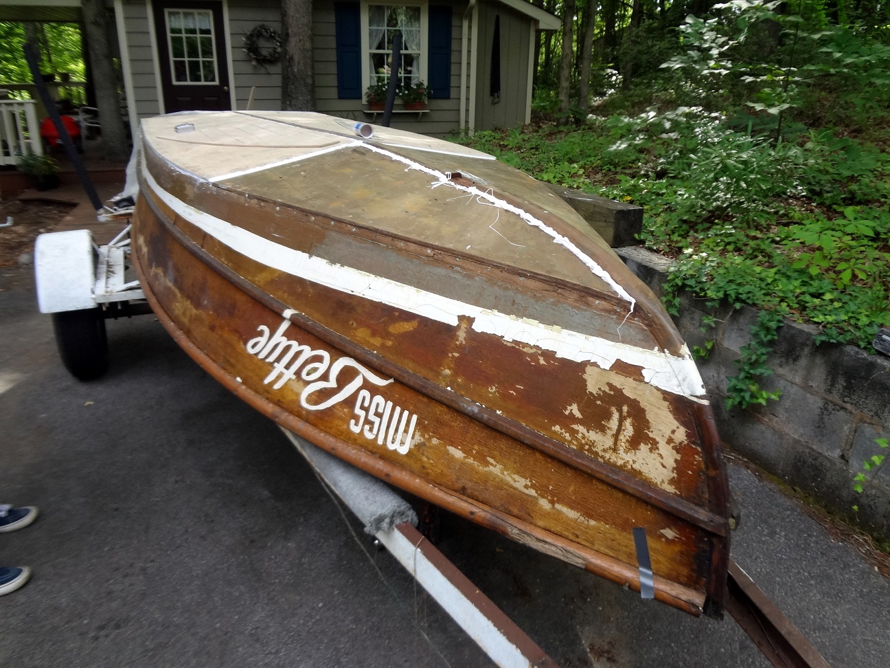

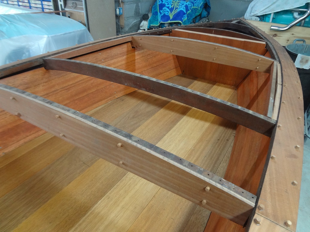

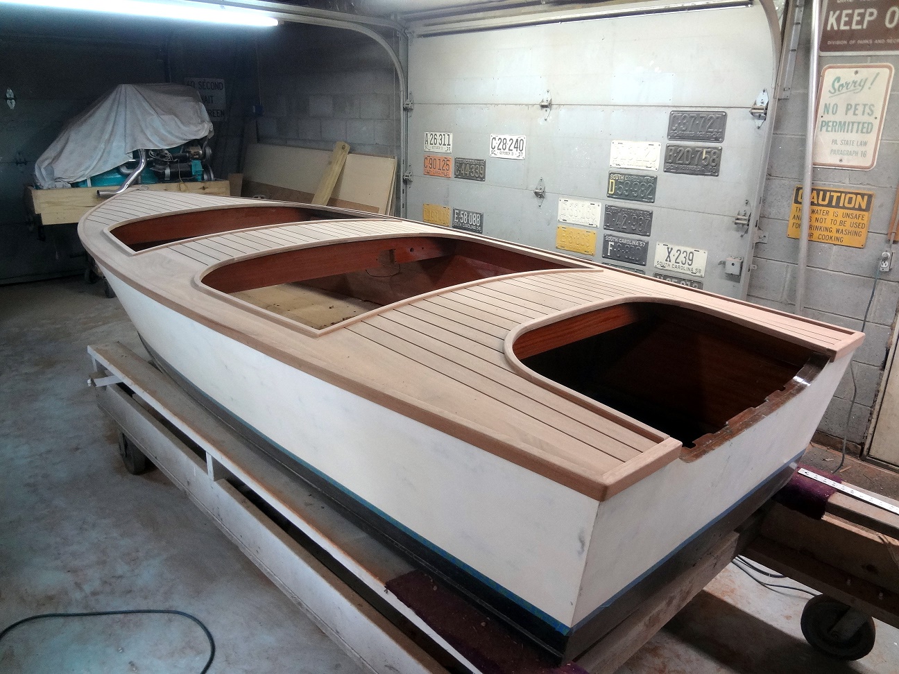

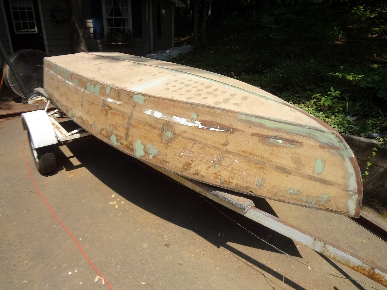

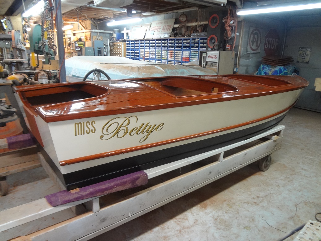

Miss Bettye is a mystery boat. We don't know who built her or when. The hull is plywood and the topsides looked to be interior pine grooved paneling. That has been changed to mahogany planking. I particularly like how the waterline was taped-off many years ago, painted and left that way, tape and all. The bottom needed to be replaced so we just covered the original with 1/4" marine meranti completely bedded in 3M 5200. The hull is way too far gone to stain so we'll paint her Hatteras white. Here are some progress shots. Stay tuned for her debut.

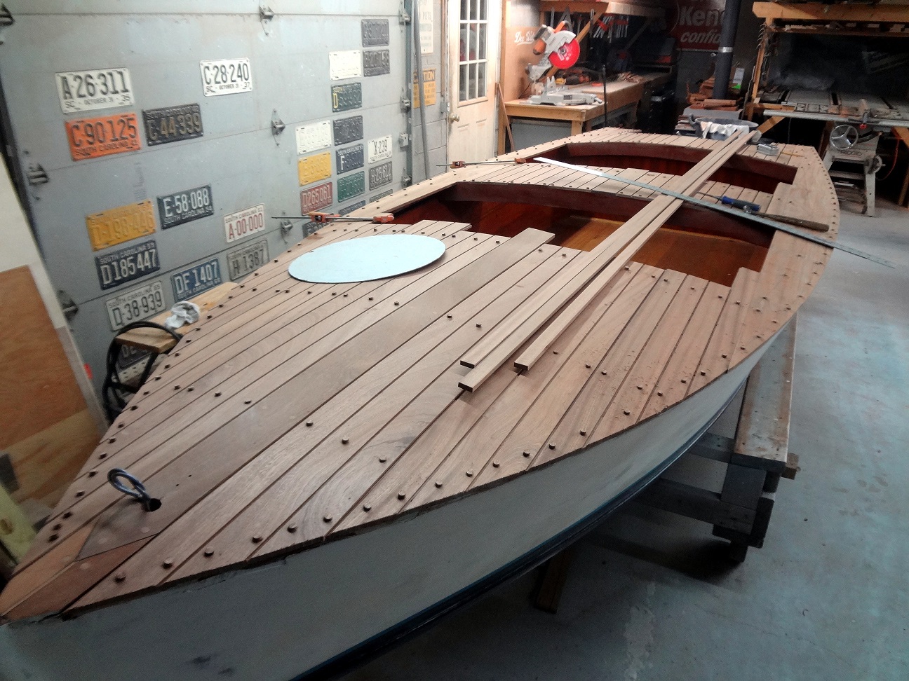

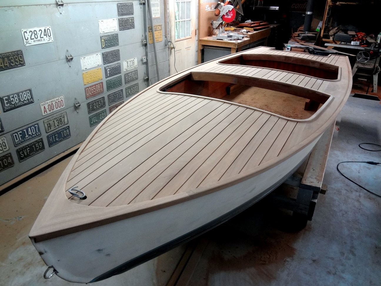

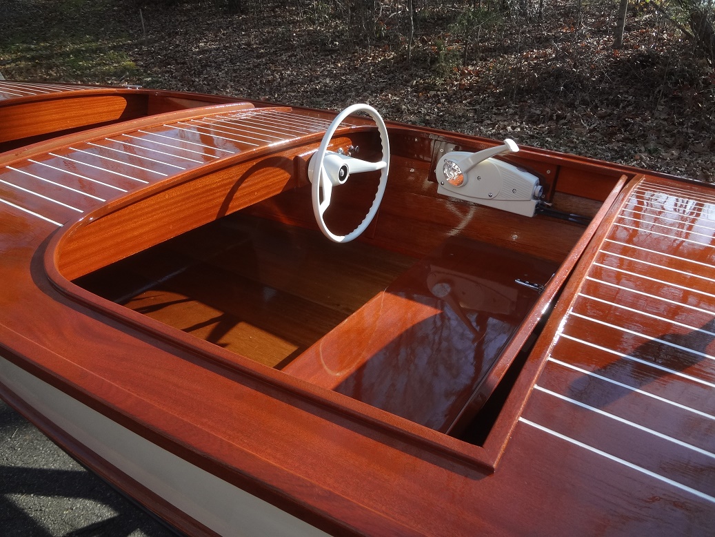

Making some progress....

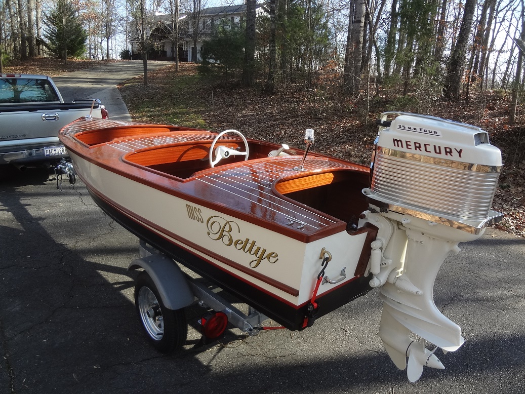

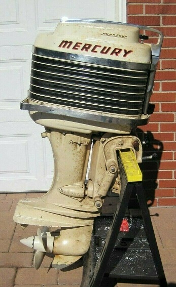

She'll get this short shaft Mercury as soon as I get it cleaned up and repainted.

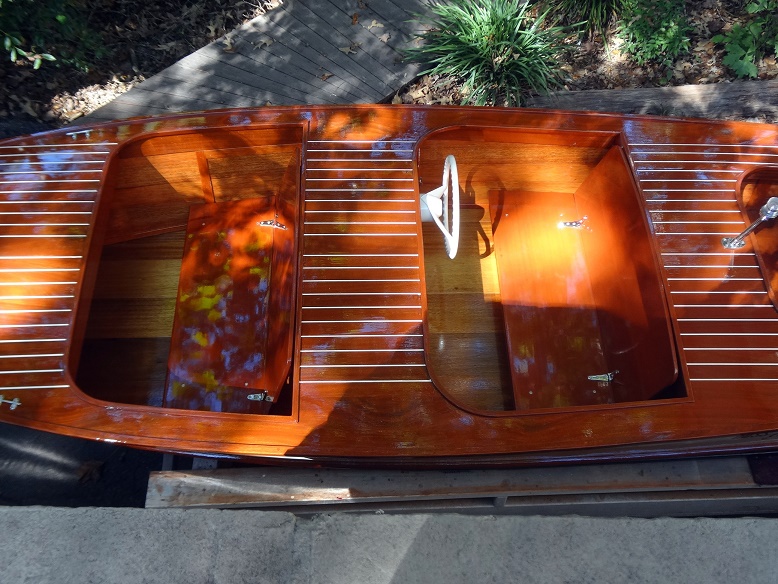

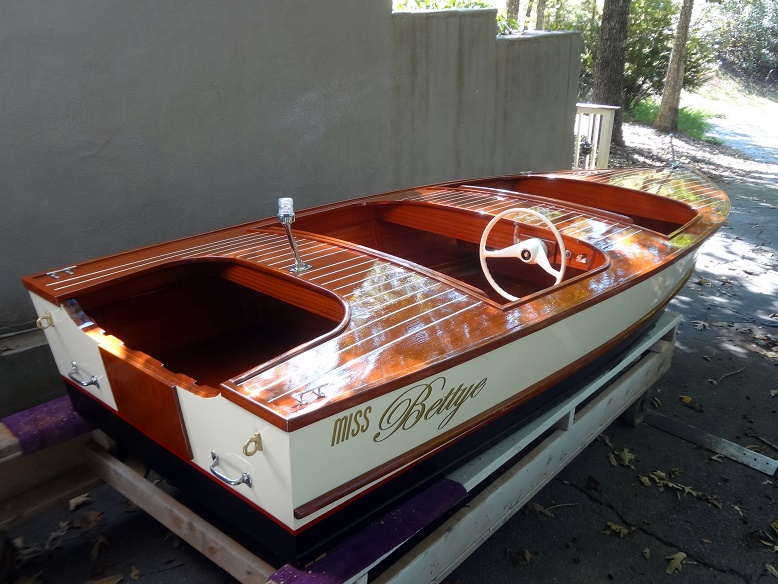

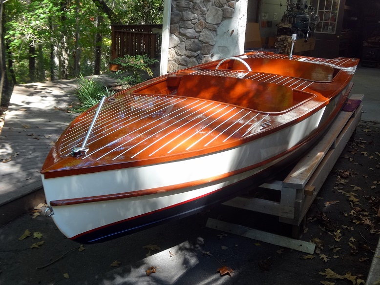

Miss Bettye is finished. Now all I have to do is make sense of the old Mercury motor and get her looking new.

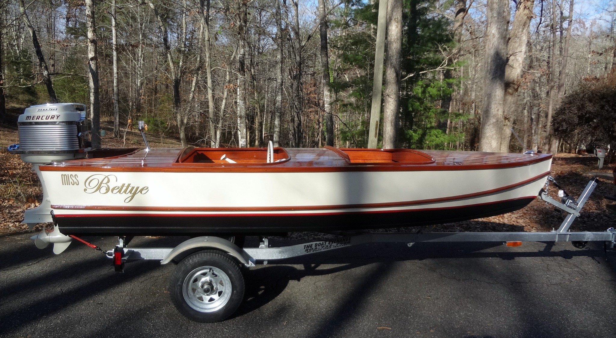

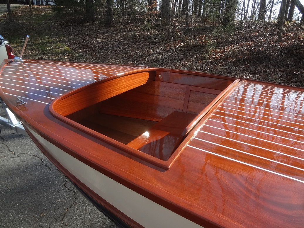

Miss Bettye is finished and I took some photos out in the sunlight:

Miss Bettye 6 years 11 months ago #141548
  • bilnan1
  • bilnan1's Avatar
  • Posts: 900
  • Karma: 63
  • Thank you received: 14
Looks very nice,I like the merc should move well across the water
Miss Bettye 6 years 11 months ago #141549
Outstanding as usual Jan!!!!!!!!!!!!!!! Love the Merc power.
