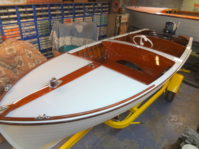

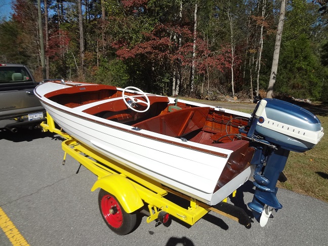

Just finished this Lyman...a lot of work for a little boat!
Restoration Photo Log: www.nautilusrestorations.com/1953Lyman.html

Naturally, the Lyman isn't mine. I envy you guys who have the time to work on your own boats. Lymans are framed like a canoe and doing the bulkheads and bilge is a real pain. The mahogany ply on the bow couldn't be salvaged well enough to stain and varnish so the owner opted for paint. The African mahogany rub rail was my idea. The paint is Z-Spar 99...my old school favorite.

We didn't sand the hull interior, per the owner. The interior bulkheads were thoroughly scraped, swept, vacuumed and then wiped with alcohol. After that, we applied two coats of Captain's varnish.
