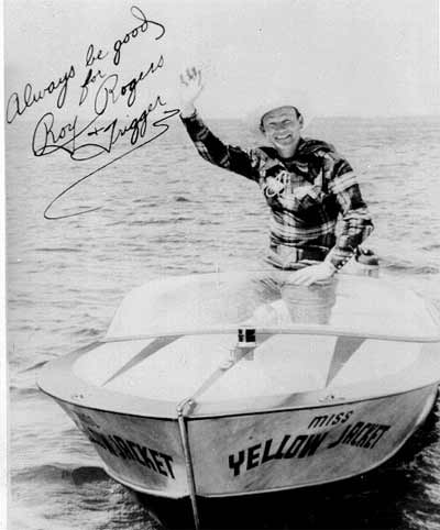

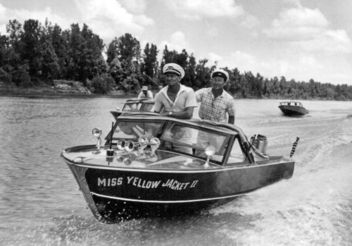

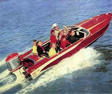

On a historical note: Roy Rogers was a partner ( and vice president) of Yellow Jacket Boats. He raced them and used them for family boating.
JerryF
