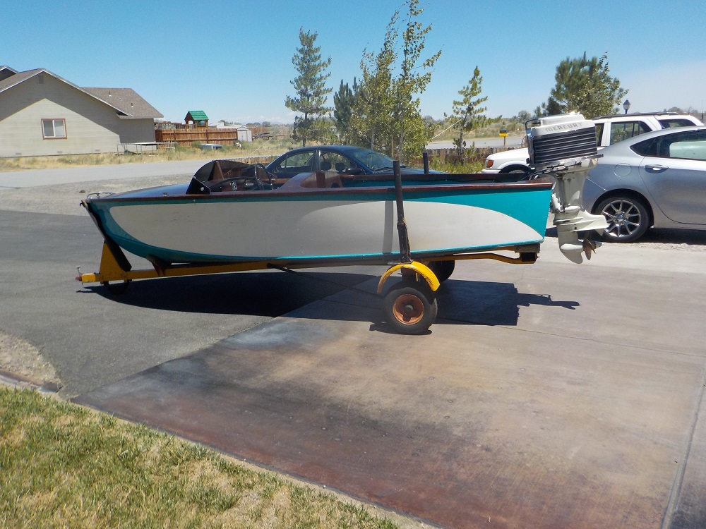

O K , this is a painted plywood boat from the 50's. Solid condition as it set inside unused for the last 40 years I have started sanding on it. The original paint will be staying on except for any problem areas. Two other coats are coming off. My question is, some of the filler over the screws is swelled up from water? so the filler was not up to the job. What is a good product to use to fill over the screws? I will be painting the boat with Marine oil base enamel. At least that is my plan at this point. The boat will see very limited use. Due to old age and banged up body, Me not the boat , I just can't get into a total rebuild job or fiberglassing :S I am open to any advise form those who have way more experience.
