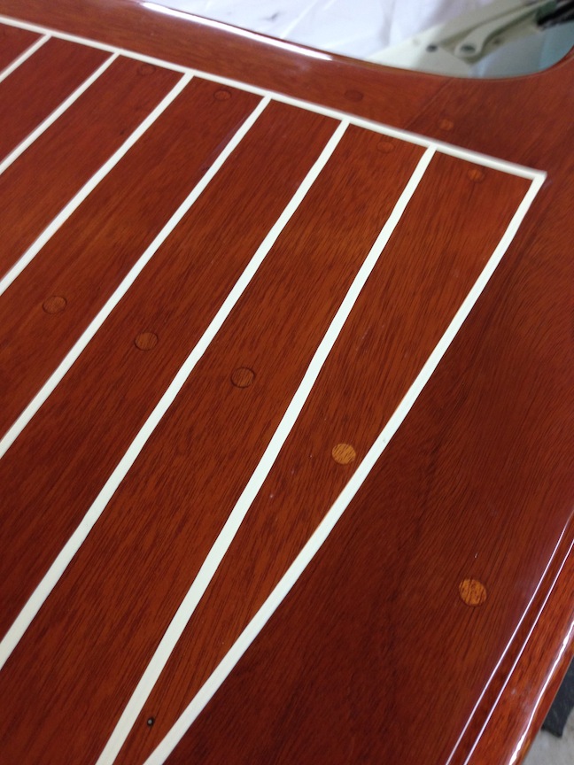

Tim VandeVanter of Van Designs in Spokane Washington striped my Custom Craft after 9 coats of Epiphanes Spar Varnish.

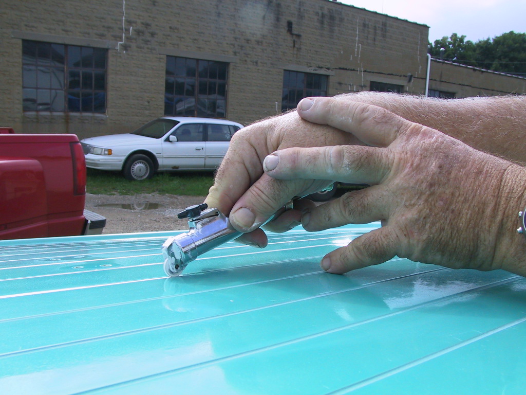

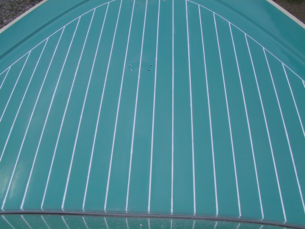

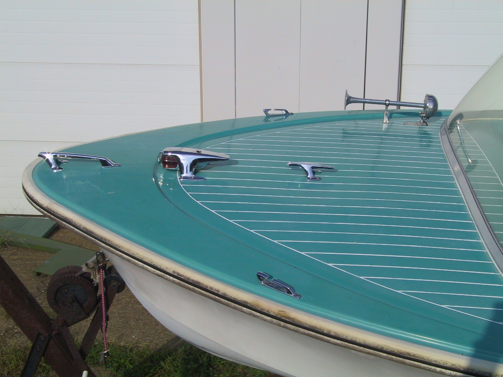

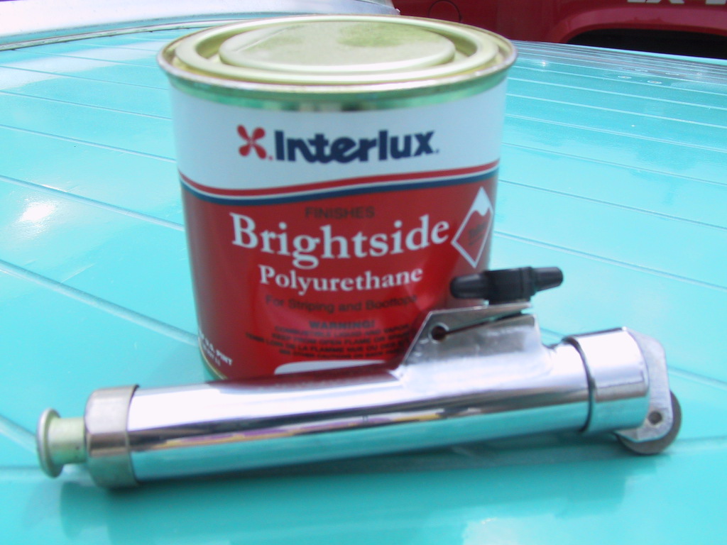

I have used a pinstriping tool with good results on several fiberglass boats.
Re:Pin striping an old woody 11 years 3 months ago #111594
That's what I want to do. I have the tool also. Probably use the widest wheel. MY problem would me keeping the lines straight, have to tape 'em I guess
Re:Pin striping an old woody 11 years 3 months ago #111602
actually,it was fairly easy to keep the lines straight. I would say to try it free hand before taking the time to tape the lines. skipp
