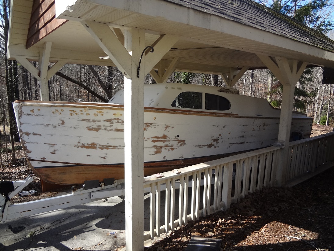

WOW... that does look nice ! looks like it's just exterior weather
refinishing !
Great job !!!
Is there going to be a little Nautilus flare involved ?

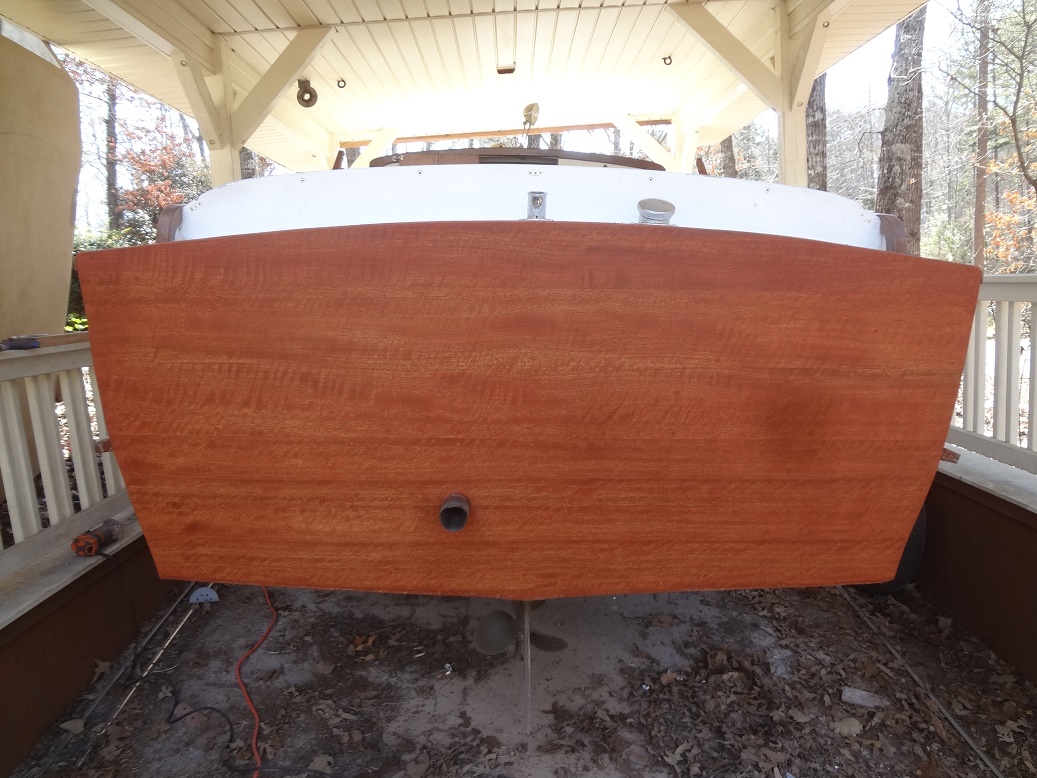

I don't like the transom or the windshield. Appropriate action is being taken. Stay tuned......

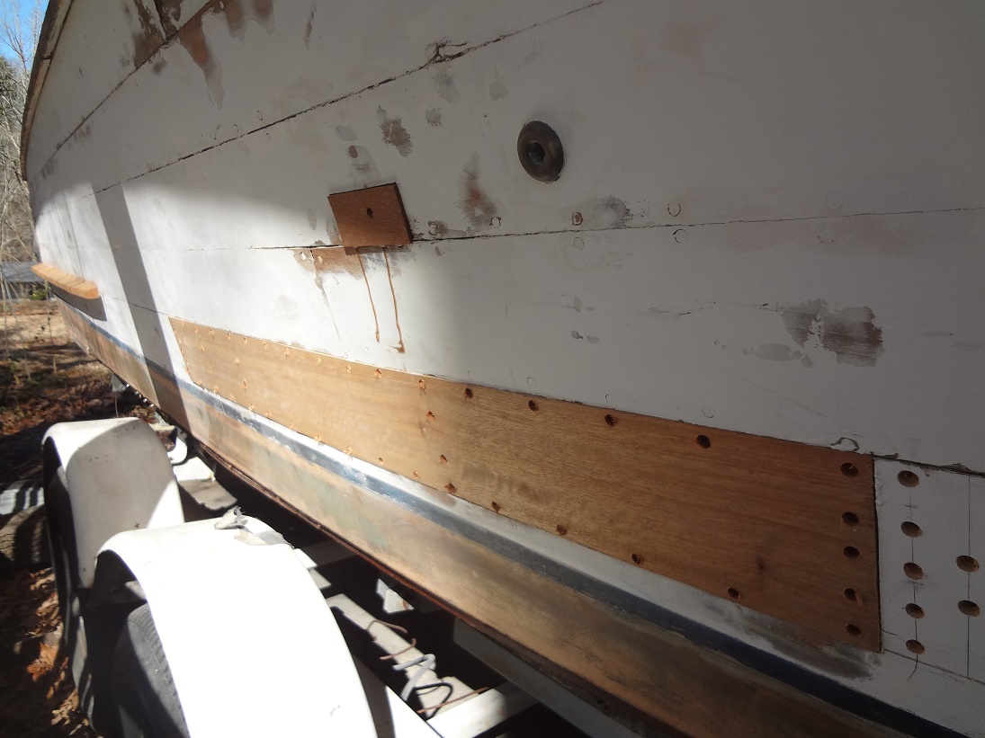

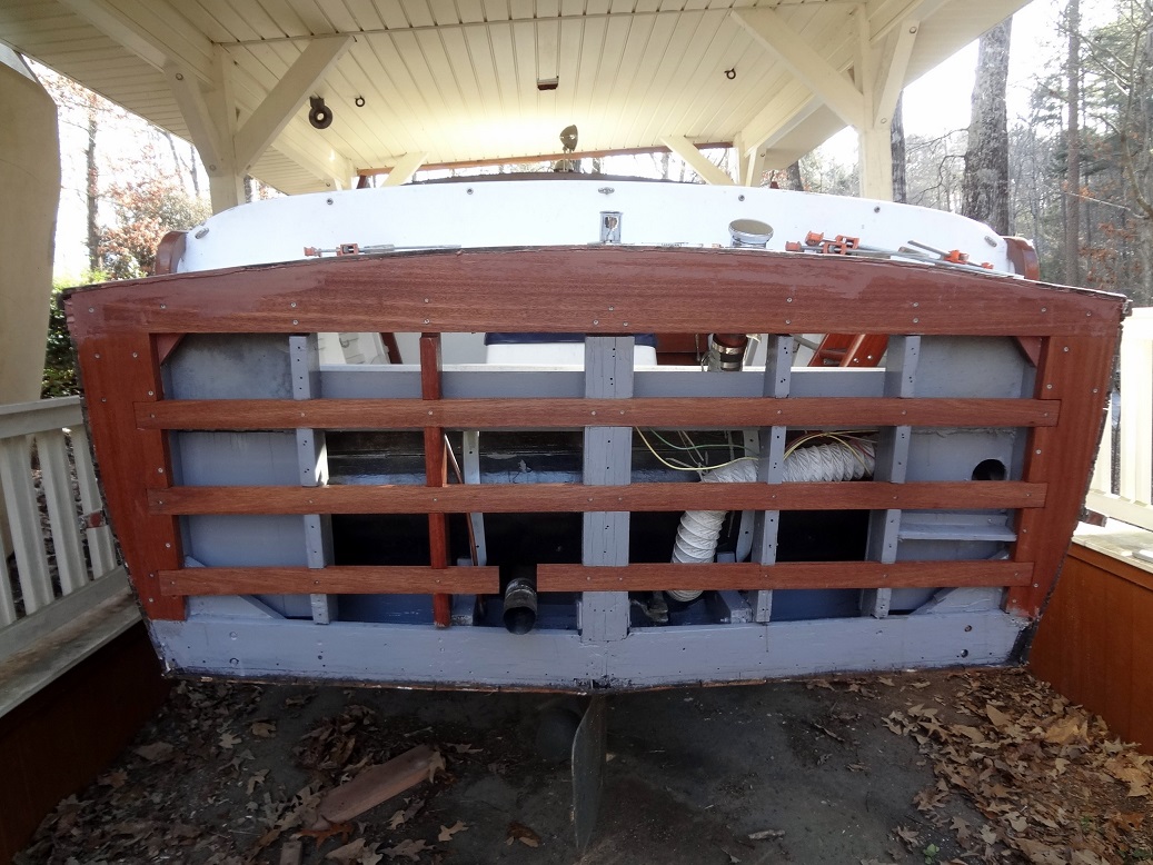

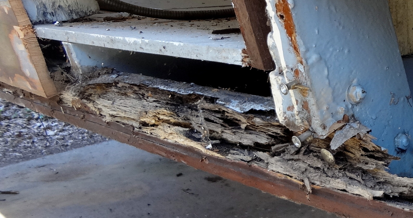

Well, I got the boat cheap, at least compared to the Ebay asking price. Naturally, it needs a lot of work to bring it up to what I consider to be acceptable standards. As it turns out, both chines are rotten...but the ribs are good. I'll replace them but not in time for the couple shows I was going to attend.
Someone did a lot of work to this boat way back when...bad work. Some of the mahogany planking on the sides was replaced with what looks like fir and it's rotting, all the trim was attached with 3M 5200, the transom and most of the transom framing needed replacement, the cabin ceiling is peeling, the wiring is a disaster...the list goes on. I don't even know if the engine runs...haven't even tried to turn it over.
I trashed the windshield and side windows and made new ones...with opening front windows...and we've chiseled-off just about all the trim, which came off in shards. I'm working from the top down. Once I get to the gunwhales, I'll attack the chines and replace any/all bad planks. Surprisingly, the bottom has been replaced and seems to be solid.
All things considered, she's a really nice boat with great lines. However, the old girl turns 67 this year and she needs some surgery, a facelift, and some make-up. Eventually, (shooting for July 4th) she'll be a debutante...again.

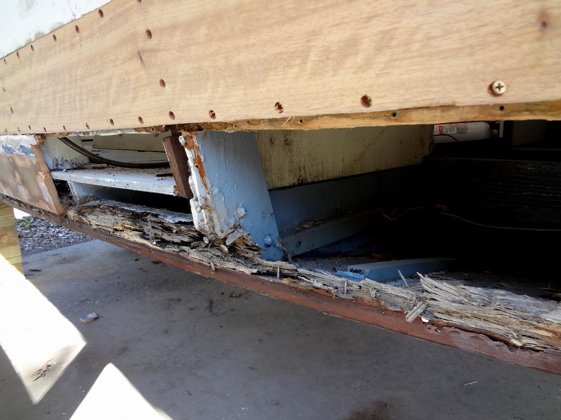

Re:I just can't help myself! 11 years 6 months ago #107510
  • Nautilus
  • Posts: 1580
  • Karma: 87
  • Thank you received: 58
UPDATE
The bad news:

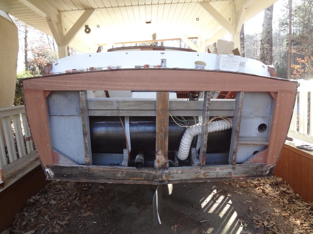

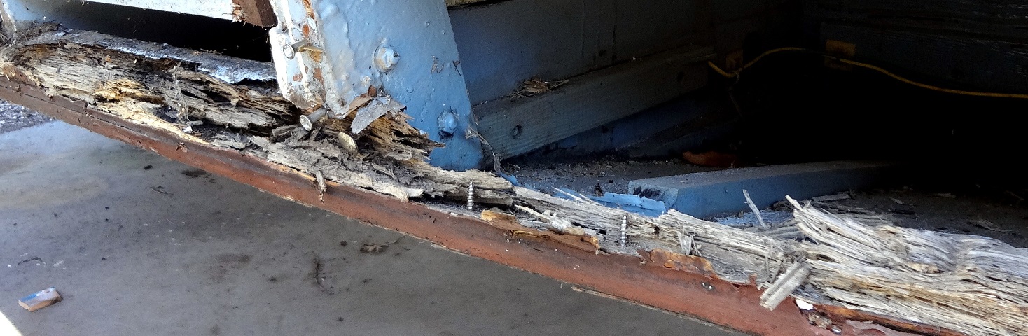

The chines are shot. In places, I can squeeze them into dust with my hand. The keel has serious issues and might need to be replaced...probably. I believe that the side planking and gravity are holding her together. In the hands of a lesser man, these developments might be a problem. However, I'm pissed and pissed-off people get really ambitious. So...we lifted the boat...VERY carefully...and chocked it at the new transom and the bow, which seems to be solid. We'll pull the lowest planks on the sides and replace the chines one by one, employing copious 5200. While we're at it, several of the standing ribs will be replaced as well as a few of the ones on the bottom.
The good news:
The engine isn't stuck.
Summary:
It still beats golf.
Off to Mount Dora in the morning.

Well, I can't decide if I need to replace the chines or just use that "Git Rot" stuff and some duct tape. Any ideas?
Mentor to the unenlightened!
"Success makes...
Re:I just can't help myself! 11 years 6 months ago #107754
Git rot and duct tape will take care of that no problem!!!!

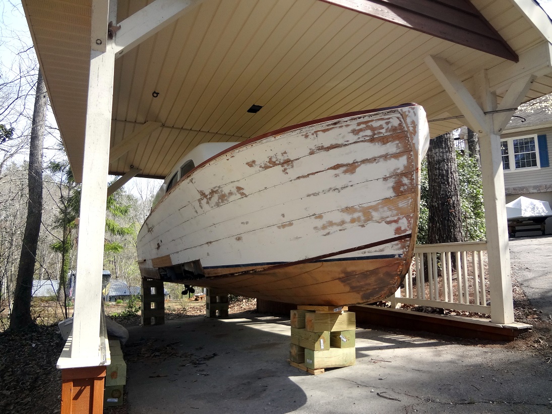

My July 4th deadline is now moot. I've started on the starboard side and of course, the more I expose, the more melancholy I become. It's not that I can't handle it, it's the TIME required. Fortunately, I already own all the material needed to do the job and I can do it "wholesale."
The under layer of plywood is also shot in about half of the bottom however, the planking is solid. Either the boat was re-planked over the original plywood or marine plywood was not used. So...I'll be doing a 5200 bottom from the inside out.
All I need now is enough money to cover my wife's psychiatric sessions/analysis. Donations please. (I spent all the lawyer's divorce money on mahogany.)

Nope...no rollers. There are four double bunks that each look like an "H" but they support the boat on the bottom framework...which is (supposed to be) supported by the chines, which are basically dust. There is currently no support at the keel. So...I removed the trailer and now have the boat chocked well with three stacks of 6x6s log cabin style...two at the new transom, one at the bow. I'm attacking the starboard side first. The previous "restorer" glued the outside planks which cover the chines so they're coming off in many pieces and each frame needs to be carefully dressed with a chisel. Nearly all of the bottom framework will be replaced in the center of the boat but the keel also has issues and I'm still thinking about what to do about it.
It's a BIG job but what the hell...it's what I do for a living and if I were retired, it's what I'd do as a hobby. Any way you figure it, it beats golf. I could use some help so if/when you find yourself in my area, come by and plan to stay a few weeks. Bring beer.
