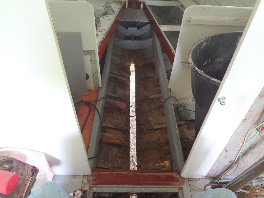

As I mentioned before, this is an EASY restoration...no sweat, piece of cake. However, after a close examination of the forward bilge, I determined that there were evil spirits living inside the wood. I asked Jobu to come but since he didn't show, I removed a 7' section of the keel to get rid of them and performed an exorcism with sea salt, garlic and by screaming "demons out!" Now that the bilge has been purified, I can begin to replace the framing members that were possessed.
Mentor to the unenlightened!
"Success makes...
Re:I just can't help myself! 11 years 4 months ago #109195
Picture looks like you got a hellavaleak there. Get out the bondo :laugh:
Re:I just can't help myself! 11 years 4 months ago #109209
Youch I hate it when that happens!

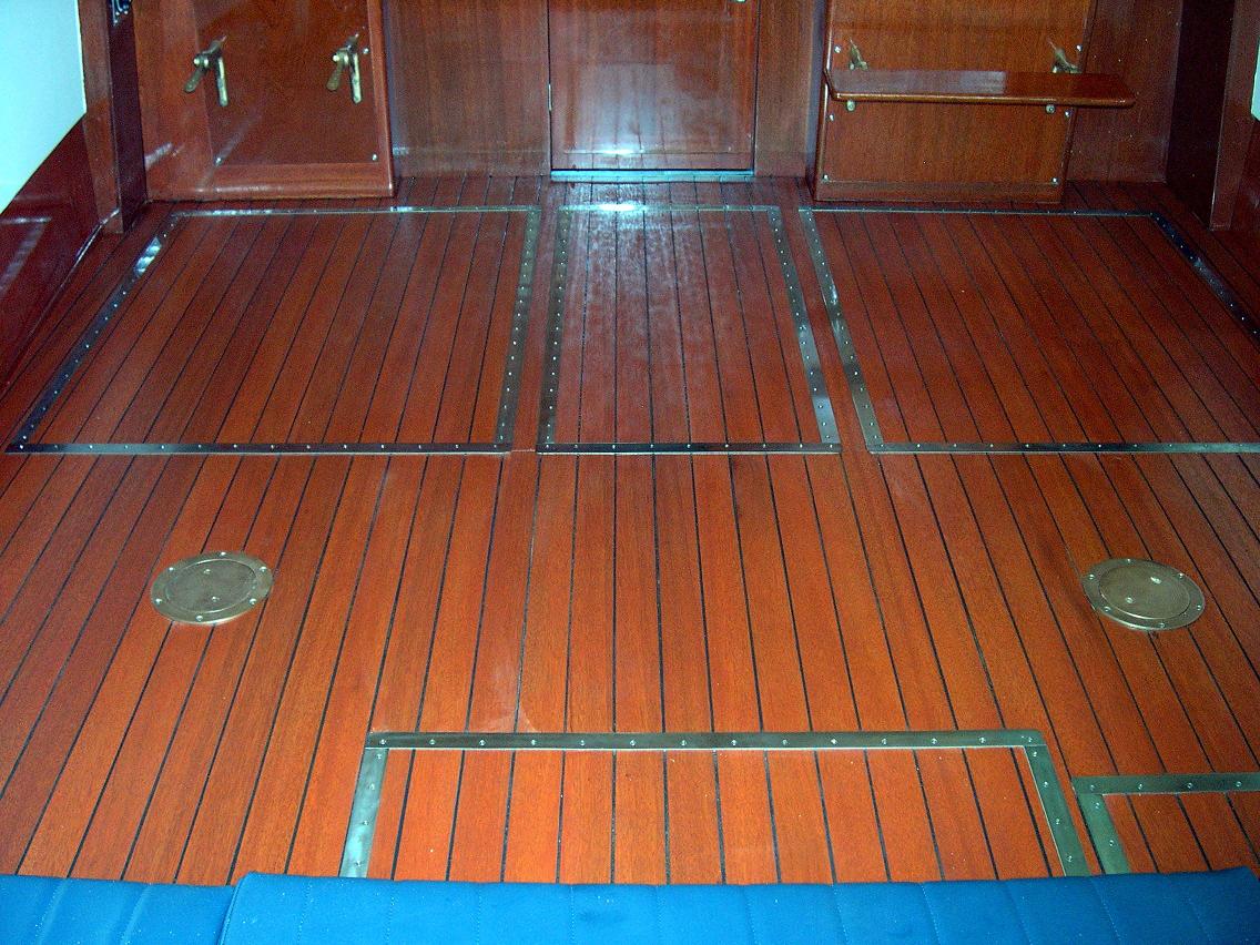

I guess it all depends upon how you want the wood to look but because the wood will be exposed to water and sunlight, you options are somewhat limited. Just about everyone I work for wants high gloss varnish and for that, I use Epiphanes...about 8 coats. For a low luster finish, I use hand-rubbed oil, 50/50 mix of boiled linseed oil and turpentine. Apply liberally and let sit awhile, then rub off all you can. Repeat this 3 or 4 more times. The best part of this finish is that it can be spruced-up easily by light sanding and a few more coats of oil. Here's an oiled mahogany deck I built for a 1958 Chris Craft Commander:
"Success makes...
Re:I just can't help myself! 11 years 4 weeks ago #113877
OK, thanks! Just boiled linseed oil and turpentine! As you know, there are a million answers to the question, but seeing your work is all the proof I need. I want to build a sun bathing platform to install atop the cabin roof. Not sure if it'll look hokey, but I think I want to give it a shot.
