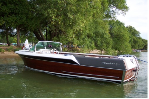

Thanks for the advice. I am looking for a boat that does not need to be restored. It will be used quite often in the Summer's on Lake of the Ozarks. During the season it would be stored on a covered lift. Off season it would be put on trailer and stored in a non-heated storage barn. I am not looking to be part of the restoration process so looking for a good user boat. While I want it to look nice, I am not wanting a boat for show. Kind of like a new car, rather have a ding or two so I dont worry about keeping it pristine. It will be used for cocktail cruises in the Ozarks. Not having had one I am not sure between a utility and a runabout. I like the room to move around in a utility but unsure of the noise of having the engine in between the driver/passenger. I am likely looking in the 20' range and will be trying to keep under 10K. We shall see. I have not fully decided on wood vs a vintage fiberglass but have started looking and doing research. Just love the look of the vintage wooden boats. I found a 20' Century Resorter that seems in great condition for a user boat, not perfect that is. I decided to get educated before I rush into something that ends in regret. Since I know nothing about wood boats I would not know what to look for in person. On top of that, I have owned a few boats before and currently have a couple but have never bought a boat that I did not test drive in the water. Here is the one I was discussing. I received detailed pics and my opinion is that it is over priced when compared to some others I have seen online. I also just reached out to the Mississippi Valley chapter of the ACBS to join and start some dialog. I will check out some of the other sites you all mentioned as well. Thanks so much and have a safe holiday.
stlouis.craigslist.org/boa/4777088599.html

Re:advice 11 years 11 months ago #102712
Without looking at the boat in person, that price is not bad considering it's a 20' and if he has done everything claimed in the ad. Just my opinion but if you find something for around $10k it's probably going to need varnish work in it's near future, but everything else should be solid and no rot anywhere. The transom area is pretty much notorious for rot on all wood boats so you have to be careful and look it over closely. All in all the one you're eyeing looks pretty good from the pics. He does say make an offer but I don't know if he would go as low as $10K for all the work that was done. If he did it himself that's a good price. Now a days a bottom replacement will run close to $15K if it's done by a professional restorer, so you can guess what a total restoration would cost.
Re:advice 11 years 11 months ago #102715
My knowledge of Century is limited, so What I know may be off ?
Century is a seam batten boat throughout. Meaning: where all the planks butt up against each other, they are fastened to the battens, and frames.
Chris Craft had an inner bottom along with battens, or an extra line of defense from water intrusion. The seller makes no claims to re-bedding, re-screwing, or replacing
Any of the bottom. But if he used Billy Mays Flex seal ? …. Ha-Ha-Ha !
So if you can check to battens for splits, rotted bottom side edges or anything that may cause concern. Do so. Also a certified Boat surveyor ? You’ll be out the cost of a survey, if the boat has serious issues ?
But you’re way ahead, if you find the costly repairs after purchase.
I’m sure to best of the Owners knowledge the boat is sound, and he is not trying sell junk. But care should be taken

Re:advice 11 years 11 months ago #102717
All good points Chuck. The seller doesn't say if and when the bottom was redone, I would assume it has been re-done at least once but you never know. Also don't know if it was re-done, was it a 5200 bottom, (dry bottom) or some other method. Lot's of if's in this one without physically looking at the boat, as you know. Hell the transom on my boat looked great from outside until I got the planking off and found it rotted, as seen in my project thread. I guess my point is for $10K don't expect a boat that isn't going to need some work done in the very near future. Wood boats aren't cheap as you know. I'm also not trying to scare anyone away from a wood boat, just know what to expect when you get one. They can last a very long time if they're taken care of and the preventative maintenance done religiously. Letting paint or varnish go until some slight bare wood is showing will only result in lots or rot later, depending on where it is. Just my 2 cents.

That is a beautiful boat. However I wouldn't touch it without a survey from a surveyor who specializes in wood boats, and I am qualified to be a surveyor. Surveying s boat for yourself is a lot like being your own attorney, you have a fool for a client. They are not emotionally involved. Check out www.marinesurvey.org/ That is the Society of Accredited Marine Surveyors. Find one who works in your area (which may be the whole state or nearby states) Make sure they do wood boats. Or you could find a surveyor through BOATUS. www.boatus.com/searchresults.asp?q=surveyors%20directory I can not stress getting a survey too much. An old wood boat like that is hard to insure without a survey, and it will save you the cost of the survey if it is bad under the nice varnish and paint.
