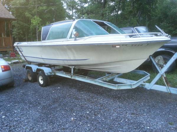

Ill have to get better pictures of it once I get the boat moved off of it... The title says LONG but I cant find any info on it or any info on them online, if that's the MFG. I picked this boat up as a project but sadly the hull is damaged and Im going to scrap it. Since this trailer seems to be very well built and flat Im going to convert it into a utility trailer! Any help identifying it and its weight hauling capacity would be greatly appreciated.
My plan is to move the axles forward as they are on a subframe that is held to the trailer with U bolts. Remove the uprights and the winch mount, new tires and possibly bearings and wiring. Ill weld on some stake pockets and build some removable side walls and a tailgate. I know its not boat related but if anyone could give me a hand identifying it so I can find an owners manual or any info that would be great! Thanks again, Matt

should work well....we have a single axil trailer, 12" wheels, plywood sides that we have had 6 v4 evinrudes on and did ok on interstate speeds...just remember to leave some tongue weight when moving the wheels john

Long Trailer Co, Inc
313 Bass Lane
Tarboro, NC 27886
(252) 823-8828
