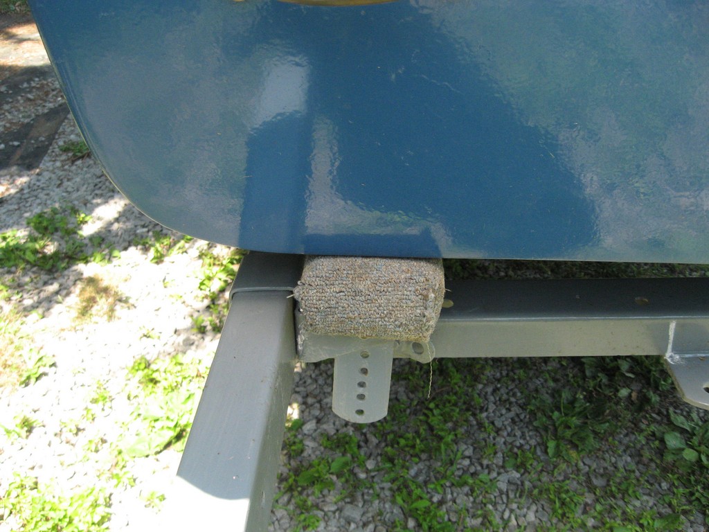

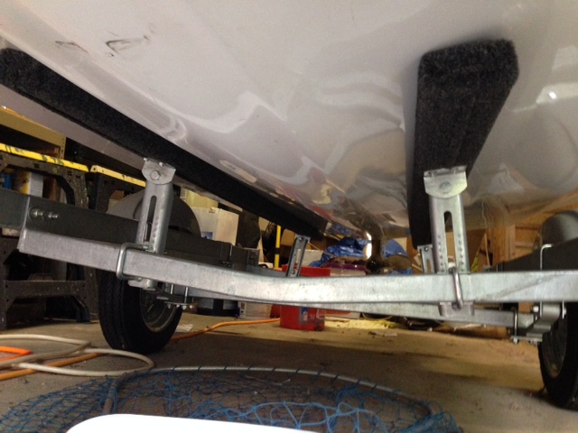

When I bought my 50 year old G3, the rollers had dimpled the hull from many years of supporting weight in the same spots. After my resto, I moved to bunks on a new EZ Loader.
My view (for what its worth ;) ) is that if they are properly adjusted... supporting the weight over as much of the length of the bunk board as you can, is the best. Also, having the bunks extend past the transom, where the weight of the motor is fully supported by the transom sheer... and not by the keel rollers will avoid developing a hook in the hull too.
My EZ-Loader has no keel rollers, and the entire hull is supported by the bunks.
