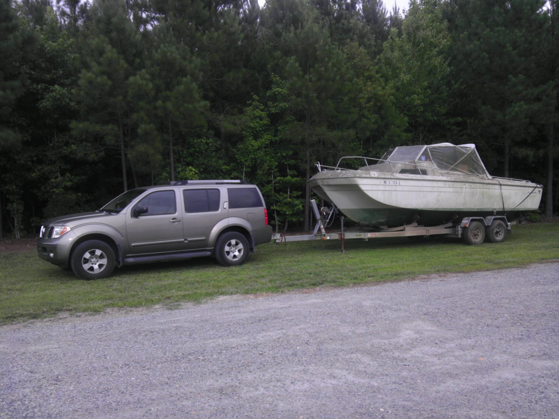

Re:Trailer Surge Brakes 12 years 4 months ago #97348
I got the rig back to my house - about 200 miles. What a terrible towing experience. It felt like I was pulling a deployed parachute the entire way home. Significant vibration at all speeds. Now, the tires are indeed dry, but held pressure the entire trip with full tread, no visible soft spots. I was able to inspect all of the hubs and bearings before bringing the rig back. Bearings and hubs were fine.
I'm wondering if the vibration was due in large part to the boat being a tri-hull. Seemed possible air could be trapped flowing under the boat (lifting it). I pulled the rig with a Nissan Pathfinder and there was about 6 feet of tongue between the TV and the boat.
Pathfinder is plenty for the rig - I pulled my Luger on a single axle, no brakes, through mountains and had a smooth ride all the way from Rochester NY to Raleigh. I pulled 4000 lbs of deck lumber last month and was fine there as well.
Oh, the trailer is in near-mint condition, exception being the brakes which had rusted out. I'm very happy with the trailer - it looks like it could haul a half-track.
FYI: Boat is a 1969 23' Thunderbird tri-hull cuddy. Trailer is a Long Trailer Co galvanized tandem axle (6000 lb capacity).
Re:Trailer Surge Brakes 12 years 4 months ago #97359
I don't think the hull design (even a tri-hull) will effect the vibration when towing KC, I pulled a 17' Glastron tri-hull all around the Southeast with a mini truck for a couple years without problem. Not sure what the towing capacity is for your Pathfinder, but dual axle trailers are harder to pull.
I would look to the tires on the trailer first. Even though they hold air, they are very possibly "flat spotted" from sitting in one place for a long time. They look to be common size (?), maybe you can find some decent replacements (good used would be fine) and try that first?
Just my two cents, glad you got her home safely!
Re:Trailer Surge Brakes 12 years 4 months ago #97367
I've seen tires out of round from sitting. Also consider the hull may contain waterlogged foam.
Re:Trailer Surge Brakes 12 years 4 months ago #97378
Cool Rig,
In addition to the tires, if you towed it with the canvass up like that, it may have contrbuted, believe it or not. I and friend towed 21' with a bimini up (against my better judgement) and it vibrated in the wind. When we stopped and put it down, it went away. Just a thought...
