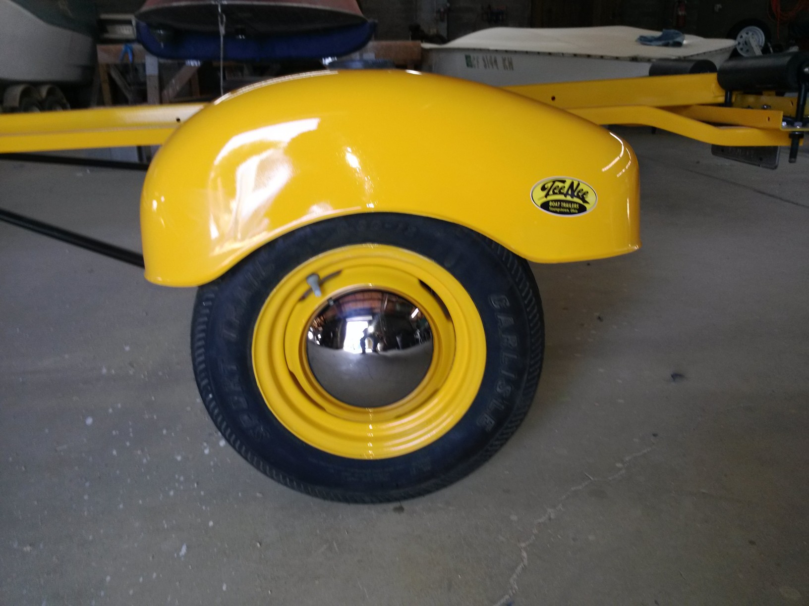

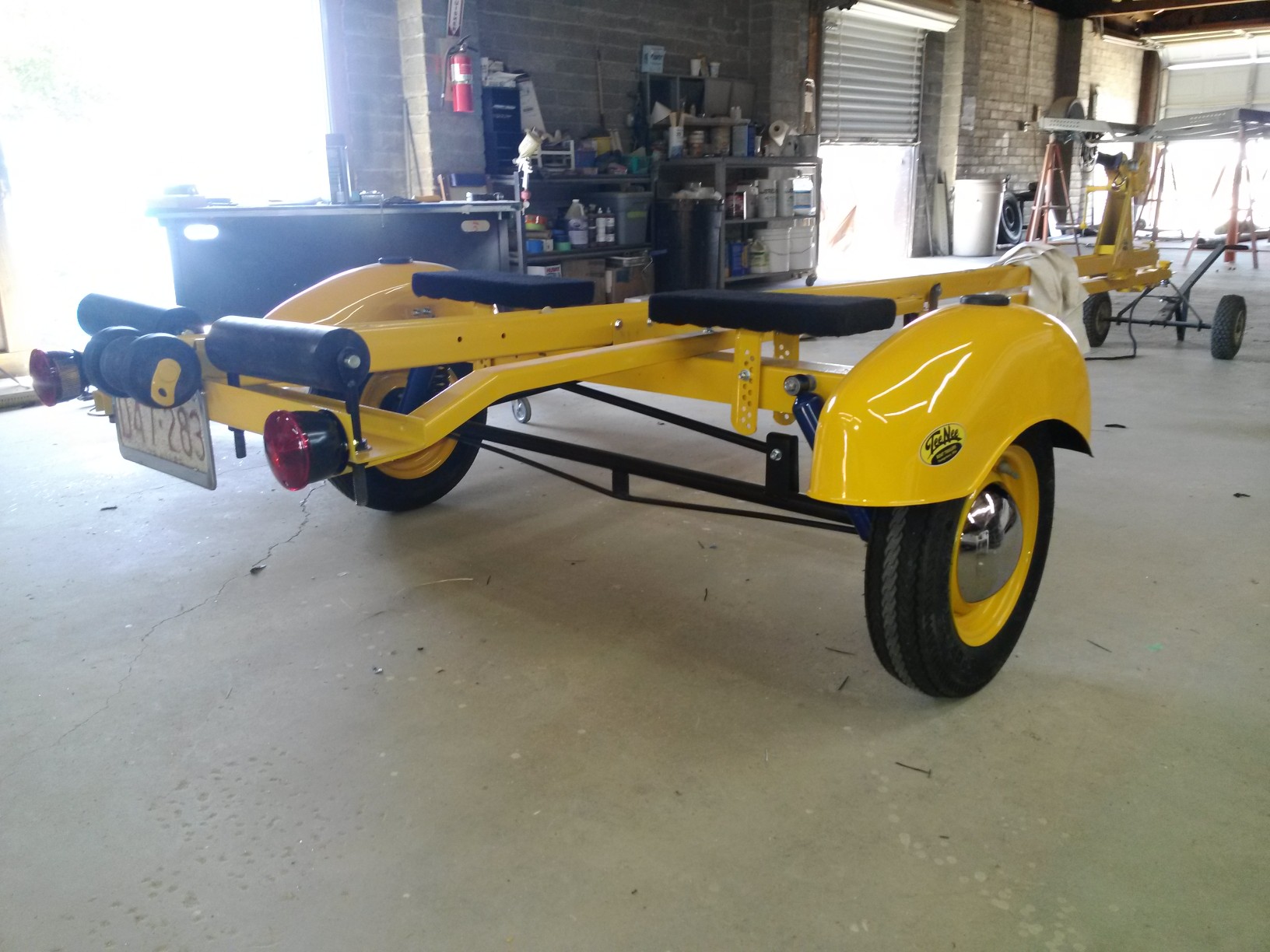

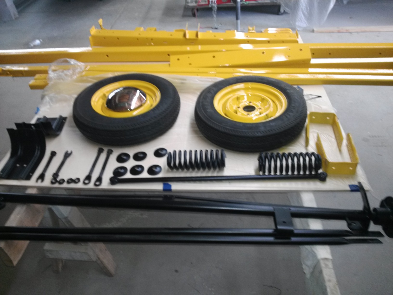

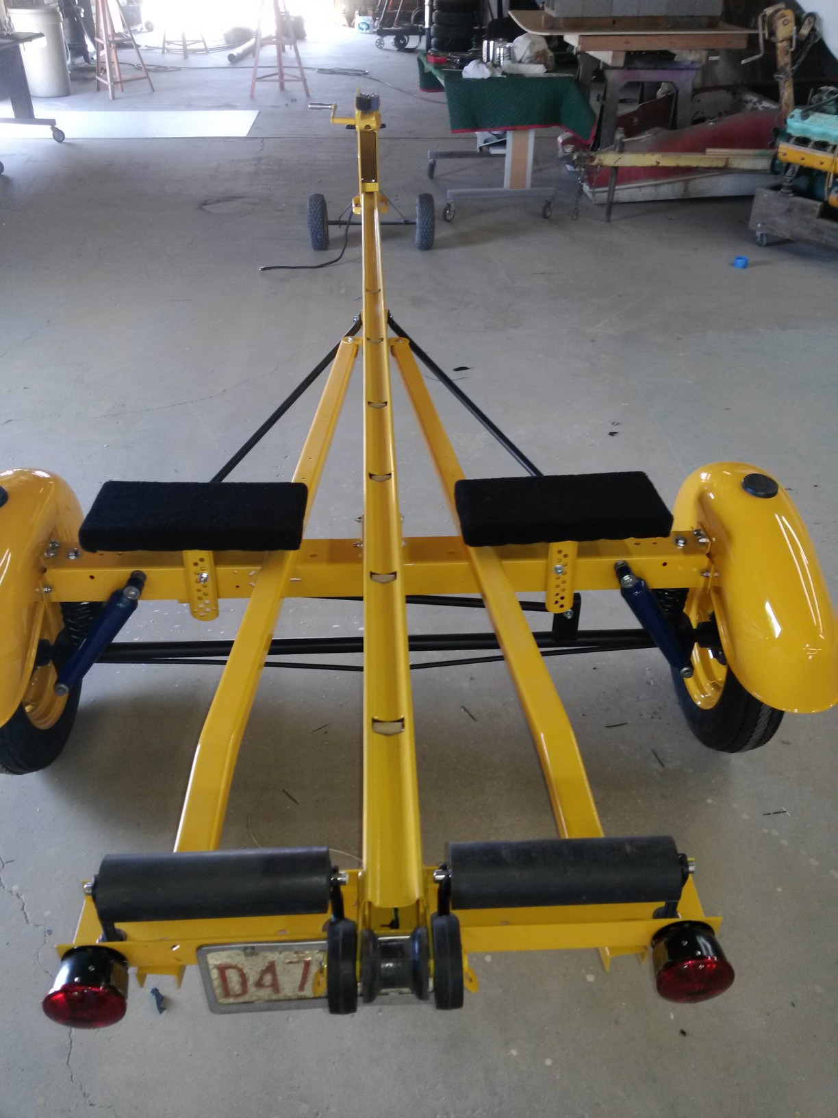

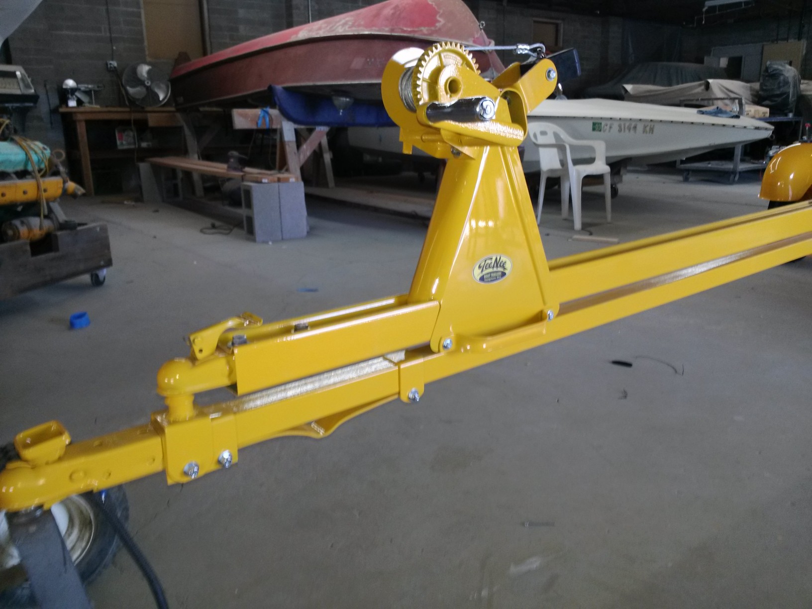

We completed the restoration of a very old and rare Tee Nee trailer, yesterday. It has a double tongue with the top tongue having the capability to tilt, thus assisting a launch from shore.
All trailer parts were sandblasted, primed with 2 part epoxy, and finished with Imron Polyurethane. ( color is customers choice )
Larry

larry, the trailer looks very nice. you did a great job. I had a double tongue trailer years ago, but it was not a tee nee, but can not remember what it was. frog

I believe this trailer is a 1955 or 1956 model???
We have had several old tilting trailers, but, none with the double tongue.
A Really cool 1956 dual cockpit 14' Wagemaker Wolverine will sit on the Tee Nee.

I tried to find this trailer in my books but I only go back to 57. In 1957 -8-9they had an accessory called the tip and turn that you could add to any trailer. To make them a tilt.

Del, I think your right. This must be the optional Tip & Turn feature.
Glassics Library shows an additional ball mounted on the lower tongue of a 57', but not the additional tongue.

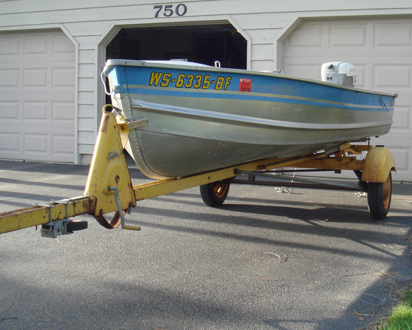

Picked up this package so I could restore the trailer for another vintage boat. Nearest guess is 1957. Rollers, winch, tower, fenders, baby moons all original and good shape but for age. Want to disassemble and blast to bare metal, prime and paint. Am familiar with Imron as I've been in the aircraft parts and supplies biz for many years and was an Alumagrip distributor. Have an old Starcraft shot 25 yrs ago...still shines. I will disassemble but need to find someone to blast and paint. Am in the Chicago area...any suggestions? Also, the plastic Tee Nee badges on the winch tower need replacing as well as the fender decals. Are they available? The baby moons are rusted and need re-chromed or can I find aftermarket replacements. Everything else looks solid...no rust thru. Do you do anything for the inside of the main beam like sloshing compound or rust converter? Can't believe the rollers won't deteriorate pretty fast. Do you just use them til their shot or use some aging preventative? Sounds like you're in the restoration biz so I'd be happy to compensate you for your time answering all these questions or hire you if you are within a reasonable distance from Chi.
This is fun! Jim AlumaFD
Re:TEE NEE restoration 12 years 6 months ago #93866
Oh, one more thing. Notice the third wheel on the main beam? It has a simple spring loaded mechanism for it to drop down and swivel. Looked at it closely and it was stamped Fulton, Milwaukee, Wi. Guess it was one of the first trailer jacks..w/o the jack.
