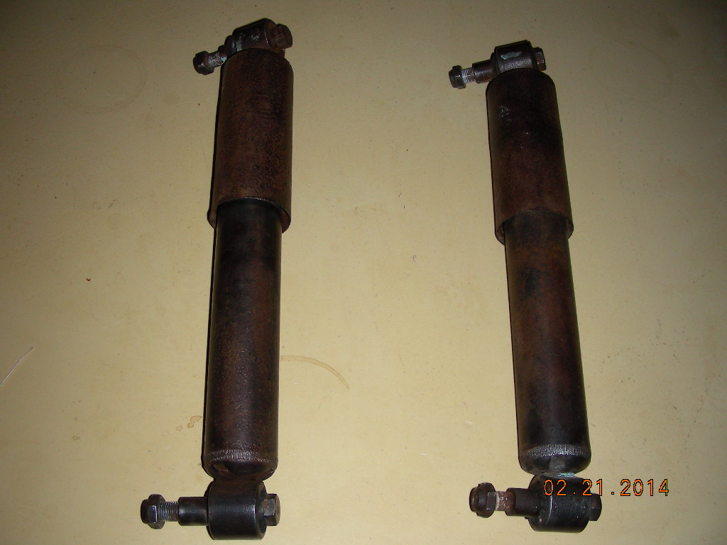

I pulled these two shocks off my project, and feel that replacements are in order, as there is hardly any resistance left on one of them in particular.
One looks a bit different too, with a flare to the upper bell, so one or the other must have been replaced at some time?
I cannot make out a make or model on either one.
Any suggestions for a currently available replacement?

You will want them about 9 inches collapsed and 13 extended. Make sure you get the right (round) top and bottom. Also you will need the spacers that are now in you old shocks.

I followed MarkS' info link, and bought a pair of MONROE 33076UMM.
They seem to have the dimensions you mention, and have round holes top & bottom.
Also noticed that I will have to use the old hardware to stand off the shocks from the frame.
I assume that the little metal collars inside the new shocks will just press out, and are not fused to the rubber ?
Any suggestions welcome.

If memory serves me right, I had to change the top mounts to s/s bolts, as I couldn't find a shock that fit exactly

Today I pushed the new to-short collar out,using the original longer bolt & its collar.
Put a little oil on the old collar, still a good snug fit.
One step operation, and we're good to go.
