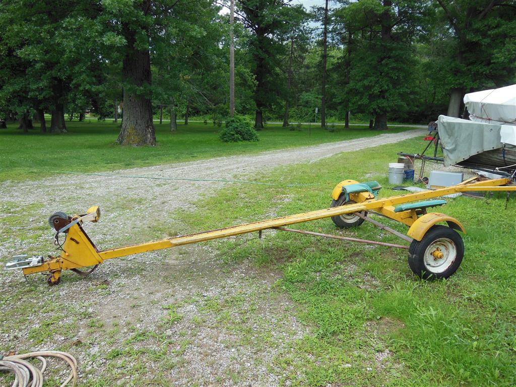

I'm going to strip and paint my (1956?) TeeNee trailer (S/N 73856) and have a bunch of questions
1) The original color of the trailer was yellow, but what color was the axle and the two braces that run from the axle to the main beam? I've seen posts of restores where they are done in yellow, as well as black. looking under the current paint for the original color,it almost appears it could have been red/brown primer.
2) the top of the fenders have a red plastic "pad" about 3"x8" - were these original, and what was the purpose?
3) there's a cable that runs from the center of the axle to a broken "lever" hanging up by the hitch. What is this, and what was the original setup at the trailer hitch?
4) It appears the crossbar at the back of the trailer with the lights is a poor add-on - is it a correct assumption that the original had no bracket for lights/license plate? What is the suggested or "best" way to add one on?
Thanks much for any help!
Dave

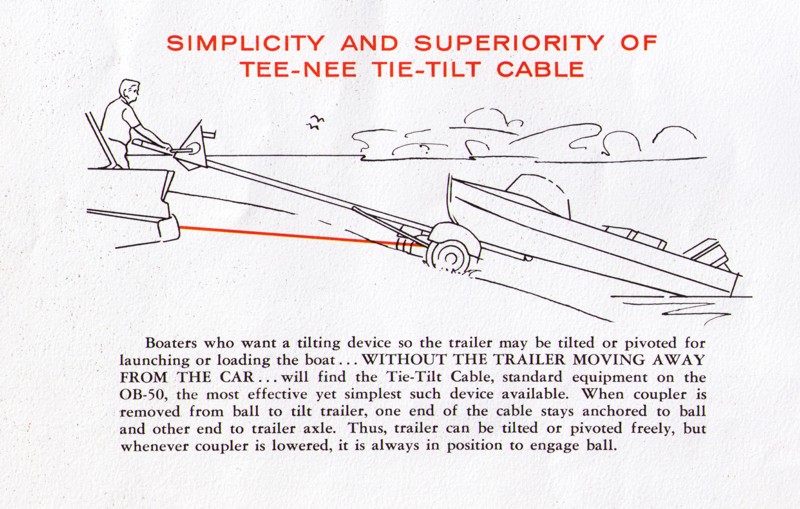

The cable was a feature that hooked to the bumper hitch ball. Then at the lake you could unhitch the trailer toung and swing the trailer to meet the drifting boat. I'm not sure I would have used the feature but it was there if you needed it.

You have a 57 -59 OB-50, the accompanying ad will answer your color questions.
I don't believe the pads to be original.
As pointed out the cable is the Tie-Tilt feature, the original hitch set up is also in the pic.

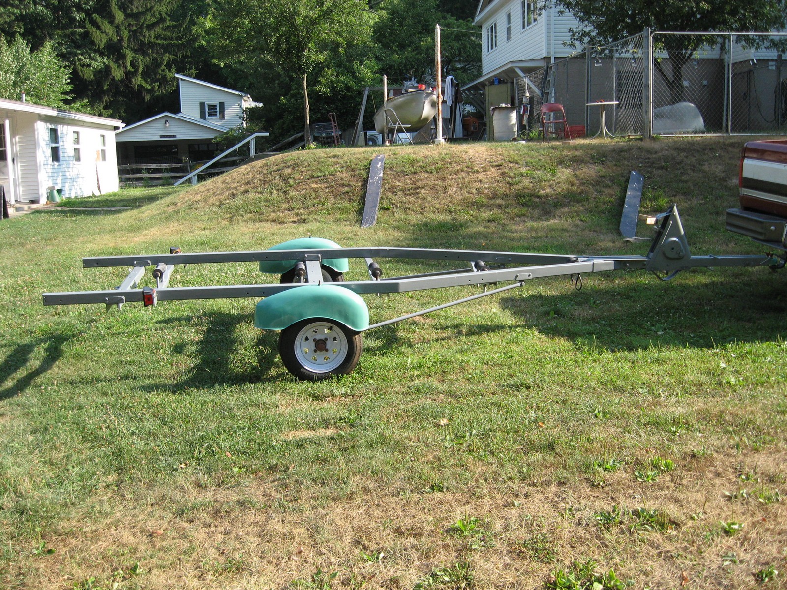

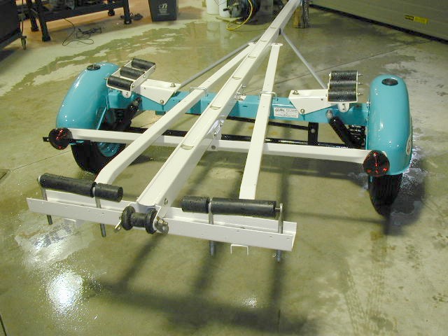

I believe the only light bar option offered is the one on my aqua colored Tee Nee. Seems to be a fairly rare option.
Hope this is helpful!
