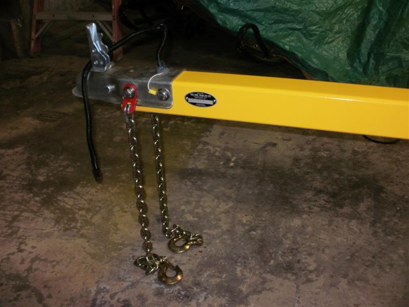

On most I have re-chained I drilled a hole clear through the tube watching got the wires. I used a 1/2 inch grade 8 bolt with washers and lock washers and bolted it on. My Tee Nee had these neat brackets already. Use a heavy enough link to do the job. Don't scrimp here.

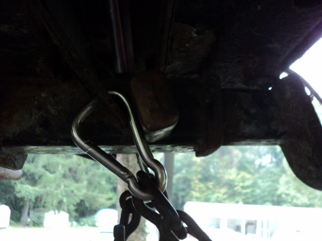

I have a small trailer that like yours has one chain. But it is long enough that I loop it through the hitch and back to the trailer and secure it with a closing quicklink. I like the quicklinks rather than a hook. Anyway this way the single chain becomes doubled. Of course it does not solve the problem of how to cross the chains.

I used quick links at the trailer and these hooks I use on the truck. They can be changed from chain to chain in seconds. I left the s hooks on for now. I don't use them.

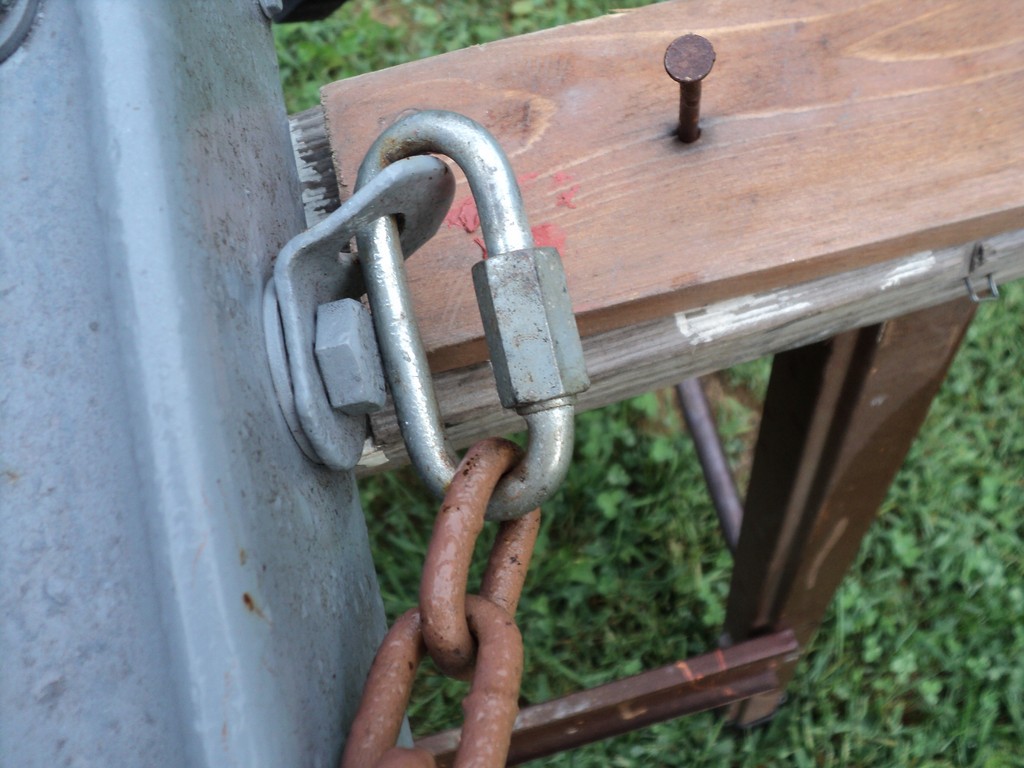

I got some heavy chain from a local Hardware store and added some snap hooks with quick links - don't need stainless or galvanized in my opinion. Never had to back a trailer down into the water so far the chains got wet ?
Re:Trailer Chains 14 years 2 months ago #68064
Every non-stainless chain I have ever had on a boat trailer rusts eventually. It doesn't need to be backed all that way down in the water, or at least I have never had that experience. I like my stuff to look nice, but do whatever you like.

I like those metal tabs on Roberts and bhamrick's trailers. I always though the bolt shouldn't go through the links, but I don't know why.
