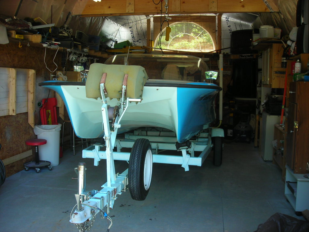

We are trying to set up our trailer so we can go and pick up 1964 Johnson Deluxe . So here are the question"s" . Whats the best way to set up the trailer . whats the chine on the boat . Do we have to support the sponsons or just the middle keel . Basically we have no clue . So any and all help is greatly appreciated
Re:help with trailer 14 years 2 months ago #67890
welcome bethiany,here is a pic of the tee nee trailer under my custom craft devil ray,it is a little like your johnson boat,in that it also has a tunnel,i got it this way and havent gotten to fix it up yet.john sorry that pic isnt so good i will look for better pics,john you can click on the pic 2 times too make it bigger,when im done it will also have support under the sponsons.

here you are ,a picture of a OMC trailer,i hope this helps,john
