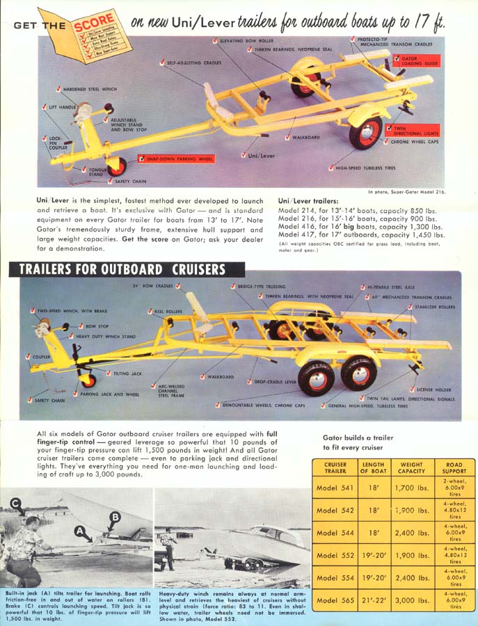

Thought you might find the atached original brochure sheet for your trailer of interest,
Again, thanks for the help,
Matthew

Thanks... Nice to see how it is 'supposed' to look. I guess I'm not that far off, although it looks like I have to repaint my winch :)
I saw those 'drop down' front parking wheels on some of the trailers at the show I was at this weekend, and like an idiot I didn't take a photo of them & how they worked! I'd love to replace the ugly modern galvanized one that I've got with one of those...
-Andrew
