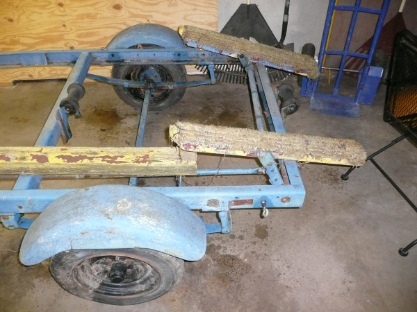

I've got either a 59 or 60 (don't think it is newer than that) Gator trailer that I am ripping apart and rebuilding. I've got a number of questions since it was repainted twice and is no longer original color.
First up is the year? I know it isn't a '58 since that had a tubular frame. I have a '60 catalog and it matches but they are only drawings and no real pictures in there. I couldn't find anything online for '59. here is the model number that is on the frame: W-214-40 I'm guessing '60.

In the second picture of my original post: The rear bunks are on a rotating bar and that bar has a bend in it. I'm assuming that is supposed to be straight? I'm guessing it got bent at some point over its life. The bend is on the left side (closest to camera)
I'm wondering if it is best left alone or fixed. It would essentially make the left bunk a little crooked.
thoughts?
