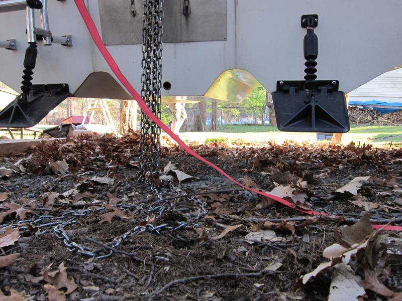

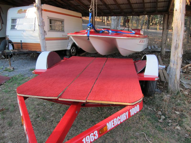

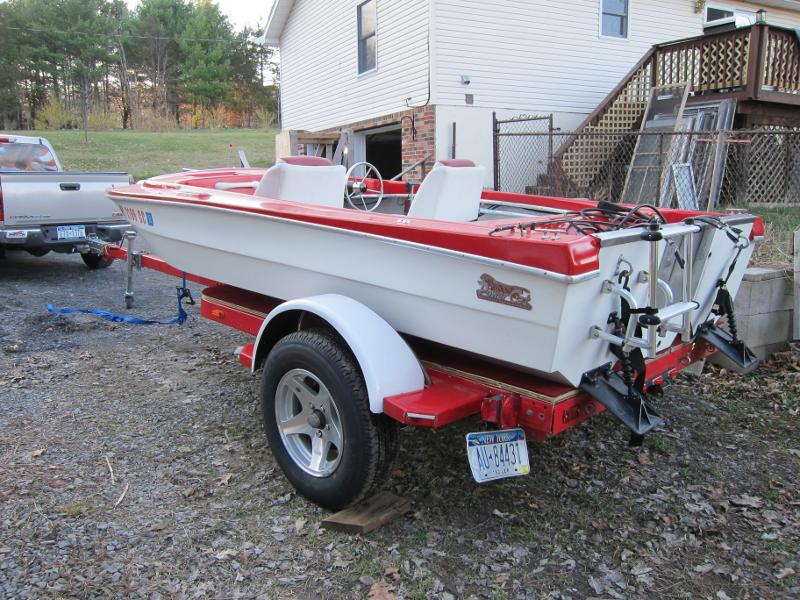

Thanks bob. Got it trimmed last night, and got the 14T back on it. By the time I was done, we ordered pizza out (first time I've done that in ages!), and crashed. Here's some pics of it trimmed and how I got the boat back on it. No big deal really, just need a couple chain hoists.
Boat is filthy, so tonight is cleaning time, and then I need to mount the jack plate on the motor, move the motor up to the boat and figure where the jack plate mounts with the cavitiation plate 2" below the hull. More fun!
For the trailer, I need to make new fender backs because the old ones don't fit anymore since I moved the fenders up to accomodate the larger diameter tires (went from 14 to 15"), need to mount the winch post, and need to mount a chain on the trailer tongue to an eye bolt to hold the bow eye back like I did on the other tongue I had. This 3-4' longer tongue will also allow me to mount the spare on top instead of to the side. I think it's all gonna work out just fine, just more time & $.
Frank
