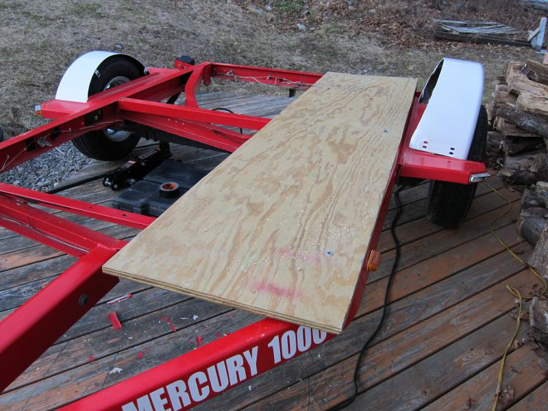

Thanks guys. Finished up tonight, got 3/16 i.d. tubing protecting wherever the line might rub against metal. I cut the tubing to length, split it with a razor, and taped the ends so it won't slide.

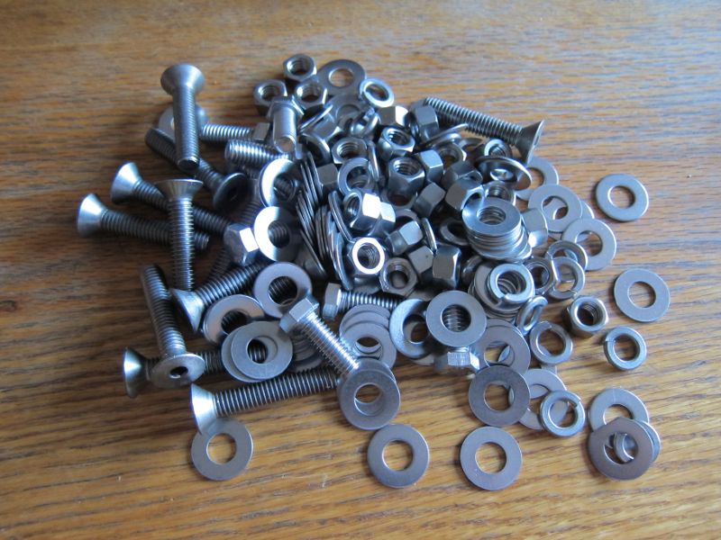

I started putting on my new deck tonight, plus am changing over to all stainless for everything that doesn't need to be steel. I'm using flat head stainless 3/8 bolts to hold the plywood down, but didn't have a big enough countersink (have a 5/8" one, need a 3/4" one) for the heads, so will pick one up tomorrow and finish tomorrow night. Instead of making a full deck, I am just using one piece of plywood cut in 1/2 lengthwise and will not support the center hull. I hope that's okay, but if not I could re-do it if necessary.
