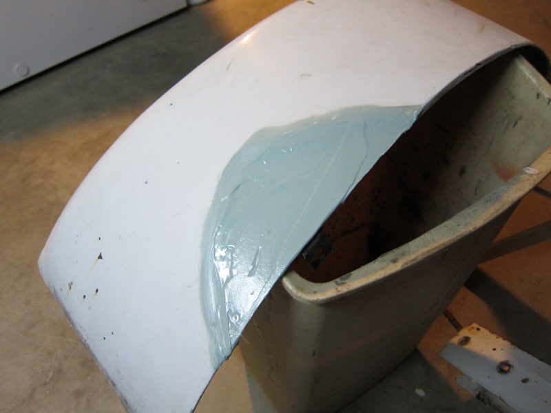

Got a problem with my left side fender from the tire blow out back in August. You can see here how the mounting lip got bent back, and the fender is way out of round where it meets the plywood...
Here you can see the effect the tire blow out had on this fender's bondo. Took a long time to build that bondo up!
I got the damaged lip mostly fixed, but am not sure what to do with the bondo. I wonder if I could build a wooden buck using the other good fender for pounding this bad one into better shape? Eventually I want to get new fenders, they're just pricey.

Fender work 14 years 10 months ago #53600
I wimped out. Sanded it so it was well faired, then applied the first of many, many coats of bondo.

Body fill almost done on that damaged fender too. Couple more minor coats and sanding, then paint.

Fender is done... 14 years 10 months ago #53773
First coat of paint, more to come, but looks good. Not much body fill, mostly time, but not even much of that, just spread out. Brake assemblies, line kit and new wheel/tire will be in Friday.

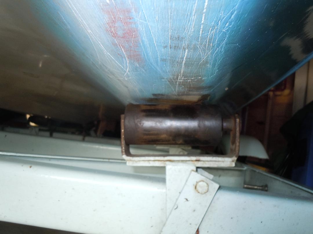

FRANK, flat rollers are those with no groove in them. there are 4 of them at the end of the trailer. i think 3/8ths diameter hole and about 8" long.
Re:More trailer work 14 years 10 months ago #53795
MarkS wrote:
Your "thru-bolts" 1/2" diameter Ron? You can use the 5/8" rollers, just put a piece of 1/2" ID copper pipe over the bolts between the brackets, like a sleeve bushing. It'll take up the difference on the bigger bore rollers. This place has them in 12" lengths, you can cut them into shorter lengths and get two or three out of each one!
www.easternmarine.com/2-1-2-x-12-stoltz-straight-trailer-roller-rp-212
Or you can save a little money, buy four at a time:
(Sorry to butt in Frank, I didn't mean to be rude.) ;) Congrats on the Etrailer deal, that would be very cool!
mark, they're not bolts..they're pins, 3/8ths i think with cotter pins at the end. will measure roller diameter tomorrow.
Re:More trailer work 14 years 10 months ago #53797
Okay, I get the "flat" roller now Ron, thanks. As you know, I am NOT into rollers, and really don't know much about them. Having said that, I bet I could find rollers for you (and have fun doing it) if I knew exactly what it was you needed!

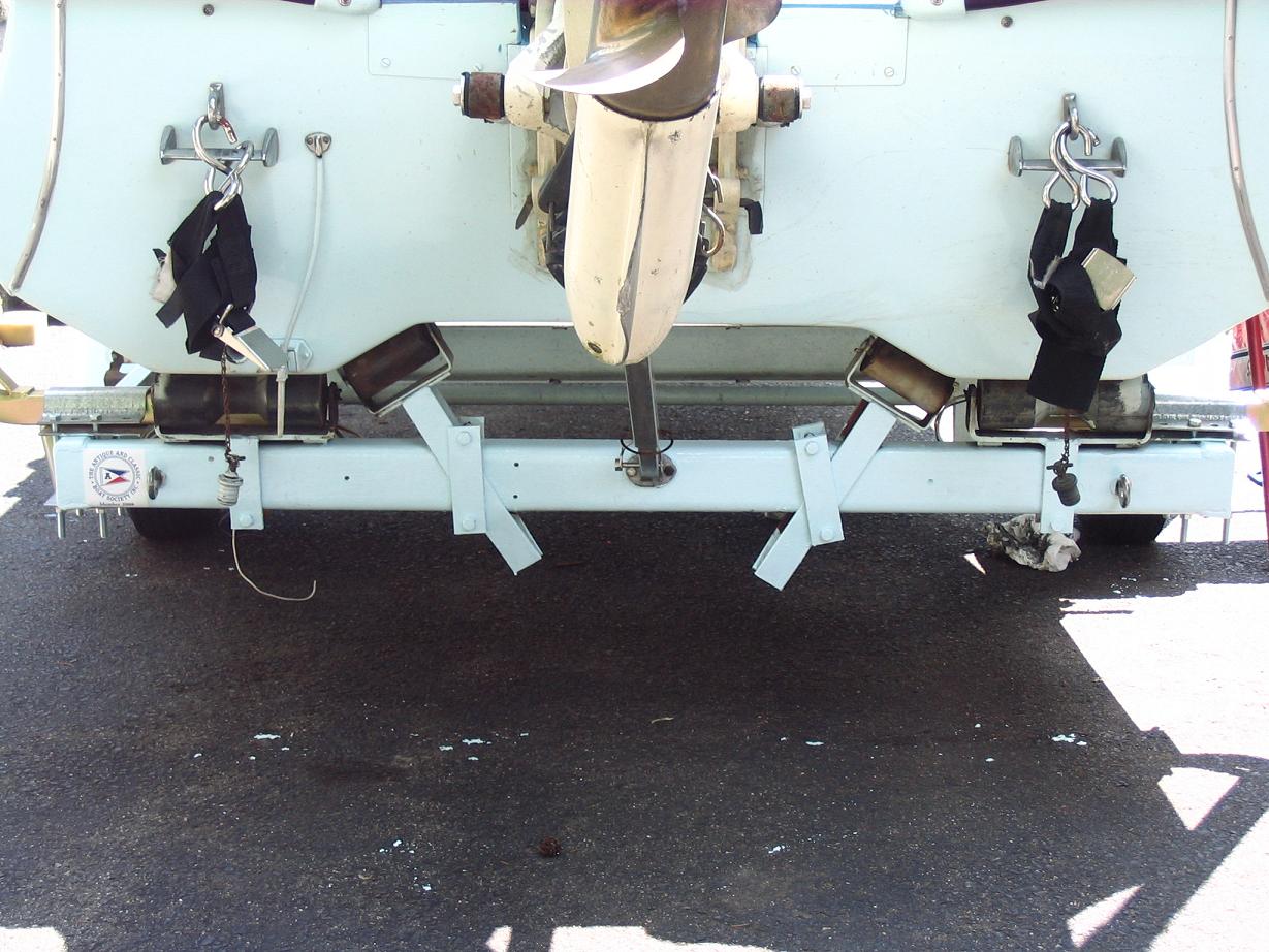

Re:More trailer work 14 years 10 months ago #53807

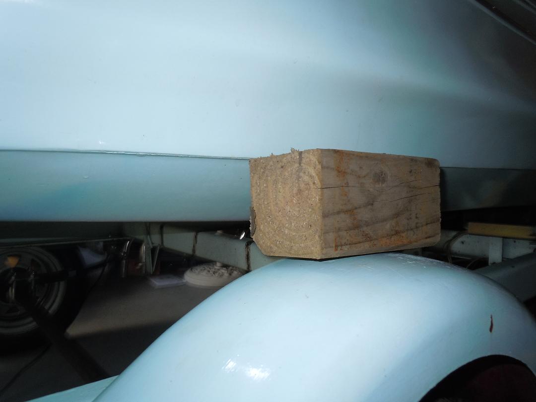

frank, i was considering scrapping the rollers for a flat platform as you suggested, but after installing the new springs the fenders are about 4" higher and although i didn't measure it my eyes tell me that the step won't clear the fenders. i'll get you roller measurements tomorrow with pics. ron
Re:More trailer work 14 years 10 months ago #53842
Look good Frank, Bondo was the way to go if you plan to replace. If ya have a torch, heat shrinking is best if your not going to replace it.
not to jack the thread.
Ron, those Stolts rollers are the way to go. I tried the flat rollers and did not like. Every surface on the bottom of a MR has an angle. The flat ones only touched the hull in 1 small spot. Check out my thread www.fiberglassics.com/glassic-forums/13-trailer-talk/13737-snowco-trailer.html Did a test launch before unloading. As soon as the water started to support the transom off it rolled. Loading was just as easy, dry foot even with the short tounge.

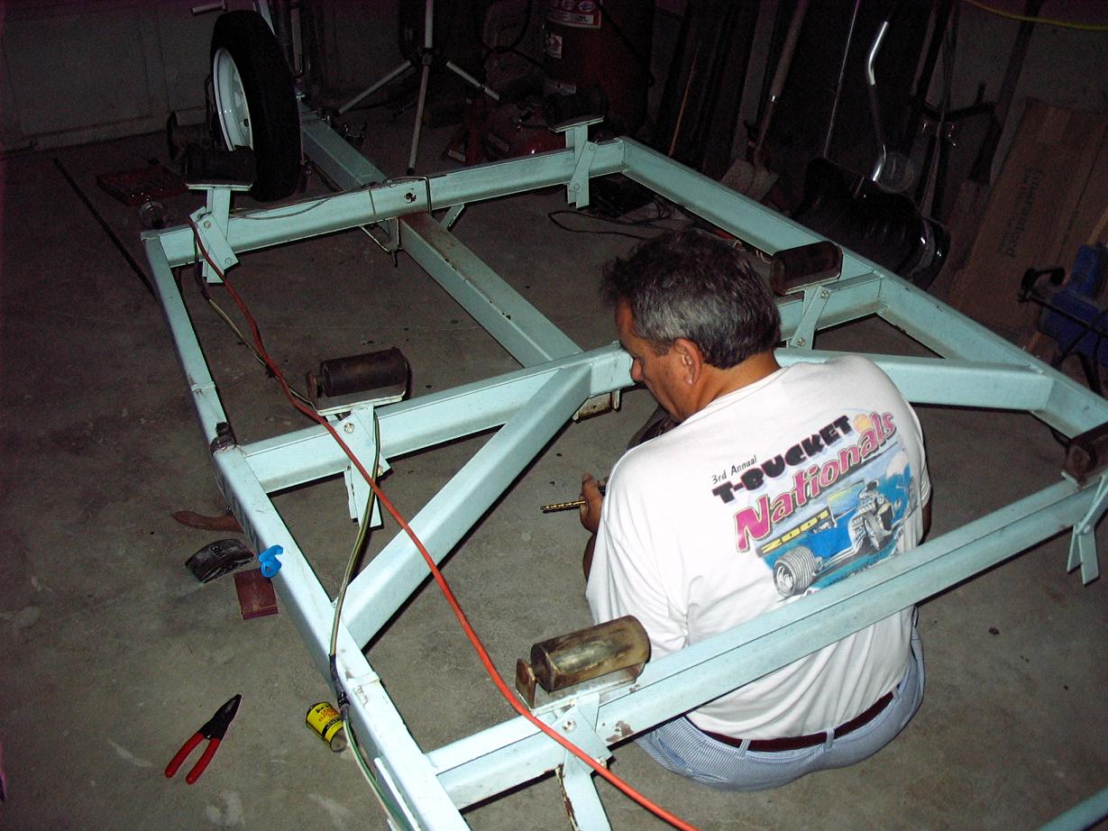

Re:More trailer work 14 years 10 months ago #53871

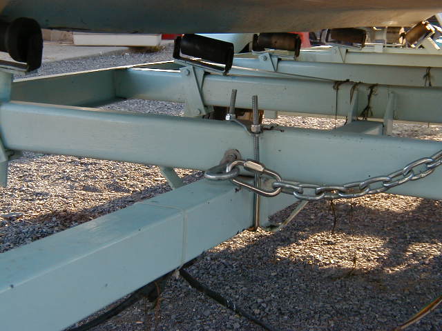

took measurements of the rollers...the 2 front ones are 5"lx3"dia. with a 1/2" or 5/8ths hole. " :
the 6 midship rollers are 5"lx2" dia. : : :
the 4 rear rollers all flat are..outer ones 8"lx3"dia.
inner angled ones are 4"lx2" dia.:that pic is earlier in this thread." :
as you can see my fenders now sit about 4" higher with the new springs. i placed a piece of 4x4 on top of the fender to show how much lower the boat would sit if placed on a flat platform in place of the rollers. the boat would definetly rub on the fenders. : :
now i realize that the steel frame can be built up but i would not want to tackle that. also now that the trailer sits higher i just hope i can launch it with the malibu without burying the exhaust pipes in the water.
Re:More trailer work 14 years 10 months ago #53872

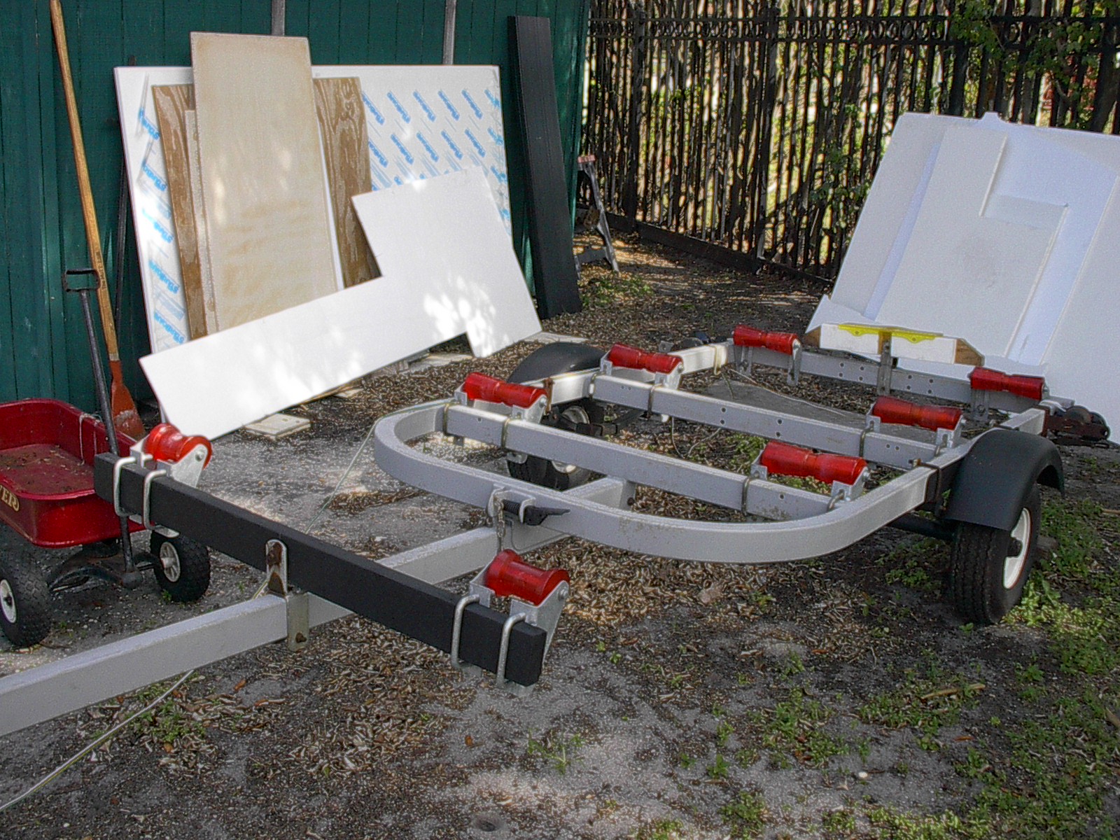

I do have a transom pad and I love it. It never comes in contact with the boat until I pull it out of the water. It does have weight on it. When my winch line broke last year that was in fact what stopped my boat from coming off. I was on what most of you would call a very steep ramp. I does keep that boat from moving.
Re:More trailer work 14 years 10 months ago #53928
Like Frank said it helps center the boat when loading. The final bunks will be made of PVC and have 2 pads per bunk, 90sq.in pad surface. I'll add 2 more between the next 2 sets of rollers going forward. These 2 are more for my piece of mind when I need to work in the boat while on the trailer. The pads were labeled Transom Pads on the shelf, they're made of a soft matterial like the rollers and grips well with a little cusion. I see a lot of boats with a pair of these replacing the aft keel roller on V hulls. Like Robert pointed out it supports the heaviest spot, under the engine. When I test launched I left a little slack in the winch strap and the boat did not move while backing down the ramp. The flat rollers did not allow the front sponson to clear the fenders. Now it rolls right over the fenders as soon as the water supports the transom.
I always thought keel rollers and bunks were the best way to go. Traditional bunks would be a bear on a MR and this is what I came up with that was easy.

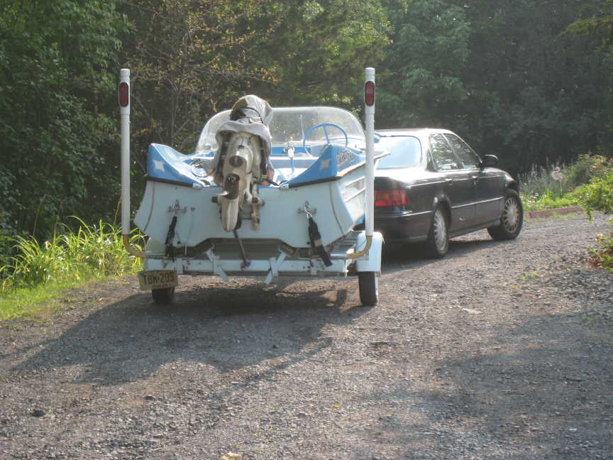

i had the same problem centering the mr when loading. then i purchased led pipe lites. that solved that problem. frank installed them and re-wired my trailer. :
