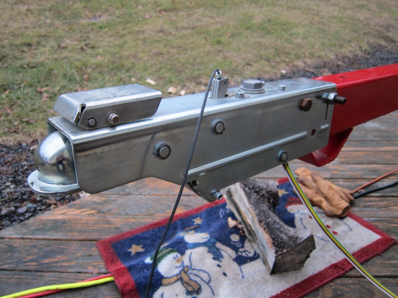

Got the coupler mounted this a.m., and it was not just a quick bolt-on. It looked like the old trailer tongue (which from the factory had a hydraulic coupler mounted) and new coupler holes matched up, but they were off an 1/8" top-to-bottom. I started by drilling out the first of the four holes, but it made me nervous making holes big enough to pass bolts through, so I did the others with a carbide tip grinder just at the top of the holes, and just enough to get bolts through. Mama went out shopping, and has instructions to get me some grade 5 1/2 X 4" bolts, nuts and lock washers.
Then I was looking at the best way to run new wire. The old tongue was 8' and this original one is 11', so I had to run new wire. I left plenty up front to make it so it reaches the truck plug with no problem. I was thinking of running it through the bottom of the coupler, but then figured I didn't want wires messing up anything with the braking components. I'll just run it from the end of the tongue I guess.
Next I'm going to pull a wheel and make darn sure it's a 4.5" bolt pattern before I go ordering new aluminum wheels. I also need to do some body work on one fender and do some re-wiring on that same fender from when my tire blew out and took out lights on that side.
Happy New Year all. I sure hope 2012 is a better year for boating!
Frank
Re:Need help with brake terminology 14 years 10 months ago #53524
Lookin' pretty darn good there Frank, nice work. Happy New Year to you, and all our FG friends!

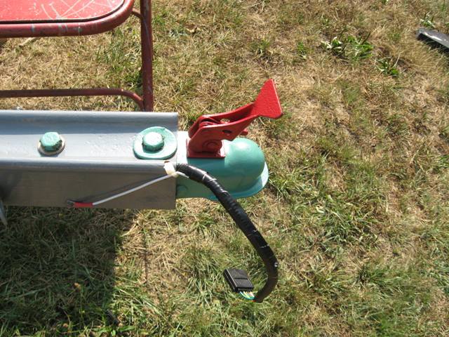

Re:Need help with brake terminology 14 years 10 months ago #53547
Looks great. I don't know what is going on inside there myself so your running wires the safe way. I'd enclose them with flexible wire conduit. Here is how I did mine but I have no brakes to worry about.
