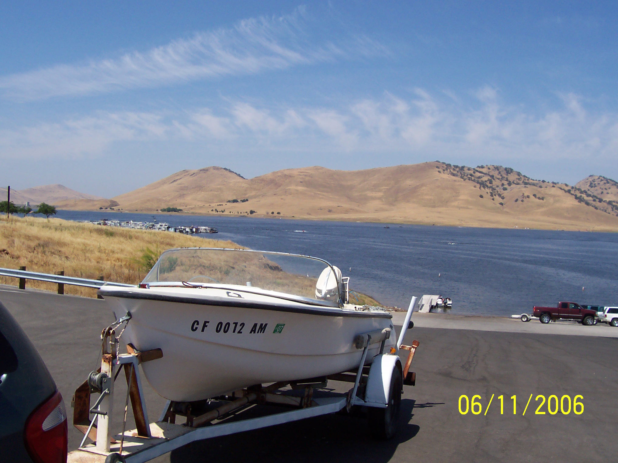

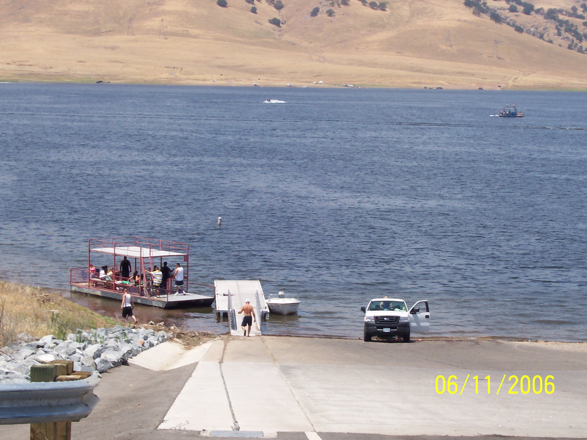

My Town and Country says 3699 lbs not to exceed I think it was 500lbs tongue weight and recomends an equalizer hitch over 1000 lbs. wrong picture but look at the long ramp.
