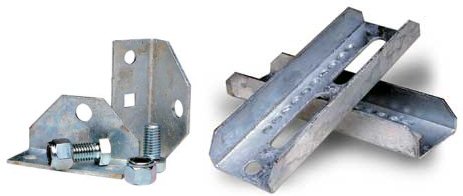

West Marine item 391278

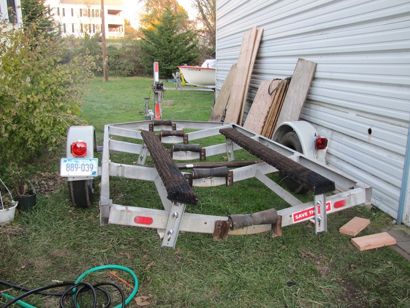

After way too much time and effort, I got the bunks installed on the trailer. I used the existing vertical brackets with the T bracket on top. The core of the bunk is a 2x6, bolted to the bracket with 3/8" galv counter sunk bolts. The carpet came from a 5x8 rug that I bought for $20 at a local discount store. It is attached with 1" bronze ring nails (been gathering dust in my garage for the last 12 years or so.) That should work.
Had to replace a lot of bolts as what was there was too rusted to reuse. Moved the axle two notches forward. Now I have to reposition the lights and add amber side lights and the 3 small lights in the middle. Then it should be ready for inspection.

Excellent Todd, that came out great and should work out perfect. I like the keel rollers too, of course I'm biased, my trailer is set up the same way only my bunks are much shorter in length.
That should serve you just fine.
Re:"T" shaped trailer bunks 15 years 3 days ago #49543
Looks like it turned out well Todd, nice work. You can always add another set of upright supports in the middle of the bunks, if it looks like you need them after the boat is on there a while. I always try to install new hardware (if it's in the budget) when doing a project like this, good call.
