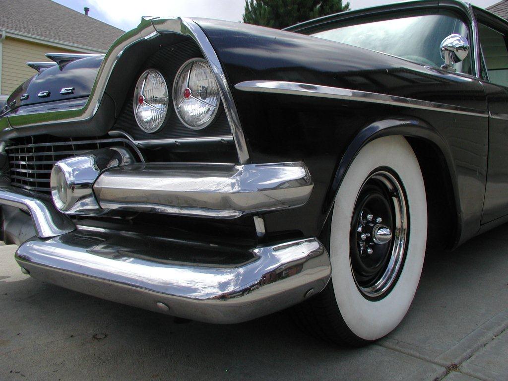

I had pretty good luck painting them, I did this on my 58 Coronet
bought the paint off E-Bay.This pic is when they were only 2 weeks old ,they darkened a bit, but not bad,,2 years now.I just bought a set of used tire from a tire dealer in town,.155 sr 12`s .they look almost new and at $20.00 each I cany loose.

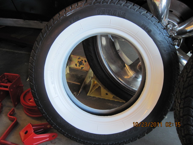

This is how mine looks- Not the best pic, I wasn't focusing on the tires-
I went the 'ultra cheap' route on the trailer tires... They were new tires, from Wal-Mart. I scrubbed the piss out of them, to get them good and clean, and then I painted them (after masking, of course!) with 4 coats of Flat white spray enamel, the stuff they sell at wally world for .98 a can. I didn't know if it would work or not, but it did. It darkened a little bit, but not too bad. It's also really hard to scuff or scratch. After 2 years, it still looks fine, and I think it really looks good on there!!
