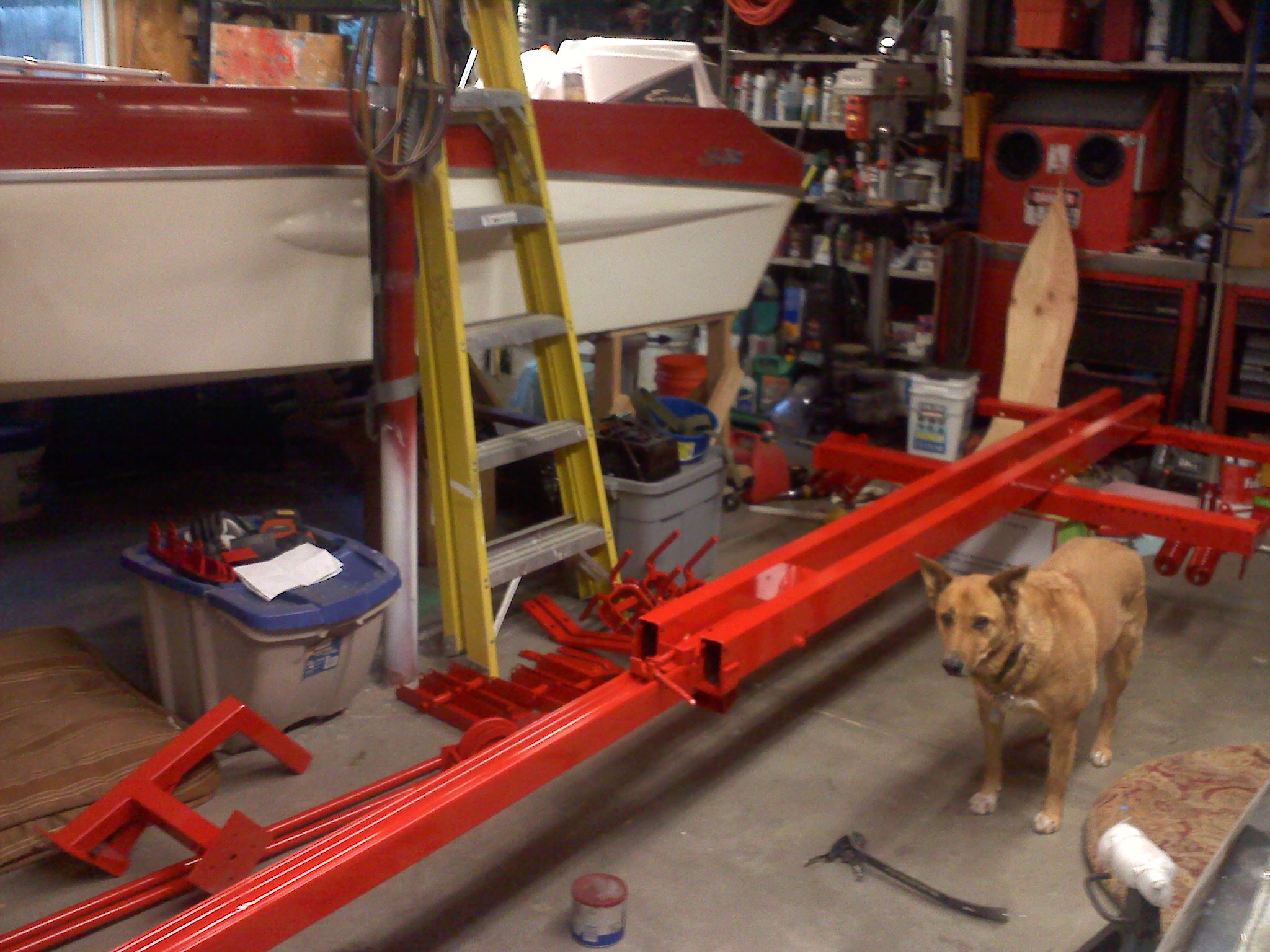

OK I tore her all down, fix a few shaddy additions made by the previous owner.i added a spare tire mount, ordered all new rollers.
It all went to the powder coaters this morning !!
Will be needing new tires and zi will be doing sometihing differ4ent
with the tail lights.Think I will mount them to the vert roller arms,Better visability and keep them dry !!
I upgraded the reciever to a 2" now all my toys have the same Ball.
I am doing it all in red to match the boat`s upper !
I am looking for some baby moons ,and white walls,I mat have to make my own !!12" tires not much of a choice out there ??

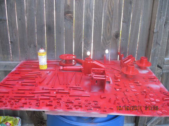

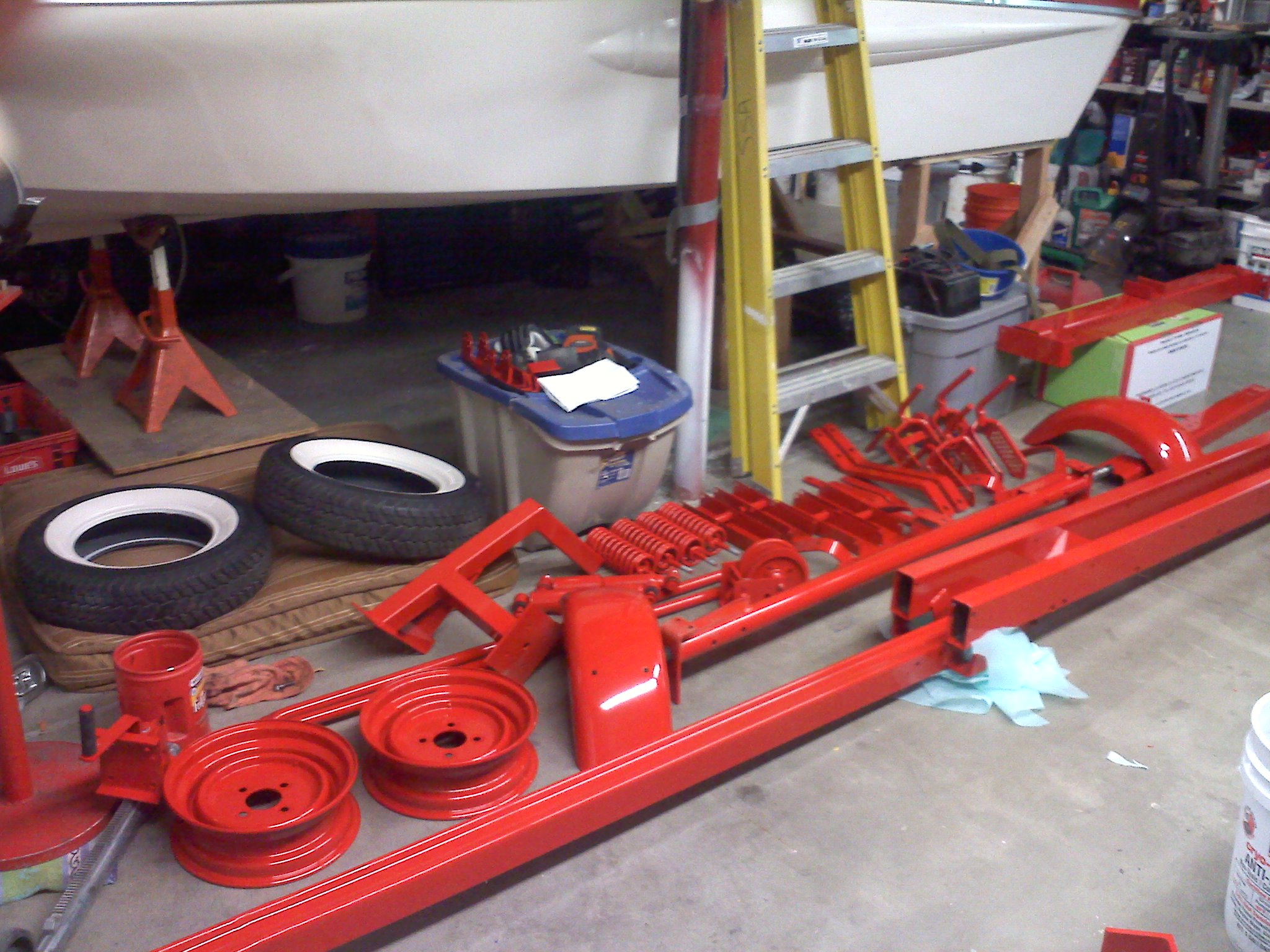

OK a little progress, I cleaned and painted all the hardware, to match the trailer,,,when I get it back ??
I bought a set of used 12" tires, almost new 155 sr 12`s for cheap.
I will be painting white walls on them today.And I will try to secure a strap type hook to my rope winch..

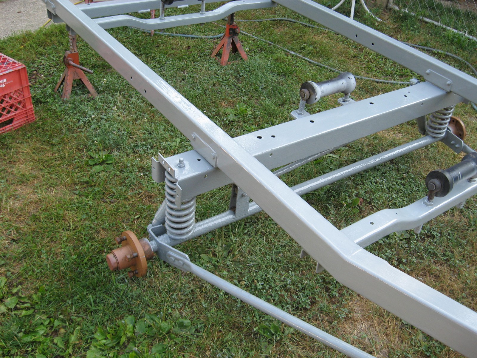

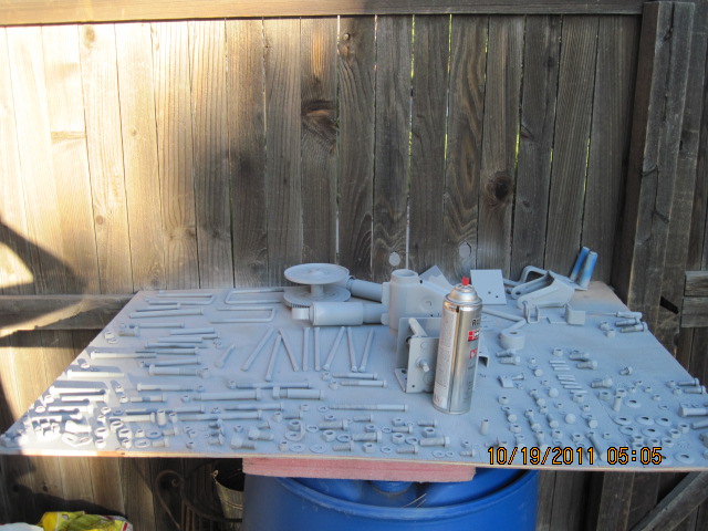

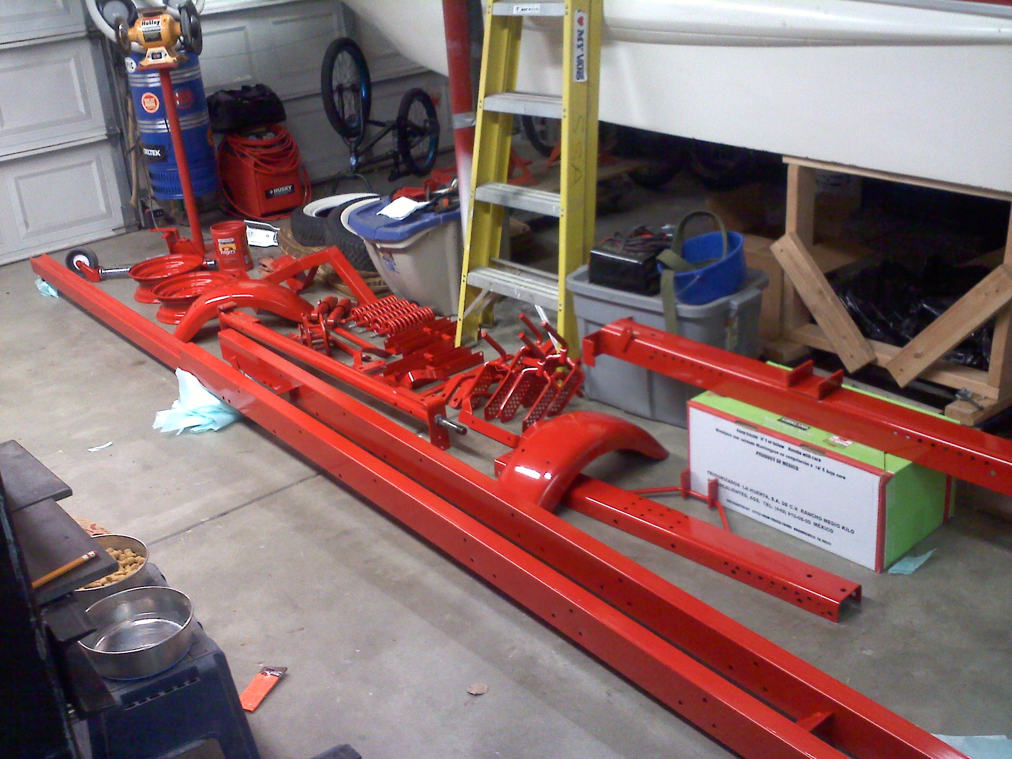

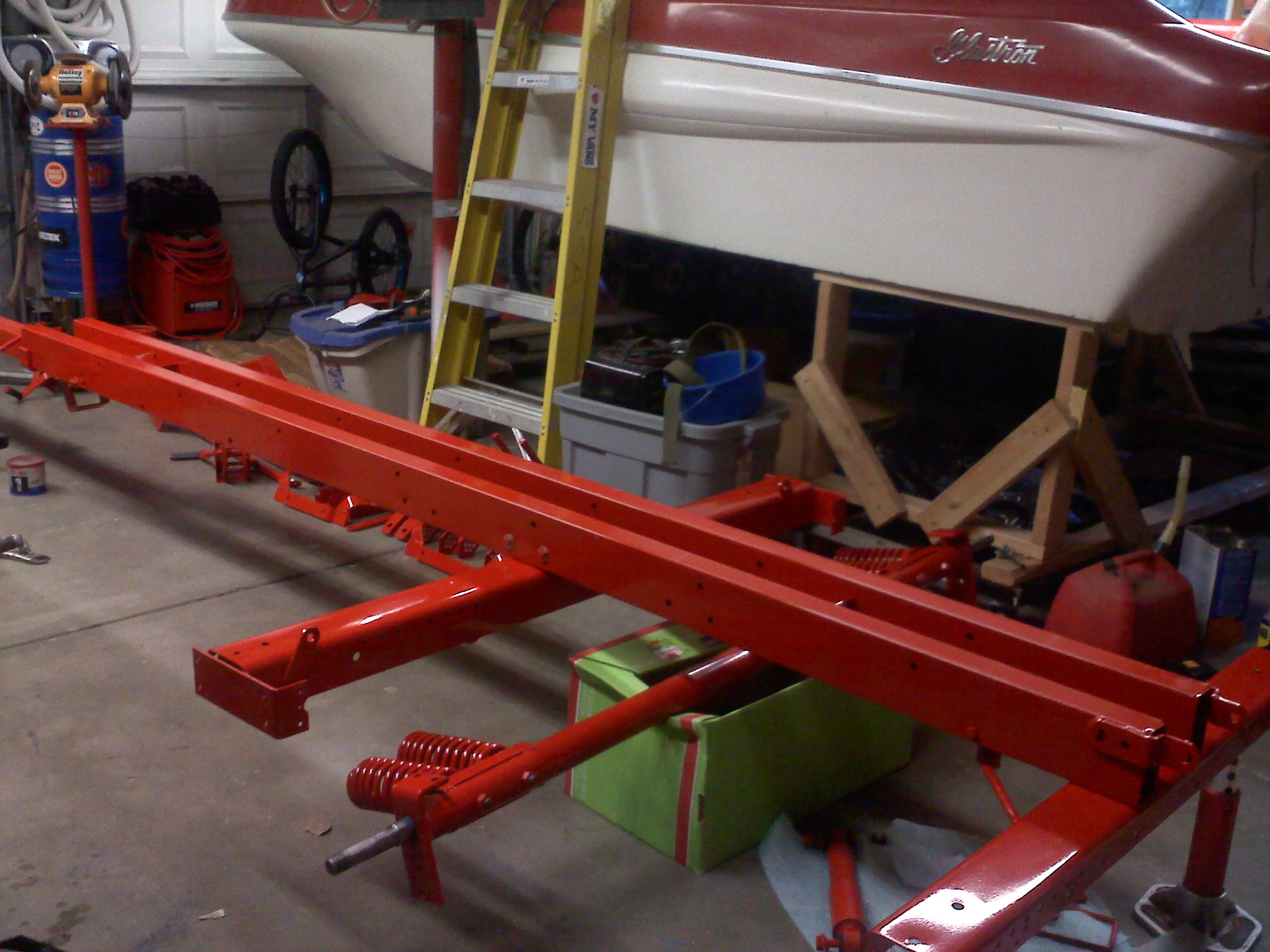

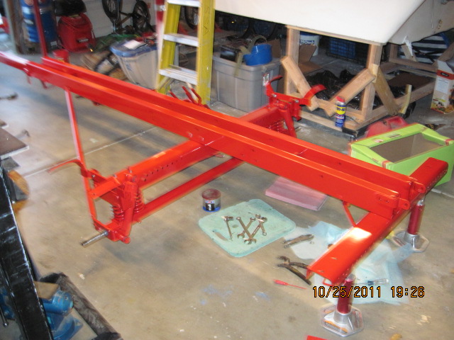

OK update ....
I picked up the parts from the powder coaters yesterday,And dropped off my 2 gas tanks and a spare rim to coat as well.
Last nite I started to reassemble the trailer..No surprises yet ???

looks great, I like the assembly part of the job with all new clean painted parts.
I got the original Holsclaw hubcaps for mine, 3 of them newly powder coated...Im done
Re:Rebuilding my Holsclaw 15 years 4 weeks ago #48378
Looks like a shinny new "Build you own Holsclaw" kit, SWEET!
Re:Rebuilding my Holsclaw 15 years 4 weeks ago #48379

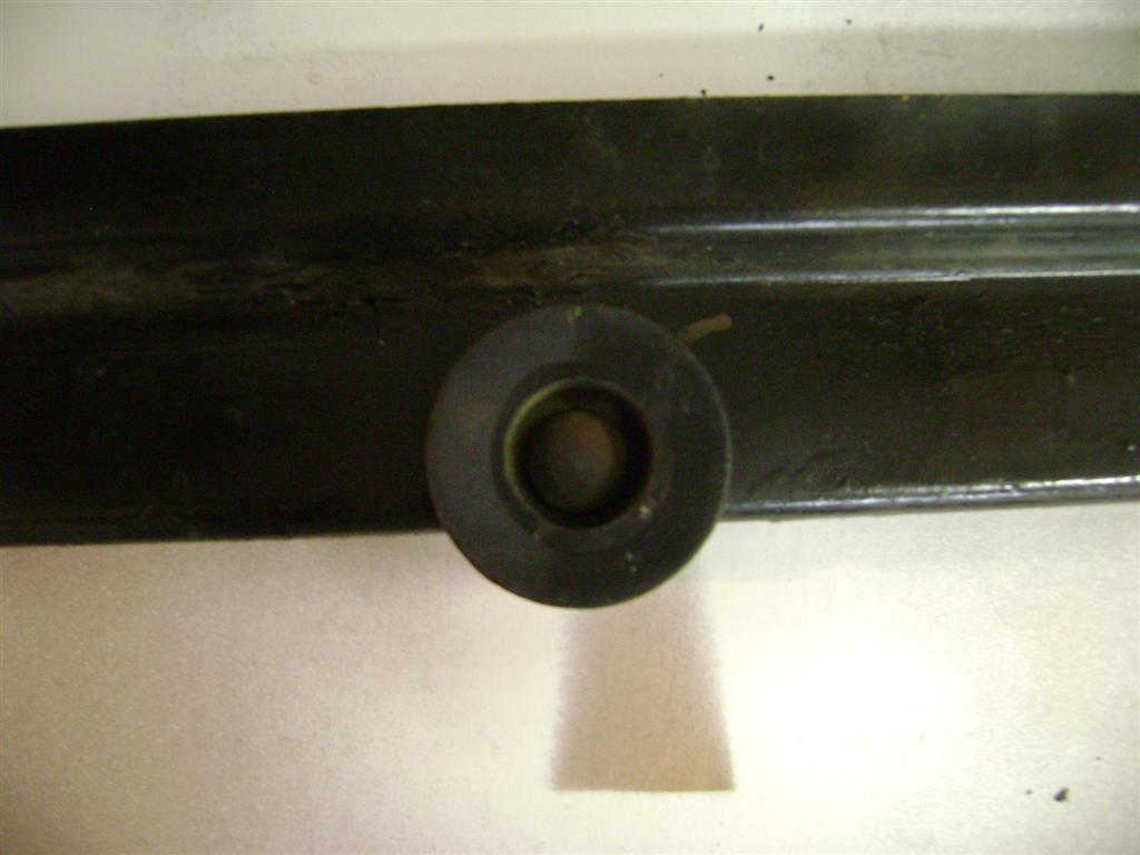

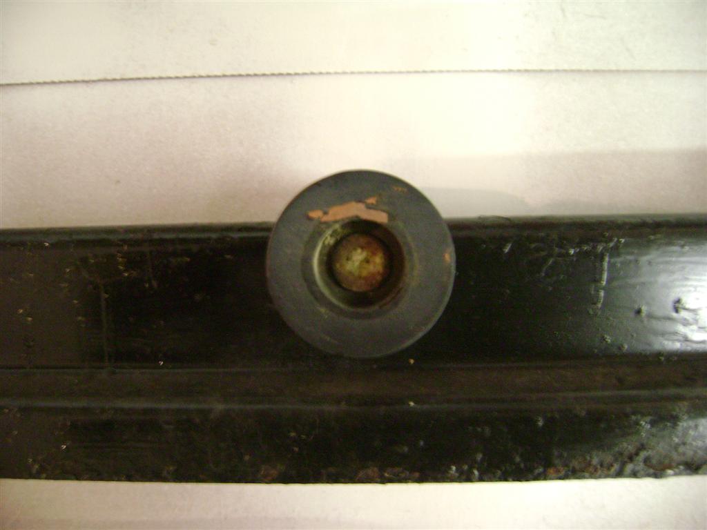

I'm still trying to figure out how to get the original pins out of the rollers. Nothing I've tried so far works, and I need to get it figured out soon!
Frank
Re:Rebuilding my Holsclaw 15 years 4 weeks ago #48382
Are you talking about the bunk rollers, Frank? One end looks like a carriage bolt head (rounded), and the other is like a rivet peened over all around? Drilling the peen off is the only solution I can come up with on those.

Re:Rebuilding my Holsclaw 15 years 4 weeks ago #48396
Yes Mark, the bunk rollers. I guess I need a bigger drill bit. I tried one that I thought might be too big, and it didn't work. I'll get back at it soon. Thanks!
Frank

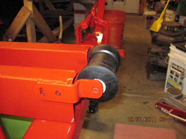

I was able the drive them all out !!
I bought all new rollers. Most are not the same size , but I will make them work !! I will post updates on that portion of the rebuild !!
A few more pictures of some progress last nite > WOW my dog looks posessed in that last picture !@#$
Re:Rebuilding my Holsclaw 15 years 4 weeks ago #48511
He sure does! Better be nice to him and treat him right. :laugh:
Frank
I heated mine and drove them out with hammer and round chisel

As far as the source I will have to look it up ?
For the Keel rollers, I bought some that require some modifications.
I need to sand about .25" off and replace the shaft with a .5" bar
and secure them with thoes little "hat" caps
As far as the other rollers, I am considering using boards for the sides instead of the original rollers.
the rear roller will work , I just need to replace the shaft with a 5/8" bar.

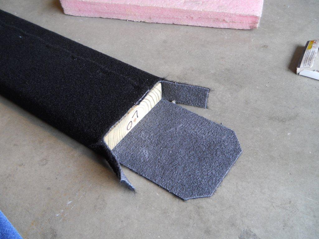

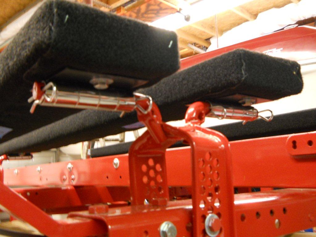

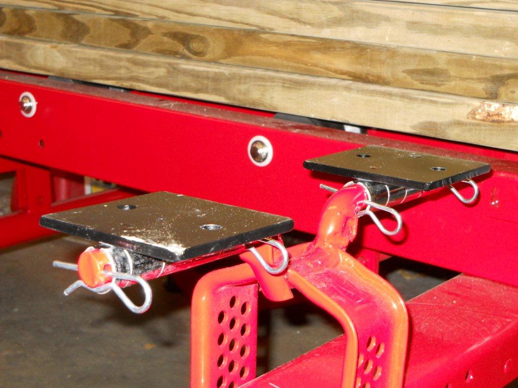

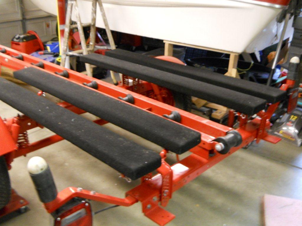

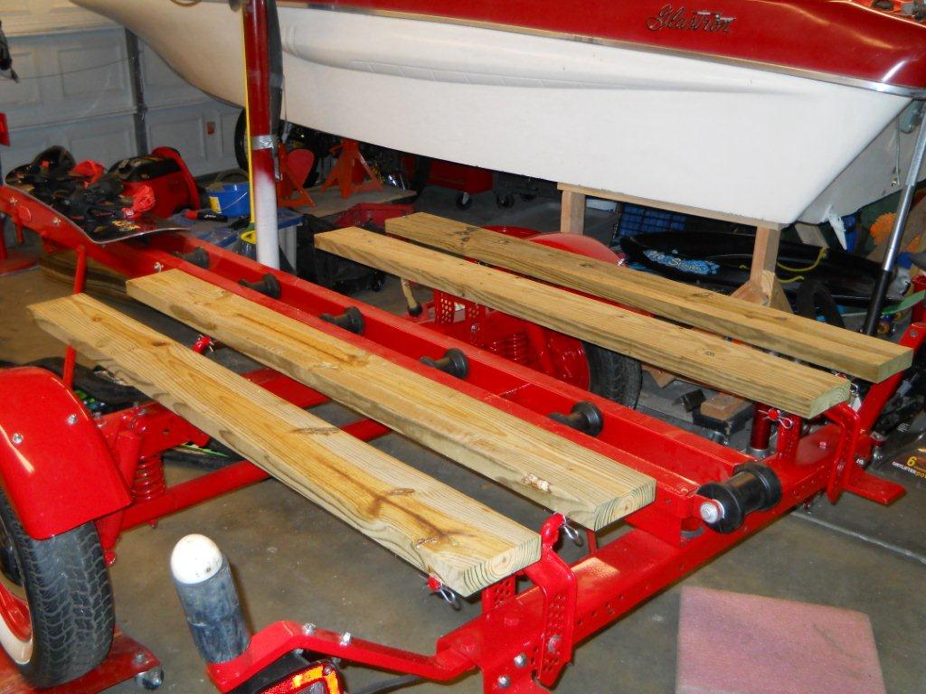

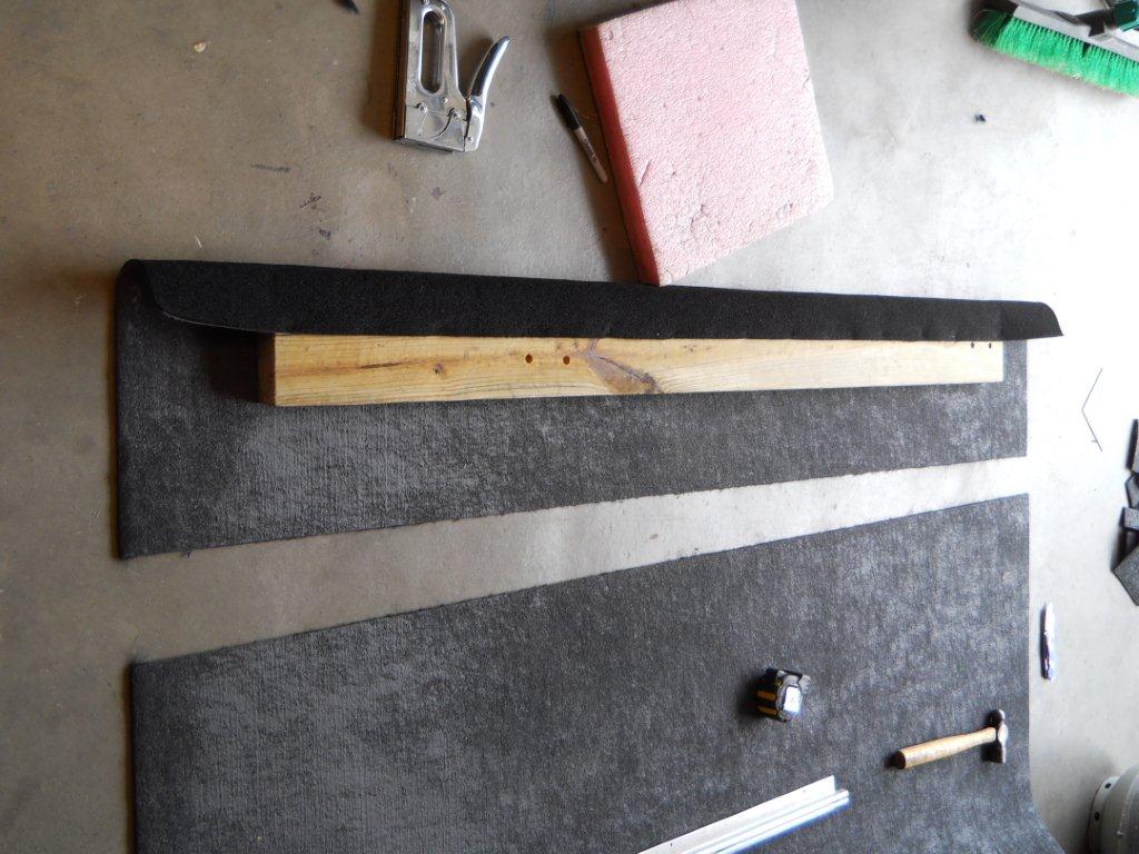

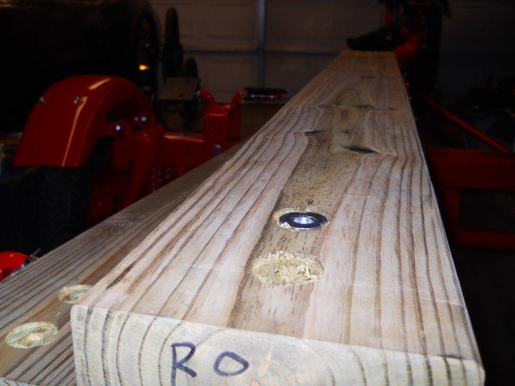

OK I got some work done this weekend,I installed my bunkboars on my roller brakets.
I have a few pictures of the precedure,if anyone is interested.
Or if someone has concerns, please let me know..
Re:Rebuilding my Holsclaw 14 years 10 months ago #54544
Really sharp looking job you have done there. I like how you mounted your bunks, really looks first class and should last for years. Nice color also, just kinda jumps out and grabs you. Keep up the good work and keep us posted. Skip.
Re:Rebuilding my Holsclaw 14 years 10 months ago #54548
Really nice work Fantm, looks great. Did you fabricate those bunk board brackets (the black part)? I like the way they turned out, at any rate!
Re:Rebuilding my Holsclaw 14 years 10 months ago #54552
  • FANTM58
  • FANTM58's Avatar Topic Author
  • Junior Boarder
  • Junior Boarder
  • Posts: 130
  • Karma: 3
Thanks guys,
And yes I used 4x4x.25" plates and some old shelving legs.I
drilled 2 .25" holes over the tubing and then mig welded then in.
