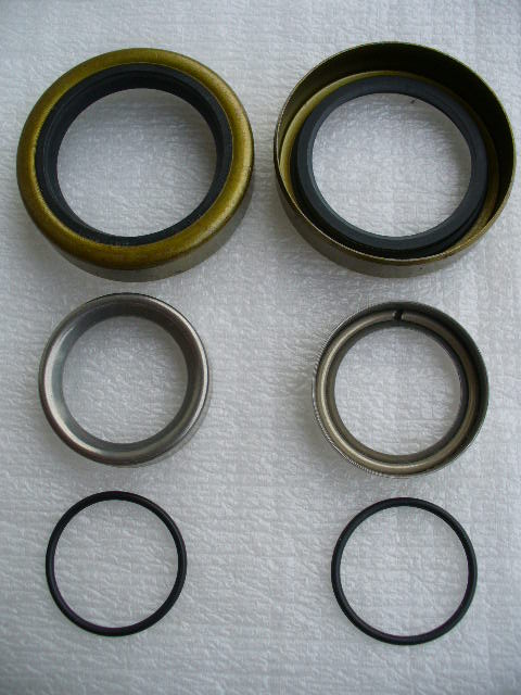

As to the bearings, I cannot add much except to do buy a bearing kit. We can sell these (the last time I remember dealing with them) for $12 to $15 (two bearings, two races, grease seal, and cotter pin).
I think highly of speedi sleeves, but we prefer a spindo seal kit for boat trailer axles (1 inch axle kit shown). These are $14 or so; and include two stainless steel rings which slip over the axle spindle's worn and/or rusty grease seal contact area, two o-rings to help seal these to the spindle, and two high quality sping-loaded grease seals. We strongly prefer to install these when installing bearing buddies, to yield an axle that is almost always trouble free. Bearing buddies for the most part get a bad rap from poor condition spindle seal sealing areas, or over greasing (they are designed with a spring to allow for expansion and contraction of the grease, but we see the grease level so full that the spring loaded piston in the bearing buddy is at or near it's stop, so when the grease expands, it pushes out the seal area in back, or forces the bearing buddy off of the hub front). Also note that these spindo seal rings slip on, and do not have to do driven or pressed on, as they are far thicker stainless and do not rely on the spindle for part of the strength.
Regards,
Joe
