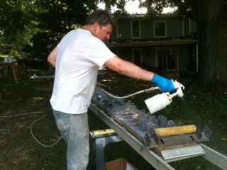

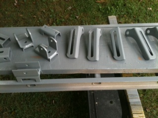

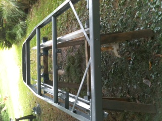

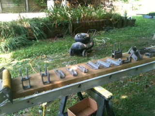

I got the Gator sand blasted Wednesday and primed it Friday with U-Tech E380 epoxy primer. The spec sheet says that you can recoat wet on wet after 15 mins. so we figured to get 3 coats on one side and then flip everything over and get 3 coats on the other side. That all went great. The unthinned primer flowed well and even had a certain amount of gap filling qualities. So far life is good.
Now here's the part you need to pay attention to. The 2 of us completely spaced on the fact that epoxy primer has EPOXY in it and that EPOXY quite often acts like GLUE.
Where we blew it was when we flipped the parts over we sat the parts down on the spray boards that had 3 coats of EPOXY already sprayed on them. What we should have done was flip them on to Clean spray boards so as not to have wet epoxy primed boards coming in contact with wet epoxy primed parts. Pretty much every single part was stuck to some degree or another. It wasn't a complete disaster in that some of the parts pulled the primer off the boards but where the boards pulled the primer off the parts I'm gonna have some stupid-ass touchup to do.
