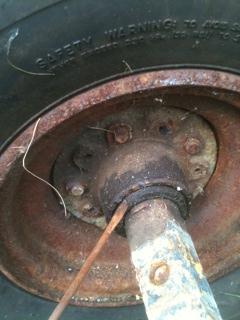

Hi All, I'm just about done stripping the trailer down for sandblasting and came across this peculiarity at the axle. In the jpeg I have my screwdriver pointing at what I think is the wheel bearing (if in fact it's not the bearing I am going to refer to it as such for discussion purposes). You'll also notice the square tube axle going inside the bearing and then the wheel assembly on the outside of the bearing. The peculiarity is this. On one side the bearing rotates with the axle and on the other side the bearing rotates with the wheel. Is this okay or is it indicative over-tightening on one side or the other? I apologize if this is a freshman question but having never stripped out a trailer I just have to question everything that seems odd. Thanks in advance.

My guess is the seal is in terrible shape. It looks to me like it has separated at the rubber seal and seal body, or the seal has popped out of the hub. They are relatively cheap. We have to keep the water and dirt out of the bearings. It looks like it is in need of a tear-down and inspection. Nothing stupid about questions, when knowledge is the result. You don't want a bearing going bad on the road.

Robert, thanks. You were right in your assessment that they are loose seals. When I got everything apart it became readily apparent. I'll get back. Again, thanks.
