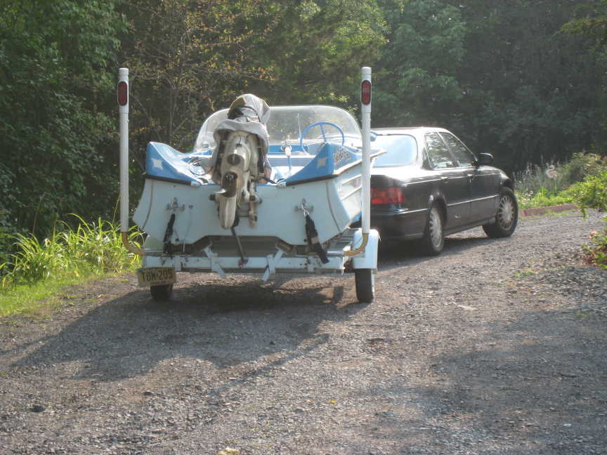

i my opinion,i would make them about a foot or so higher then the rub rail,the trailer will be on a slope when in the water on a ramp and the boat will be level,making the guides lower then when the boat is on the trailer,and you could end up with the rubrail missing them,and maybe scratching your boat.
you can also mount your lights on top they wont get wet,ron v's trailer is set up like that,john

i was thinking of the horizontal bunk style guides, on the height issue. (Don't know why, just letting you know where my head was.) Pole style you guys are right, higher the better (within reason, of course). I like Ron's with the lights in the poles, very nice IMO.

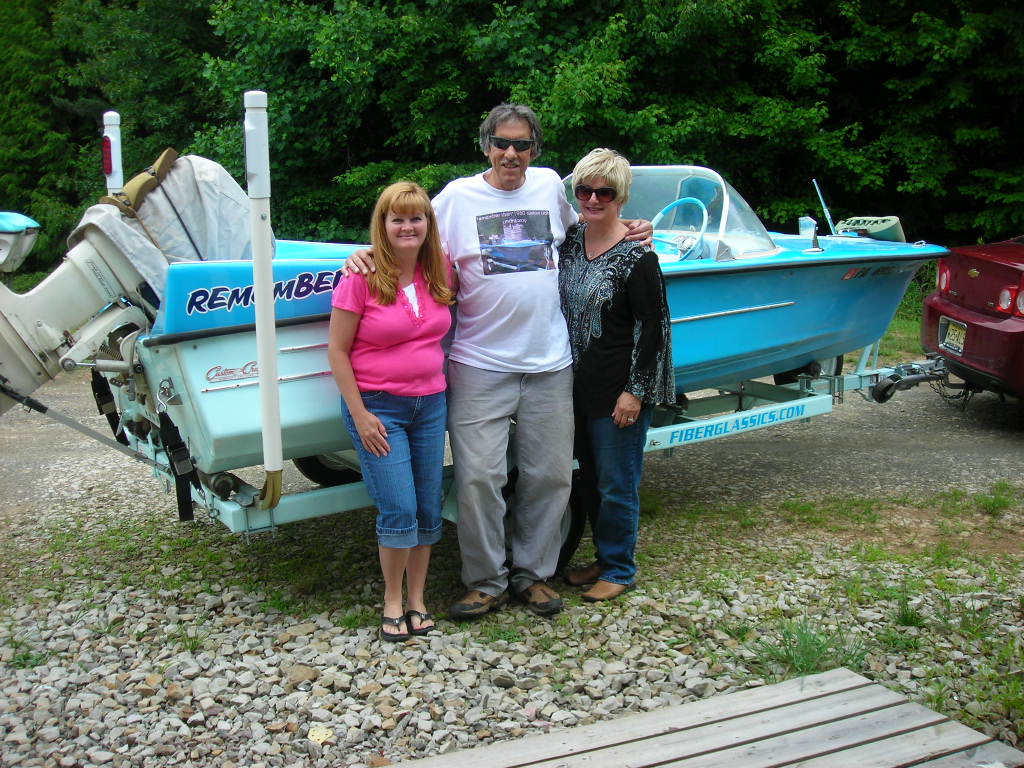

this was done by Frank Alguire Designs ltd. inc.

Hy there. I worked for metal craft trailers for 10yr. and they mounted the rails below the rub rails so the boat has no chants to hit the rub rails when you are loading your boat in the wind and waves. I have seen when the boat comes dawn on the side rails and pop the rub rail of the side of the boat. If your going with just one gide poll in the back then Franks design looks grate. Brian
