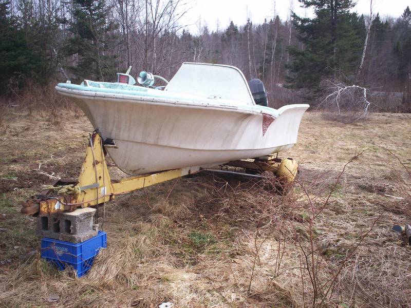

I am trying to come to an agreement to purchase this TeeNee. The owner is selling the trailer, boat and defunct motor for $500.00
I went to see the trailer yesterday and have no interest in the boat or motor and will probably dump them both if I cannot just buy the trailer alone. The trailer is in decent shape for it's age, however the teardrop fenders have a few gashes and tears in the metal near the leading and trailing edges of the tires. Can this be repaired through welding, grinding and refinishing? I am guessing so.

The boat looks to be a Leavens, made in Toronto, Canada.

It is indeed. The Victor model. The motor is practically pulling the rotten transom right off the boat! I think his ad said "Needs minor repairs". :woohoo:

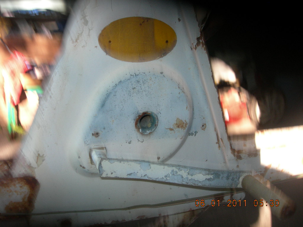

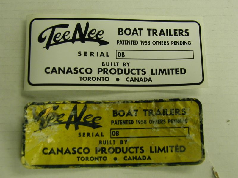

I just found mine the other day when I was looking at the bottom of the CC boat hull. It is a round aluminum plate located on the back right side of the steel cross member above the axle.
Seen here:
Notice the last year that the trailer was registered by the plate: 1988.
Based on this oval sticker on the winch tower(as pointed out earlier in this thread), I guess that this is pre-1959 model which is now a good period match for my 57 Custom Craft. Gonna get it sandblasted and fixed up after I finish the boat.

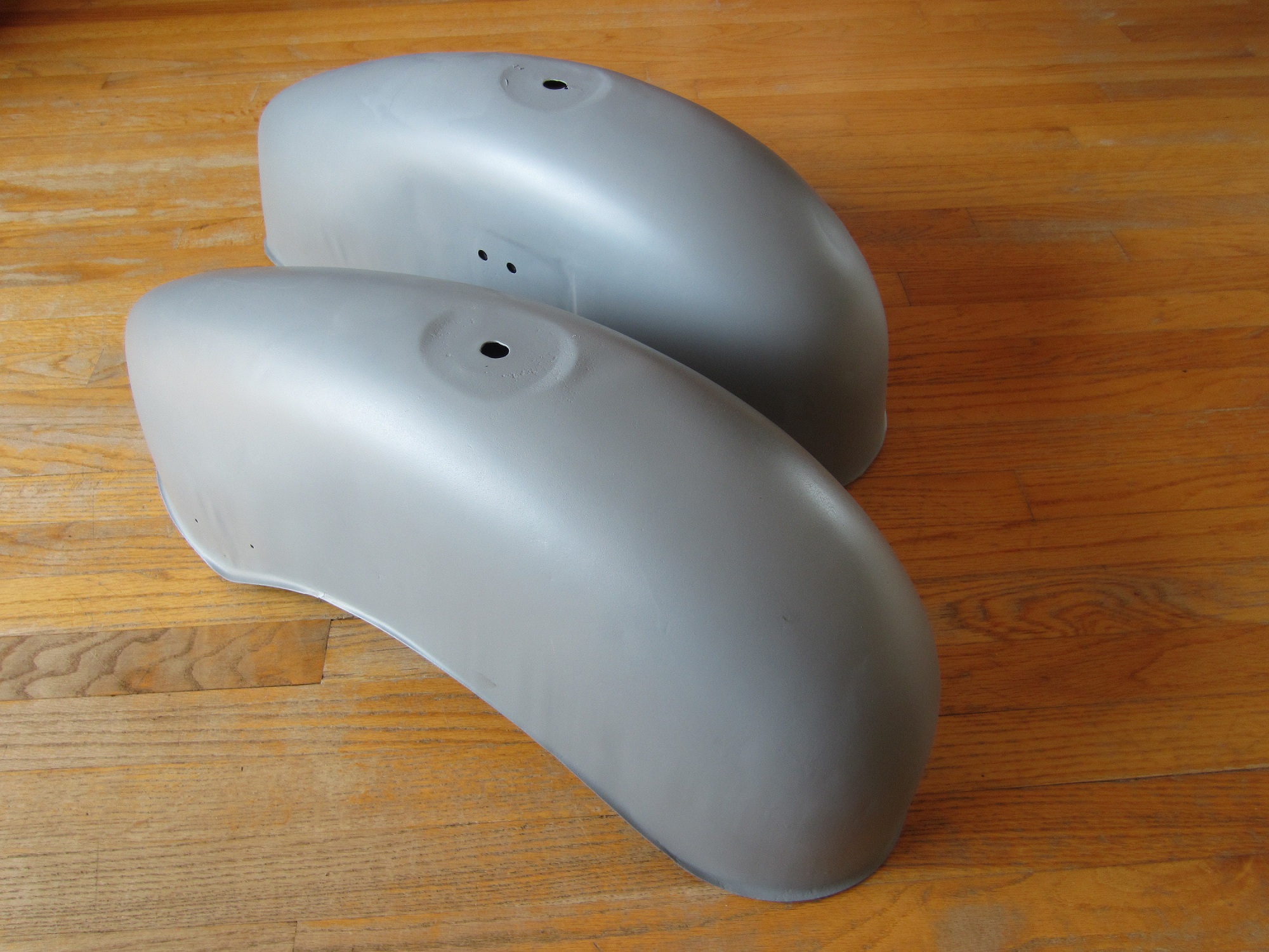

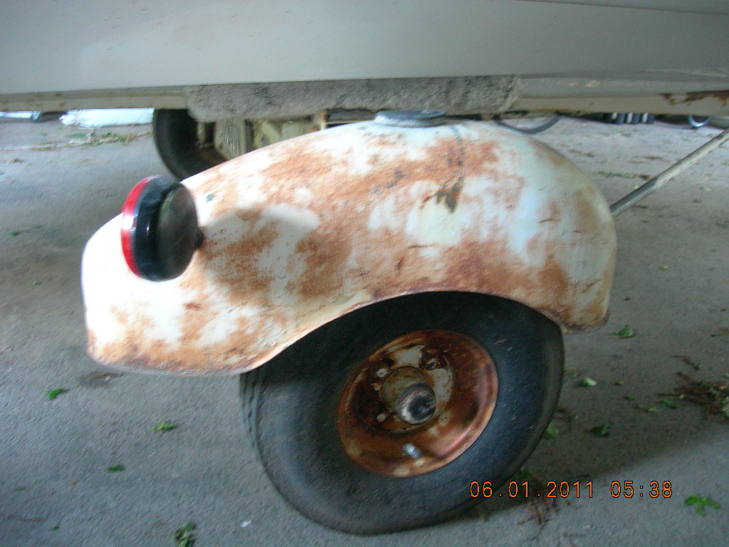

I am slowly progressing on dismantling and restoring my Tee Nee. The fenders were severely abused, torn, and rusted. Here is the original as when purchased...
Re:TeeNee Help Needed 14 years 8 months ago #57286
  • cawrsfm
  • cawrsfm's Avatar Topic Author
  • Senior Boarder
  • Senior Boarder
  • Posts: 170
  • Karma: 2
And here they are today....
Next, the winch tower.
Andrew

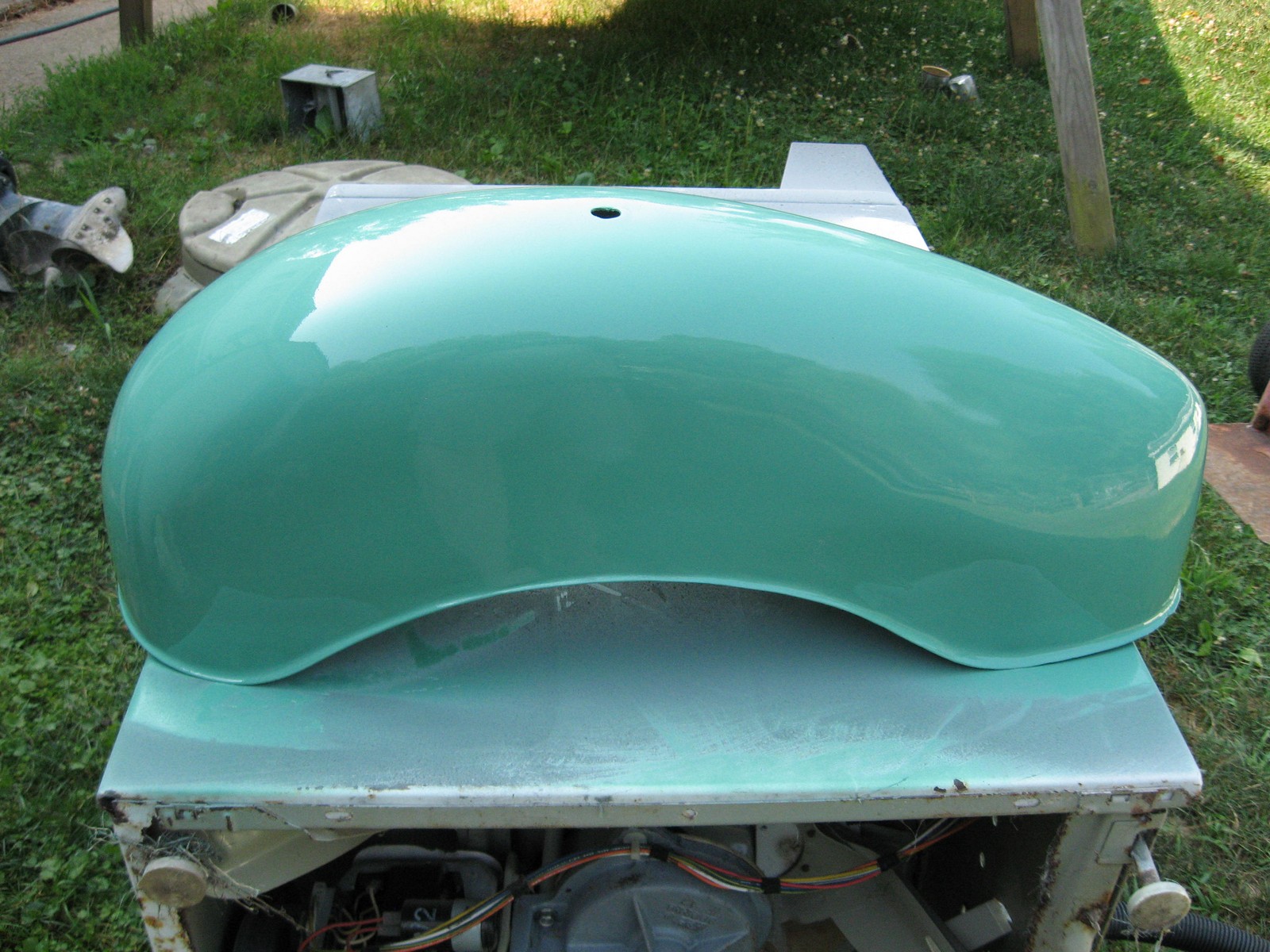

Re:TeeNee Help Needed 14 years 8 months ago #57287
  • cawrsfm
  • Senior Boarder
  • Senior Boarder
  • Posts: 170
  • Karma: 2
and another :laugh:
Re:TeeNee Help Needed 14 years 8 months ago #57313
I don't think this add is in the library. I notice that there seems to be an indentation where your step pad bolts to your fenders. Mine does not have that. Maybe that could be used to date a trailer. Mine is a 59.
