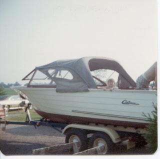

Well it is off to be sandblasted. Here it is in better days hope it looks like this again soon.

Re:Holsclaw Tandem Model C-575 15 years 5 months ago #34593
NICE work HD, she looks brand new! Looking forward to seeing a pic of your boat on it.
