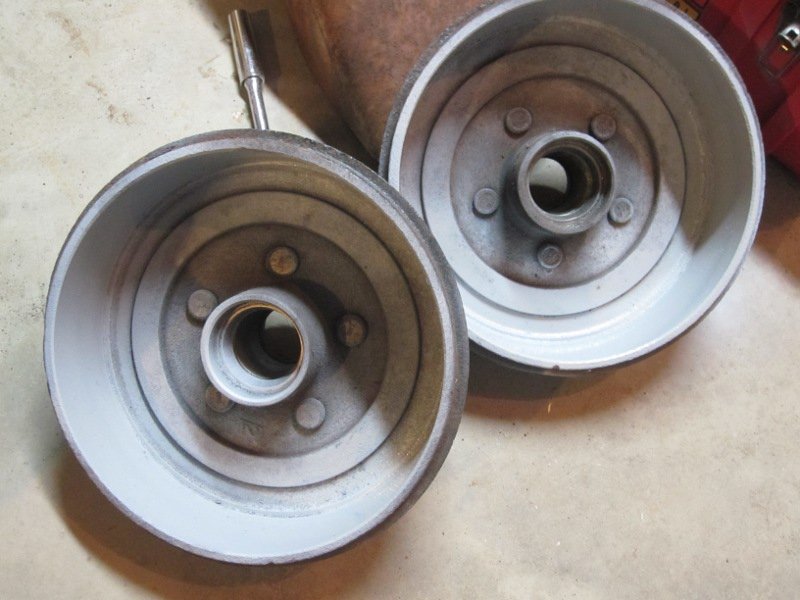

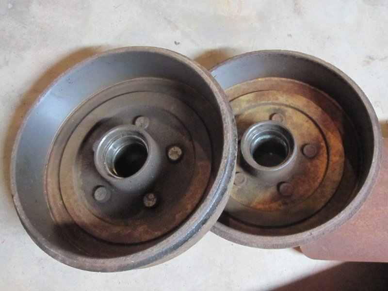

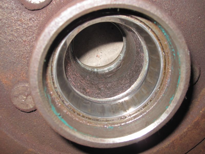

Brake drums turned 15 years 7 months ago #30387
Got my drums back today. Cleaned them & gave them a quick coat of Rust-oleum primer from a rattle can. Easy to clean off. Not sure when I can afford everything else I need for brakes, but this was a 1st step.
You can see how badly this race is scarred. You can run your fingernail around it and feel it catch. I've got kits for both hubs and hope to rebuild them tonight maybe.
Frank
