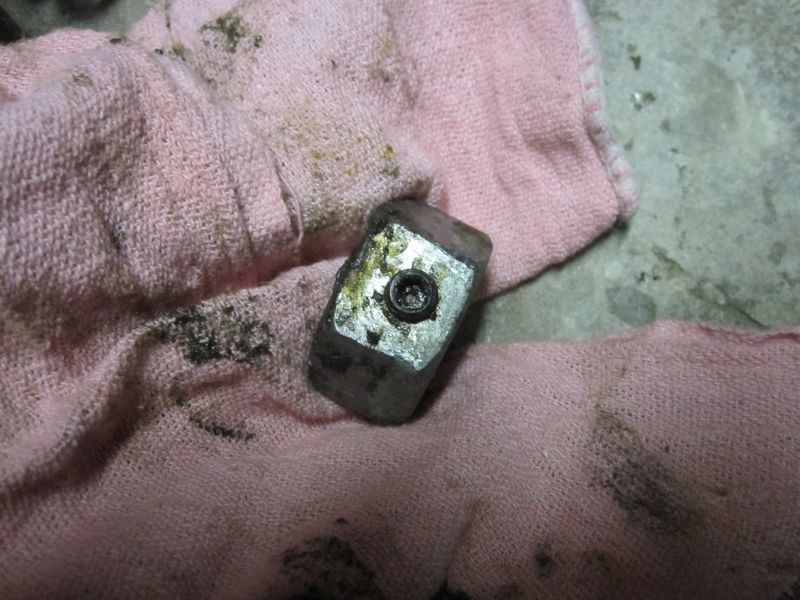

Got caught by surprise tonight disassembling a trailer axle. Couldn't find or feel a cotter pin anywhere on the nut, so started taking it off. Boy, what a bear to turn with my big channel locks, had to go get one of my big wrenches, had the right size. Gee, kept fighting it. Got towards the end, and in part due to my back, couldn't hardly turn it at all. Clean it off again with my rag, and notice this black dot on one side. Get a small screwdriver out to clean it thinking it's a cotter pin hole, but nope, seems like an allen screw! Sure enough, that's what it was. I have never seen an axle nut held in place by a set screw, but here ya go...
Not gonna be fun putting that nut back on. Gonna have to see if the nut is tough enough to rebuild the threads on the spindle. I sure hope so. I don't have any thread restorers that big! Oh well, more work. At least the bearings are standard 1" axle bearings. Everything will need to be replaced. The grease is solid.

Worked at it this a.m., got the nut going on and coming off by hand, cleaned all the solidified grease off, may have a set of rebuilt hubs that will work. We'll see.

Log splitter Mark. I think I'm gonna punch a hole through the nut and axle and convert it to cotter pin.

Frank to clean up the threads get some "valve lapping" compound put some on the thresds and work the nut back and fourth wipe the compound off and repeat again oops forgot first use a "thread file" there not very exspensive. I have used this method many times in the past. Just takes some time so be patient. Good Luck Pete
Re:Allen screw instead of cotter pin?!? 15 years 10 months ago #20964
Thanks Pete. I don't have any valve lapping compound around anymore, but I do have thread files. I used cutting oil, and it didn't take long to get the nut working so I could hand loosen/tighten it.
