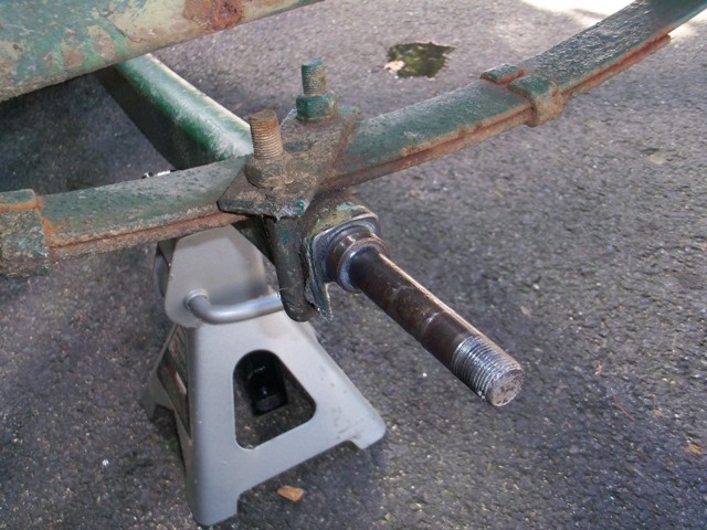

Ok how does one change a tire and rim on a wheel with no lug nuts?
I just bought a 14' Starcraft Alum with a Sears Trailer from 1969.
Model is hard to read, but I think it is 571-616440 ?
I towed it home 30 miles, and the hubs were cool to the touch, but I want to go over everything before I take it on the road again.
Thanks all!

Do you have a micrometer Jim? If so, removing a wheel and miking the axle should take less than a half hour. Remove the hub cap, pull the cotter pin, remove or loosen the axle nut, then jack that side of the trailer up and pull the hub off and measure the bearing surface of the axle. If it's 1", it's easy to find replacement hubs. NAPA carries them for instance.
Good luck!

The shaft measures .750 and the inner is 1.125.
You were right, it was like removing a prop nut.
Only problem is it is basically a rim/hub all in one. Bearings were in there.
Inners seals were shot and some water in there.
Off to Tractor Supply Co. to see if there can help.

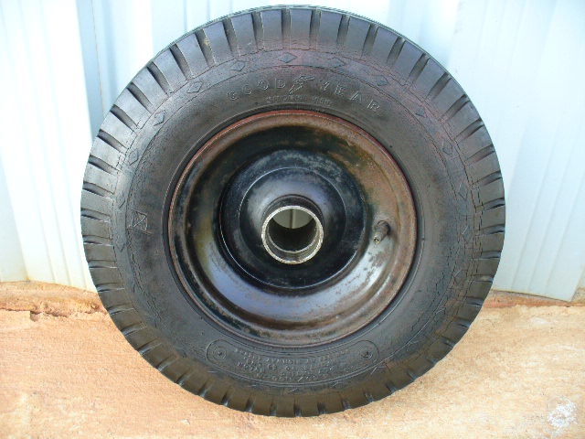

This may be too little, too late, but my family's marine business has always felt that we are most of the time very competitive. I am just now reading this post, but if we do not have the 3/4" bearing sets on hand, we should be able to supply the same components at a very significant savings, if we can receive them with a larger order to control shipping charges.
Additionally, we have a used wheel @ $14.99 (a new bearing set would additional). The inside diameter should be checked to ensure it's fitment with 3/4" bearings if you should have an interest in it for a spare rim. The existing tire is pretty old, and would best be replaced for any distance traveled however (we likely can supply a new tire if wanted as well - I can best quote this during the business week).
Good luck with your "new" boat outfit!

Re:Tire change? 16 years 2 months ago #15765
There's your spare, Jim! ;)
