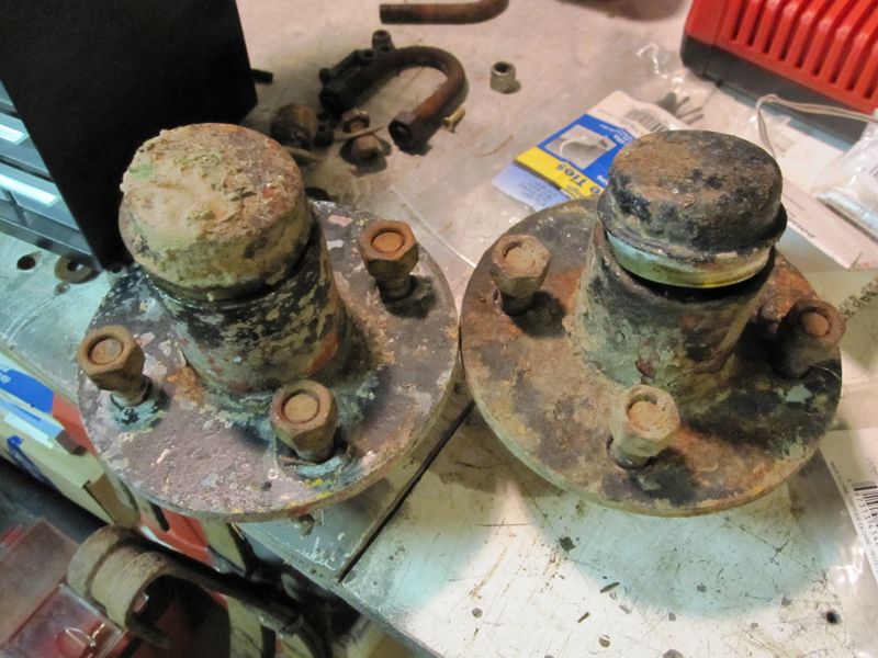

I enjoy tearing down old trailers and building new from the ruins.
It's all pretty straight forward. Once the trailer is tore down, you're left with the axle, usually after removing the trailer leaf springs. Then it's time to pull the cotter pins, remove the axle nut and start tearing the hubs down.

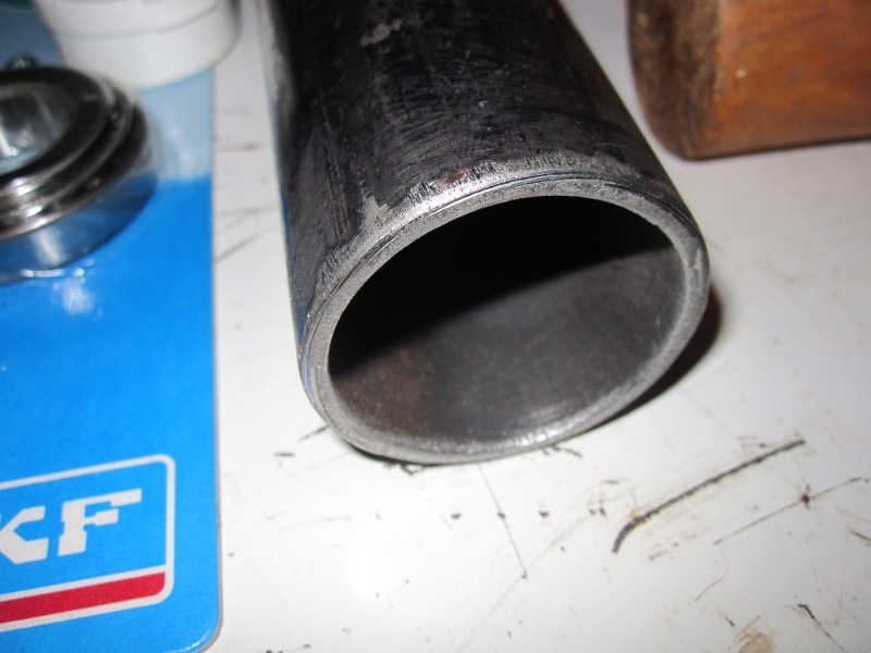

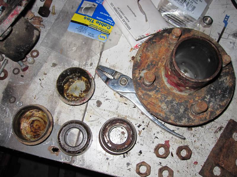

The hammer and cold chisel is how I remove the pressed in parts of the bearing. Usually there's two in trailer hubs, an outer and an inner. You go in from the other side and carefully give it good whacks evenly around the diameter of the thing.
You want to preserve parts so you know where they go, and so if necessary you can interchange bearing and seal part #s. This is (I think) a standard 1" axle shaft, very easy and inexpensive to get replacement parts for. I get kits (complete bearing set, cotter pin and new dust cap) from NAPA. They have kits to fit most all trailer axles. Cheap.
I stopped after getting just one hub tore apart. Tomorrow night I'll do the other one, then put on my specs and look things over, mike the shaft, check part #s, and continue to get everything ready for refinishing and reassembly.
You won't recognize this stuff when I'm done with it. Bear in mind it might not get done quick. I do what my back allows me to!

I did the other hub this a.m. before going to work. Cleaned everything up, checked #s, miked the bearing shaft and sure enough, standard 1" axle, takes a # 21 kit at NAPA. I had a #21 kit in the shop, just minus a 12165 seal, so ordered one kit and a seal.
More later. Need to work on the boat tonight!

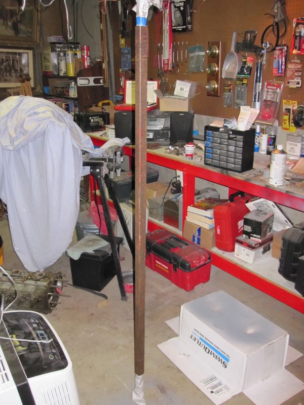

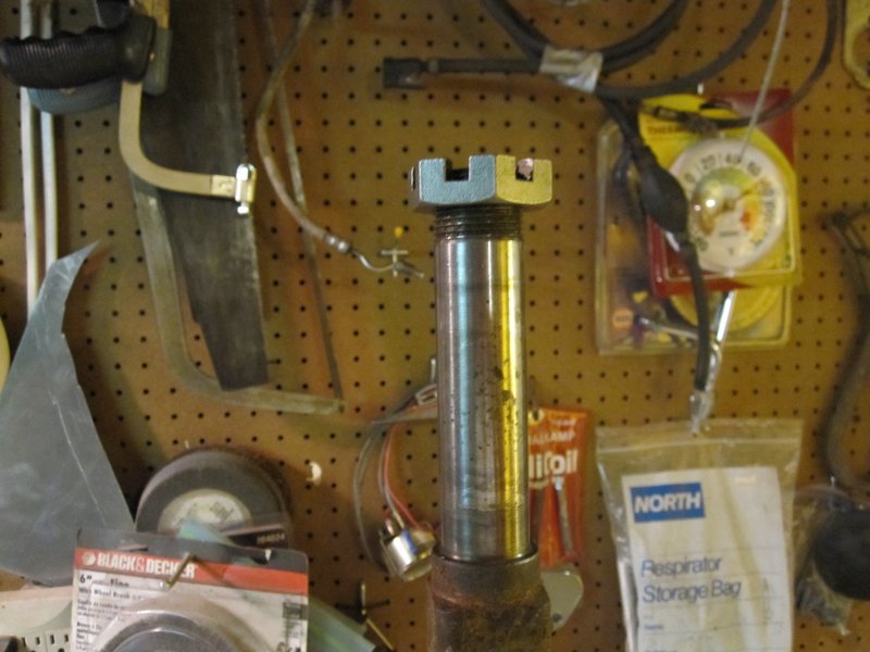

Well, I'm moving ahed here with the old axle rebuild. Found out I'm gonna have to have the u-bolts made up, nobody sells square u-bolts for 1 1/4" steel anymore. Mine are 1/2 X 3 1/4. When the time comes, I'll have Albany Spring make me up some new ones. Been there, done that!

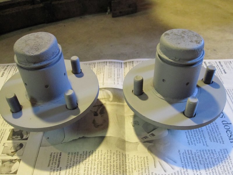

The hubs are in three coats of self etching primer (NAPA stuff of course).
Axle got cleaned, wire brushed, wiped down with acetone then NAPA's Kleanz-Easy. Bearing and seal surfaces were wrapped so they wouldn't get contaminated, then the axle was hung just off the floor (sucker is heavy!) and sprayed with three light coats of NAPA's Rust Treatment.
Next is finish color for the hubs and JB Weld for the axle to fill all the darn pits. Then primer and paint.

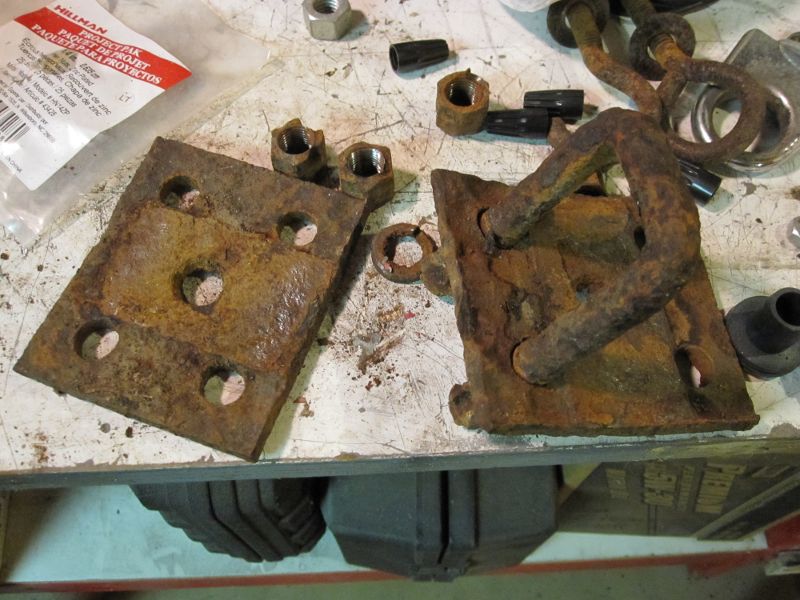

I've thought about just making matching a couple more spring plates, and using bolts. I just like the idea of using what was on it originally. We'll see!
One of the handiest sets of tools I have for working with old stuff is a set of thread restorers. I use them all the time. Taps and dies are too aggressive. Sears sells a thread restorer kit that is not too expensive and covers coarse, fine, and some metric.
Frank
Can't get u-bolts 16 years 2 months ago #14211
Albany Spring only goes down to 1 1/2". Oh well, make up a couple spring plates and use bolts! Now I'm gonna need some 3/8" scrap steel. Sheeeeesh!

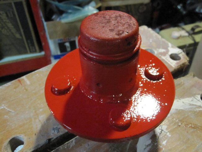

Re:Stripping an axle down 16 years 2 months ago #14236
Boy Jepster, I wish I lived closer too, I'd come over and tip a couple with ya after a hard summer day! ;)

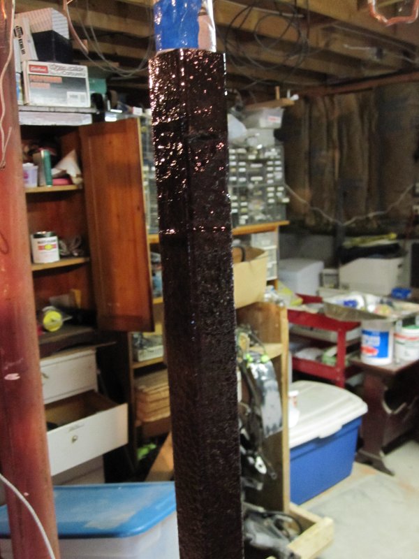

Got rust pits filled with JB Weld on almost two whole sides of the axle. Need more JB Weld! Using popsicle sticks to mix and apply.
Hubs came out looking good with 3 coats of Rustoleum red on them, that is until I dropped one freshly painted (final coat of course) in the grass. :dry:
Things could be worse.
Next (after the JB Weld is done on the axle) is trying to gently remove the center spring bolts so I can clean up the leaves. I started this a.m. on one, but no luck. I left the nut soaking in PB Blaster. We'll see if it does any good.

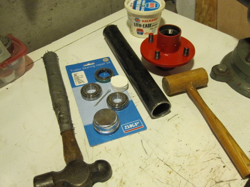

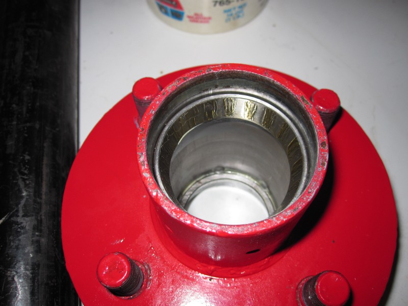

Re:Stripping an axle down 16 years 2 months ago #14709
Gee Pete, I just saw your message. I will give that dude a call tomorrow and see if he might have these 1 1/4" sq. u-bolts. I need somebody that has been in the trailer business decades and is a pack rat. Nobody sells these anymore that I can find, and they used to be very common.
Got the hubs cleaned inside and out, installed races this evening. I've got my own way that involves a bit of grease, a wooden mallet to get the race level with the hub face, a short piece of black pipe made into a race driver and my grampa's 3# sledge. Presto zippo. Took longer to take the pictures and post this than to install the races!

Thanks for trying John, I'm gonna go with new spring plates and straps I think. Old plates were 5/16 steel and I got enough for two new ones and straps.
Doesn't that sound familiar? Trailer sits rotting away and guy doesn't want to sell. I know people run into this with old boats all the time. Guy here has a neighbor who hasn't moved his old boat in years. It's got a merc 1000 on it that's newer than mine, and guy won't sell. Grrrrr!

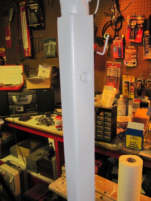

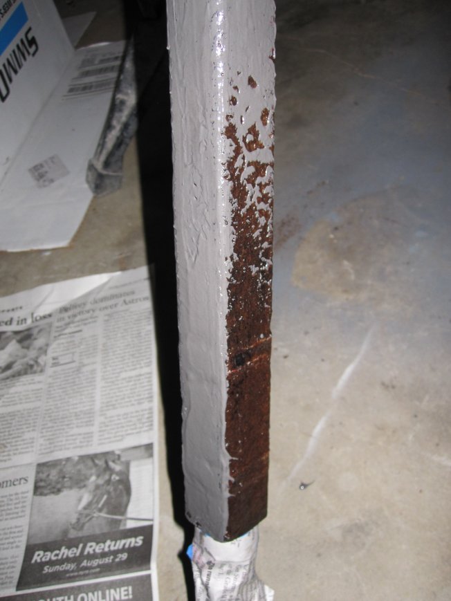

This was that old rusty badly pitted solid steel 1 1/4" square axle I started this thread with. After sanding and cleaning, I sprayed it with rust treatment (see posts above), covered it with JB Weld, sanded it, sprayed it with self etching primer to cover the bare metal exposed after sanding, did a 2nd coat, sanded it, then did a final touch up, again sprayed it with self etching primer, and here it is. I've got about 20 bucks into just the axle, and a few hours maybe. Understand I could go out and buy a similar axle for 50 bucks. No one will probably ever even see it once I put it under a trailer frame. Basically I did it because I like working with metal stuff, plus I never used JB Weld like this. We'll see how it works out.
Next is a sandable primer, then finish coats.
