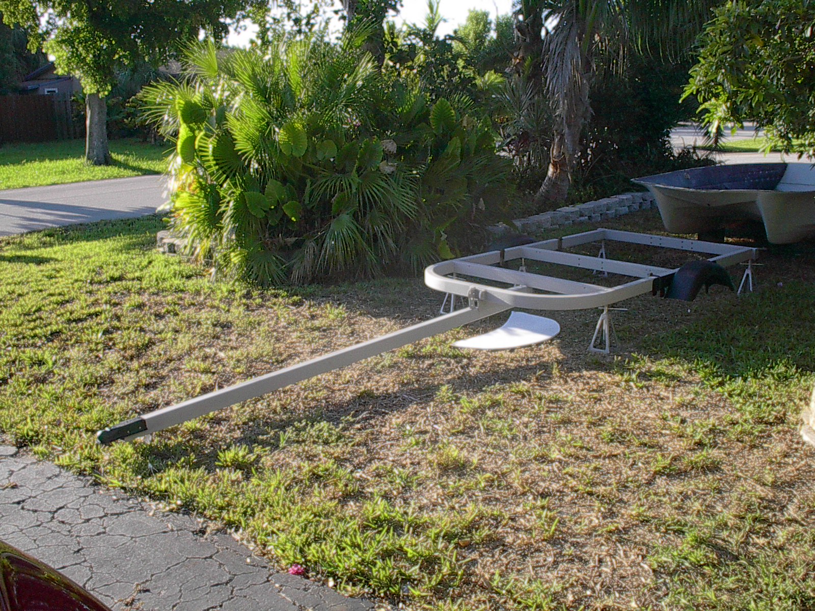

The Manta Ray came on a Snowco trailer model #ST-750 . While workin' on the boat I've also been workin' on the trailer. The 1st 3 brands of strippers used, cleaned the paint and that's about all. Found Ace Hardware brand heavy duty stripper work very well.
After stripping and buzzin' with a grinder I coated with Permetex Rust Treatment. Never used this before, used to use Permetex Extend on all frames, but it is no longer made. The Rust Treatment does not work near as well, had surface rust start in a few weeks. I sanded and another coat of Rust Treatment then primed.

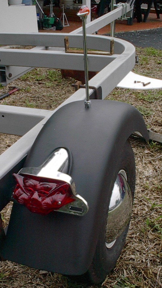

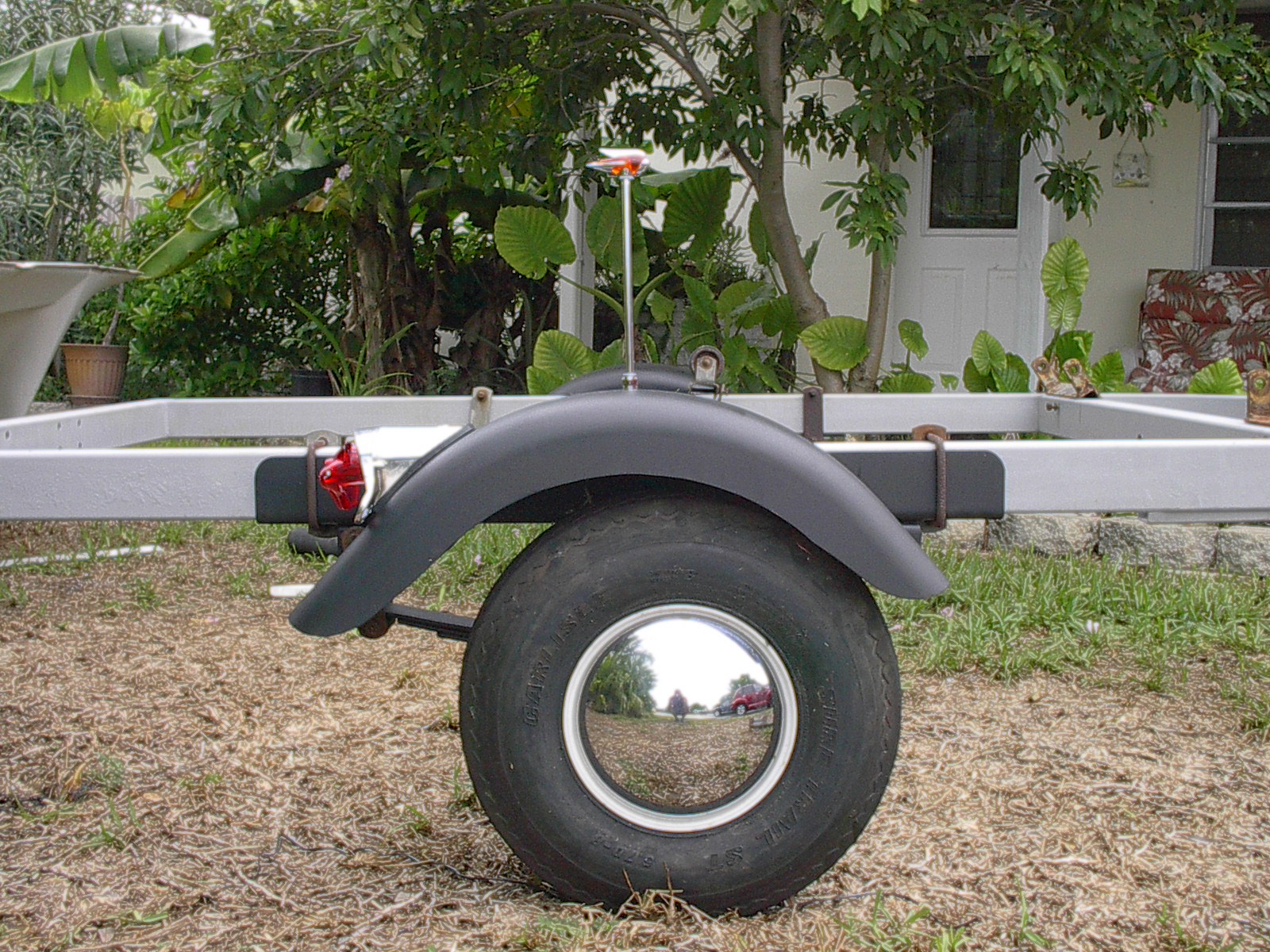

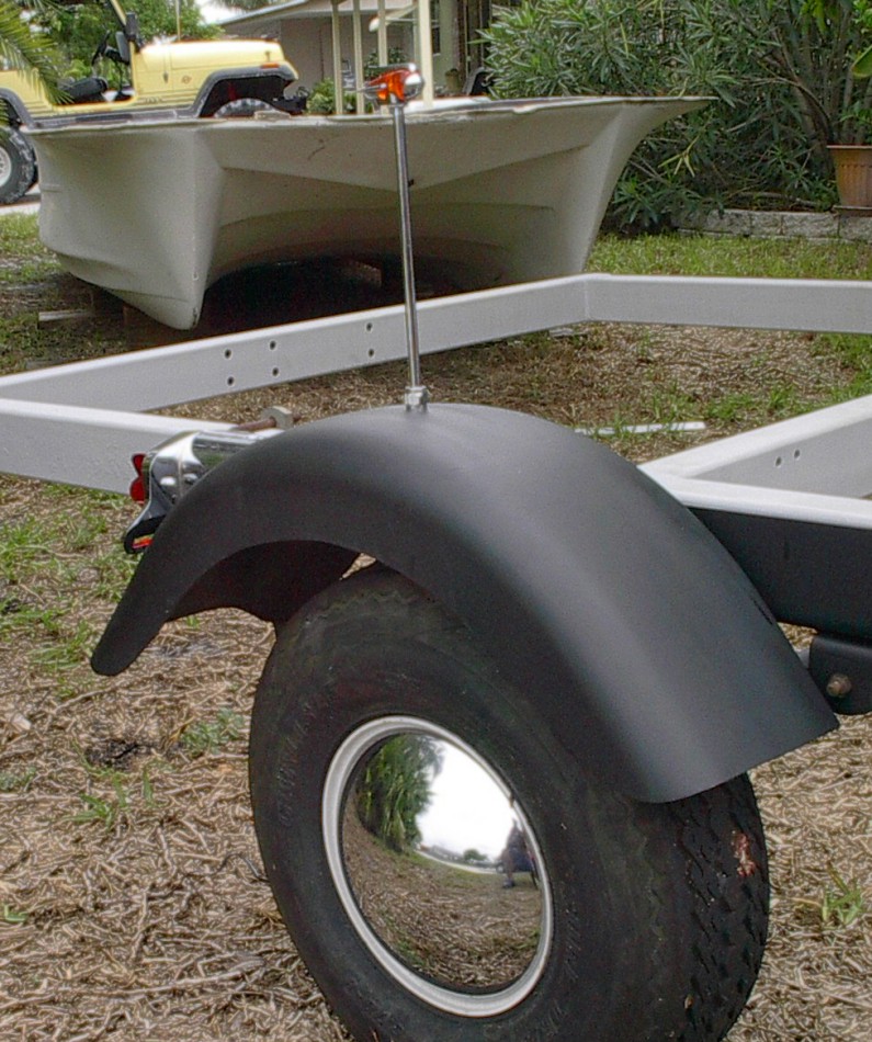

While waiting on interior parts for the Manta Ray to arrive I've been gettin' some work done on the trailer. This morning between rain I got some chromie-go-fasters fitted.

Lookin good. What's the chrome vertical rod with small light on the fender? Fenders steel or glass?
I have great success with NAPA's rust treatment, liquid or spray, been using it a long time. I use the brush on liquid usually, but used the spray on an old axle a few days ago, did a great job. Of course, I wire brushed it first, cleaned it with acetone, then used NAPA's Kleanz-Easy before the spray Rust Treatment. 3 thin coats, black axle ready for JB Weld!
Boy, that trailer looks like a Mastercraft. Snowco huh? Any idea where they were made?

Frank, The small light is a new (LED) reproduction of old aftermarket bumper mount turn signal. I've come to think of them as "cleaner fish" swimming along the manta ray. Pictured in the down position, the extend to 18". Used some brass lamp parts to change the mount. The shaft can be removed to mount the light only. The fenders are steel. I had really good luck in the past using Permitex Extend on frames, not so impressed with thier Rust Treatment. After the 2nd treatment the gray primer started turning orange in 3 days. Thinkin' bout getting it grit blasted before painting. Snowco trailers are still made in Omaha NE, the ID plate is rivited to the aft crossbar. Plate reads SNOWCO Omaha 12, Nebraska...model & serial numbers.

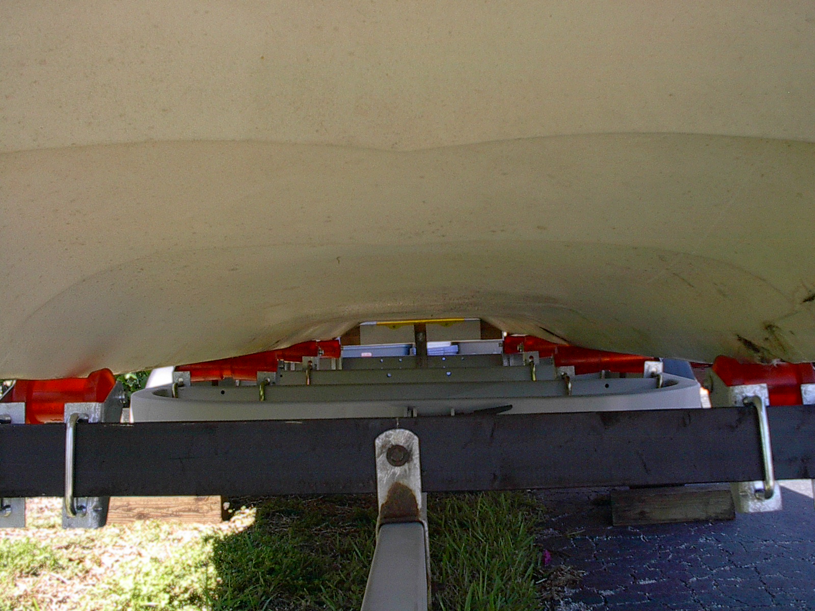

I finally got all the new rollers on. The old flat roller and brackets were real drag man. These new ones really hold the boat snug.

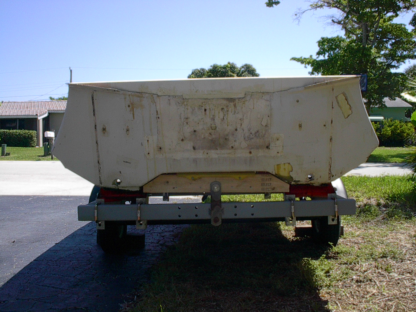

I see you sprung the extra $ for the nice poly rollers, deluxe CF! Don't think I've ever seen a cross bunk like the one in the back, transom support? It's coming together nicely bud. (Watch that back, better take it easy for a few days, right!?)

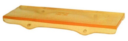

The poly rollers were just a couple $s more each here. They really seam to grip better. The trailer had the brace on the transom. It supports the transom and help center the boat The old wood was rotted so I made a temp from scrap 2x4. I did add one of these pads to the top.
Picked up a couple extra to do a couple more tunnel supports when I can get some brackets made.

cat...where did you get those rollers. spefically the stern ones with the lip on each side. ron

Ron...all the Stoltz rollers came from BOW. 5 1/2" in the front and 10" for all the rest. The "transom pad" from BOW is made by Tie Down Engineering, not listed on BOW web site tho. They come in 2", 3", 4" widths. Jamestown Distributors sell them, www.jamestowndistributors.com/userportal/show_product.do?pid=14661&familyName=Tie+Down+Trailer+Keel+Pad Should be able to get thru any marine supply the 3" is part number 86291.
