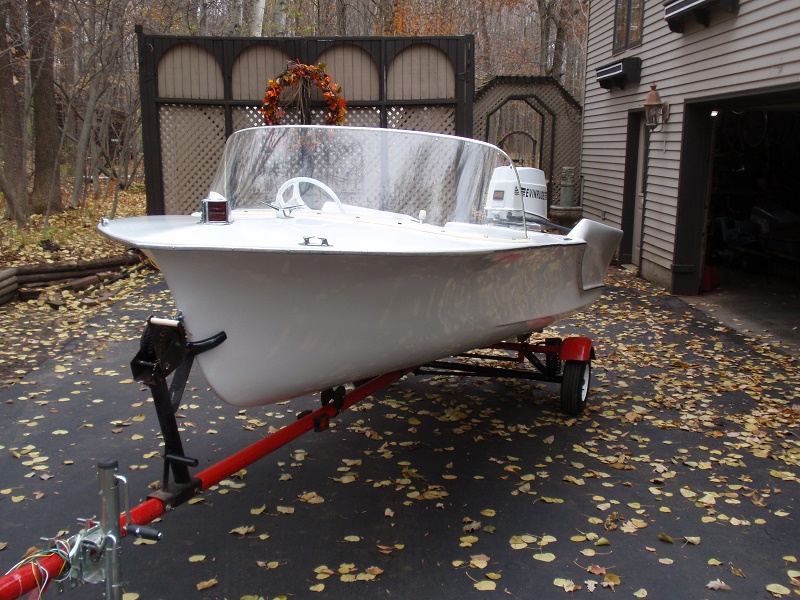

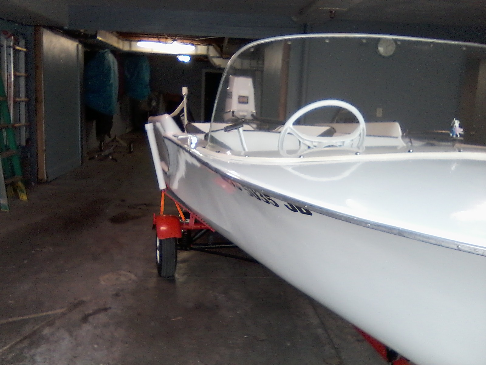

Nice original trailer but I really have to modify it to some sort of bunk style. When retrieving a boat it's a SOB to line up the exact keel on the tiny narrow rollers. When the wind is blowing it's near impossible. Any ideas?? The trailer is completely restored with new wheels, bearings, tires, LED lights and wiring.

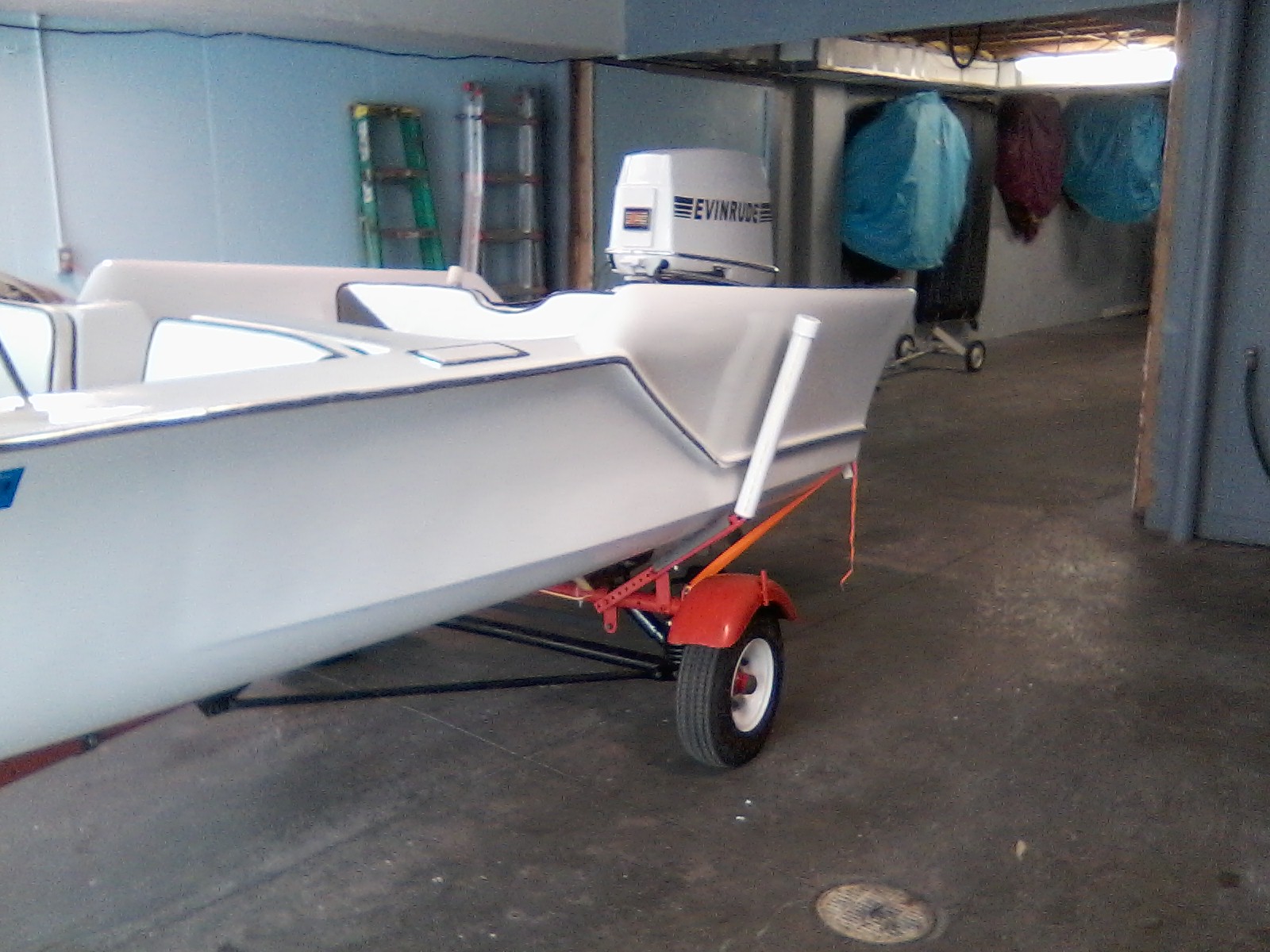

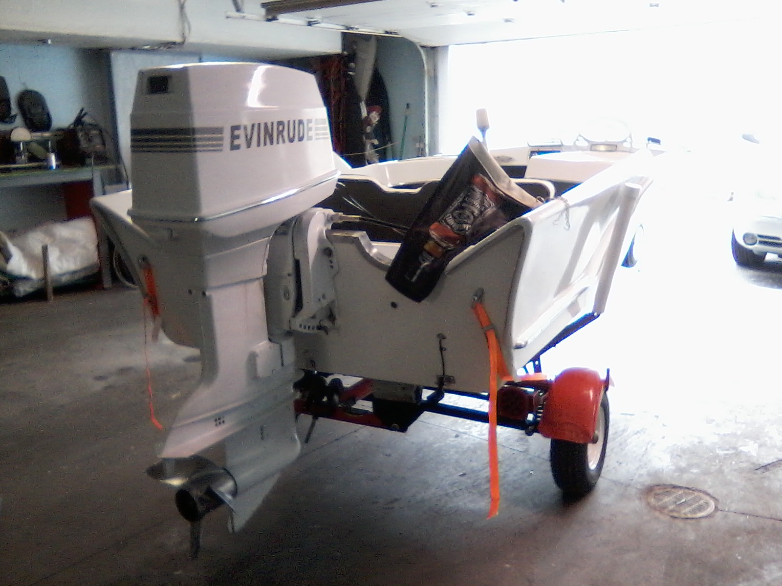

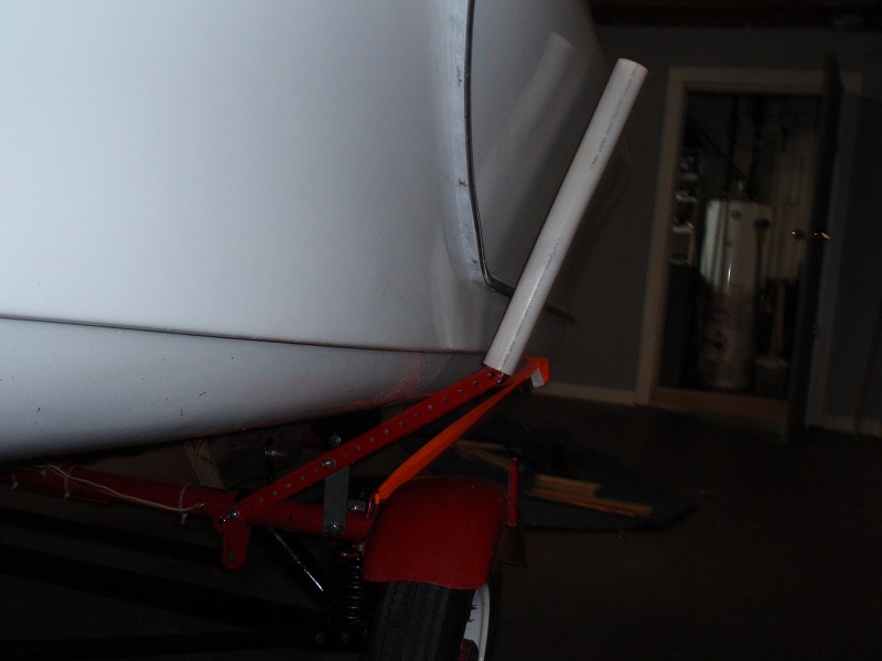

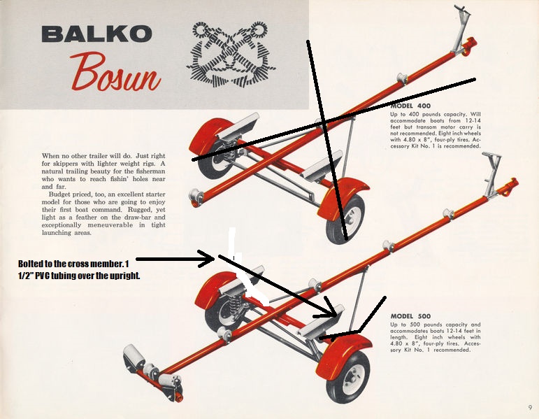

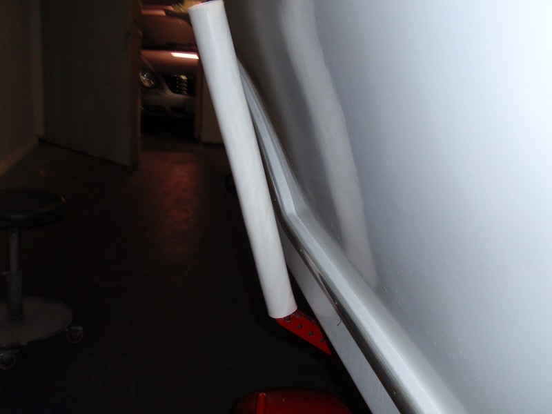

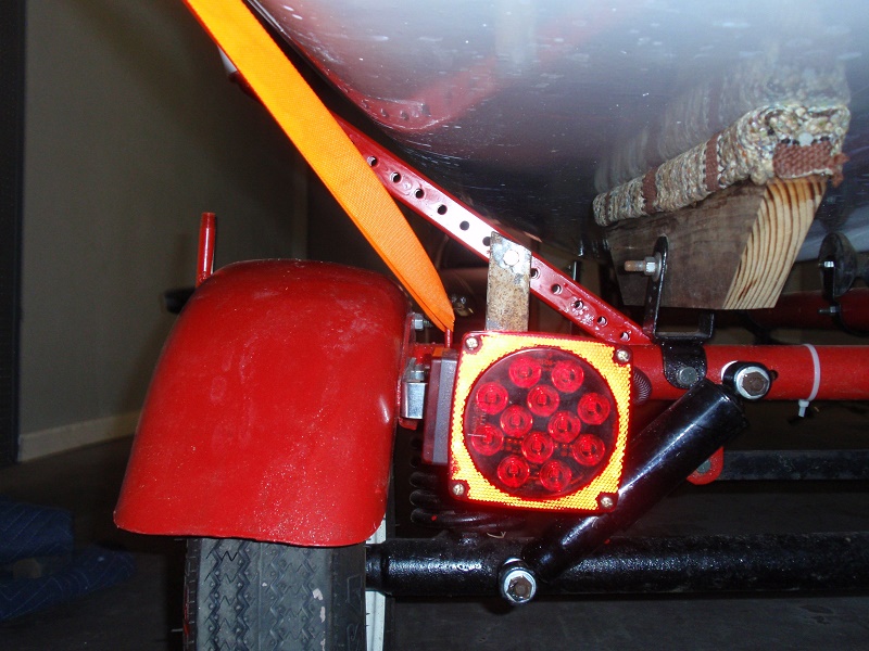

I actually put a few hours in on the project Thursday. Did some "field engineering" and welded 1 1/4" square tube, angled to match those fins on the boat and now in the process of bolting it to the rear trailer cross member. I'll post some pics later. The whole idea is to get the hull centered at a choppy launch ramp.
UPDATE
Just have to do some paint touchup. The 4" pipe nipples welded to the fenders are for holding fiberglass rods that I insert so I can see where the trailer is headed while backing up.
Balko problems 7 years 5 months ago #139531
Finished up the bracing and touch up paint. Calling this project done.
Monday/Tuesday weather should be good enough to try in at the launch ramp to see if she automatically centers itself....I hope.
