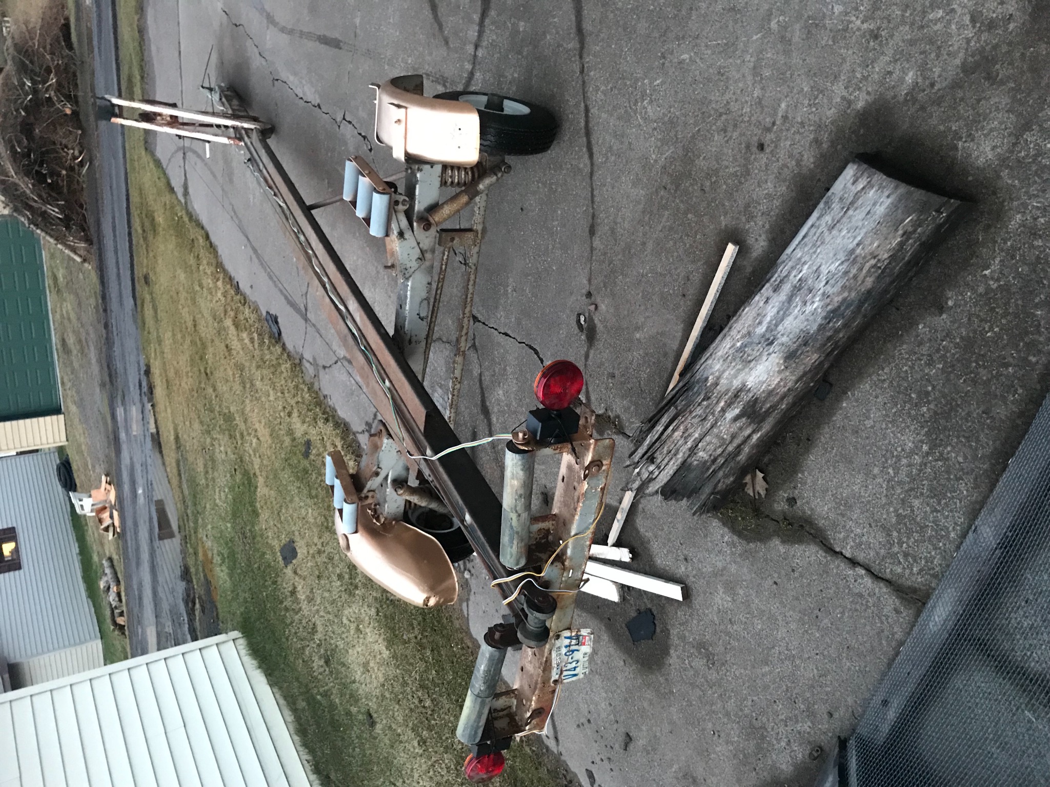

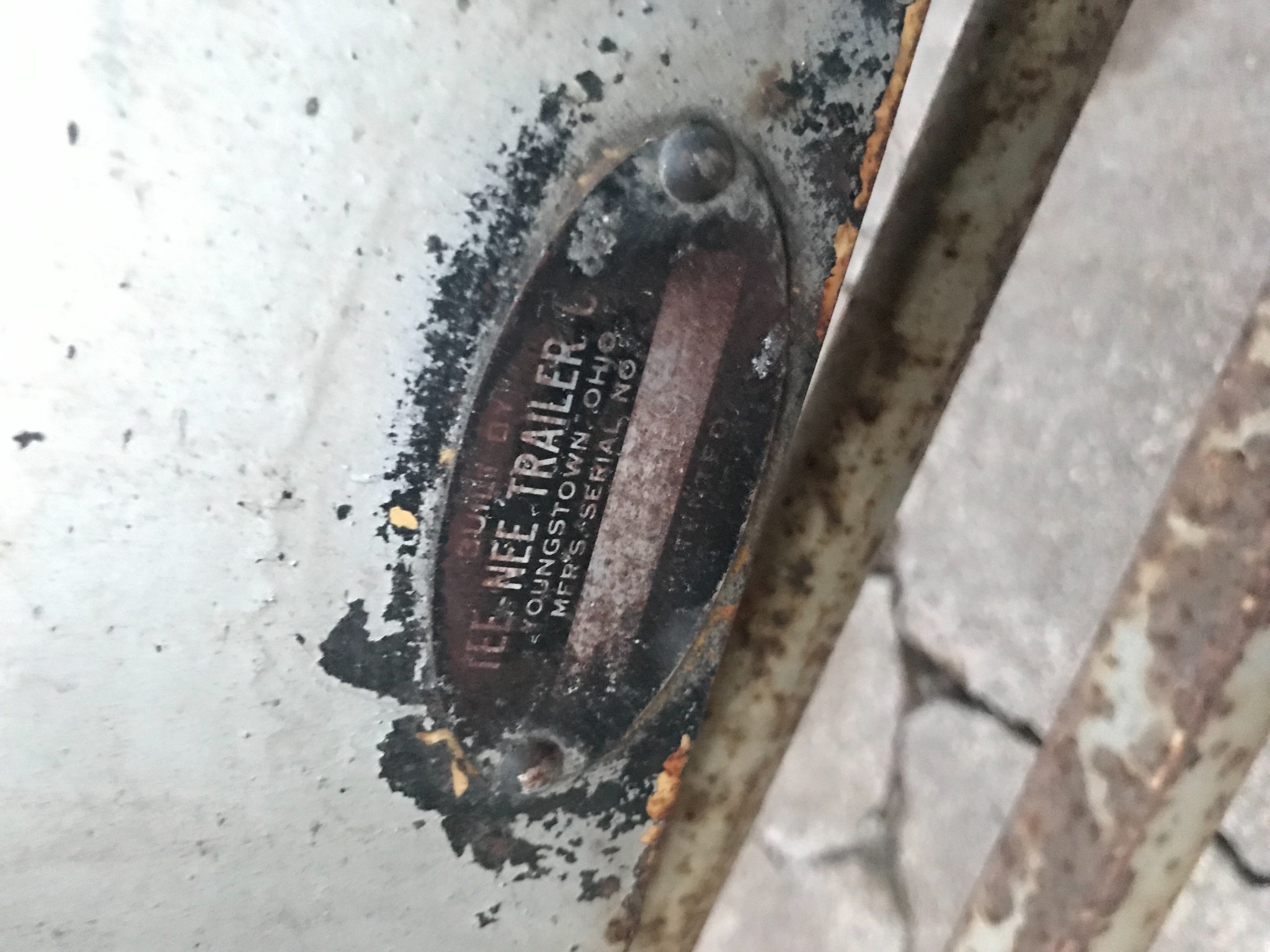

I just picked up a tee nee trailer that needs some love and could use some help identifying the year and model. The serial number is 92519 and total length is 17’. Any help is appreciated.
Tee nee trailer year/model identification 7 years 6 months ago #139433
I believe what you have is either an OB-C or an OB-70 in the 1957-59 range. I have a 60 that has a rectangular serial plate, 57 & 58s that I had had the oval plates. Not sure about 59. Maybe Del can add some more insight.

Thanks for the pictures. While stripping paint the colors match the ob-70 ad so I'll assume that. It had the lines on the fender from the light panel so 59+. It had a rectangle sticker outline on the winch also.

Well I think you nailed it on the year and model. 1959 OB-70 couple pictures
