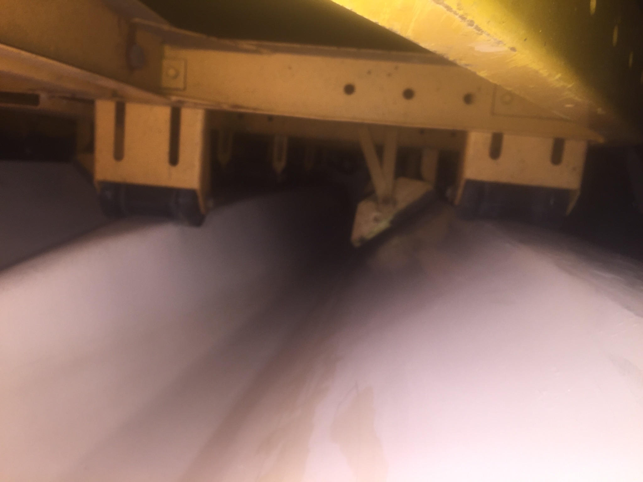

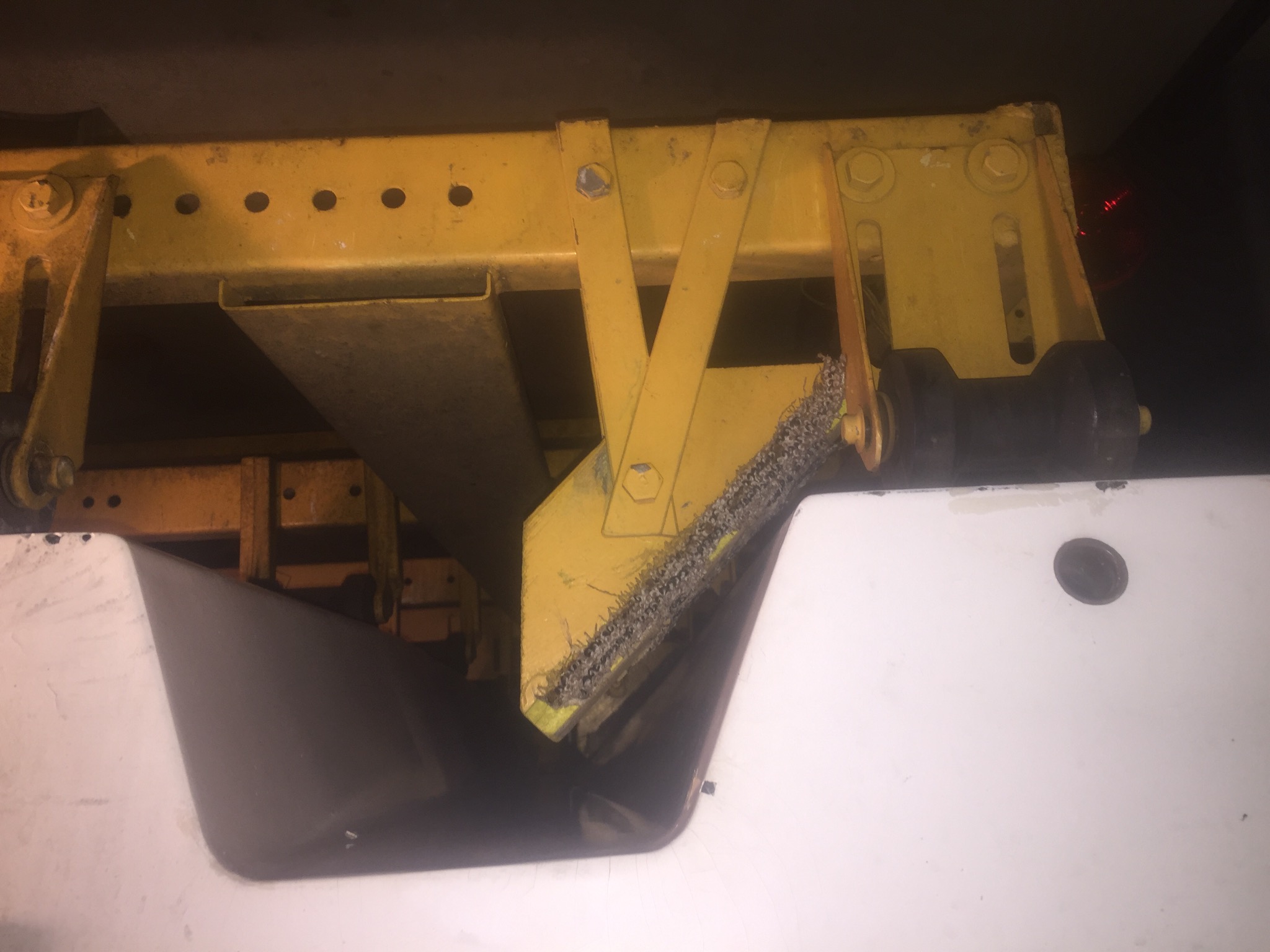

This will be slightly different, but this is from a 1965 Powercat 15T which is the triple sponson rather than a twin hull true cat. These are pictures of original TrailCar trailer that shows how this model was set up with sponson guides that would also work with a twin hull. I noticed mine used the conventional rollers, so mine sits on the high spots. My Dad had the same boat, but different brand trailer with different features, his used flat rollers about twice as wide as mine. It also used outside guides that had rollers up high, but against side of hull to keep hull centered. If either of these 2 trailers are too deep in the water, you have to be more careful with the side post so the hull doesn’t land on top of the posts. My angle guides are a little forgiving and help the hull center as it is pulled out. I have seen modern cats use 2 flat bunks or wider single bed adjusted just right, but load still on rollers under sponsons. Hope you get some pictures of twin hull cats like an old 14 or 15 footer, etc. my trailer needs a little work. I may update my wooden blocks with a running board between the front wedge and back wedge on each side and also add some new carpet.

My inner wooden wedge blocks look and be placed similar to your inside angled rollers. I have 2 on each side. Can’t tell if yours has just one angled roller per side. Seems the serve the same purpose. The rollers are probably better for the hull. I was thinking of running bunks front to back between my 2 wedge blocks. I like to look at all of the non protected metal parts of a trailer that can scratch chunks out of the fiberglass if the trailer sits at a bad angle in the launch or a huge wave or 2 hit the boat as you are loading onto a trailer. I have seen lots of boat damage at the launch when a boat miss aligns and slams metal frames and expose bolt or roller pin heads or even the outside metal of a roller bracket. I notice my 1987 trailer bunks won’t allow the hull to strike the frame even when miss aligned. I did have to add a wide front roller on my 1987 rig because the keel at the front would strike that cross member when the launch dropped the trailer too deep too quickly... and if I pull that bunk trailer back out until the back is correct, the rest of the trailer is too exposed with bunks that I would be afraid to pull out the bow eye. I like your bow catch, but if it were mine, I might tie wrap some of those foam tubes the kids play with at the beach to protect my boat from accidentally hitting all of that exposed metal framing up front. Maybe if you just look where a few wooden guide bunks covered in carpet could be placed to ensure you never strike metal, that could work. I have also seen people use a board mounted sideways across the trailer at the lower front of the sponsons to help the bow rise into place and align with the front bow stops. So the bow doesn’t go under those and scratch up the deck. Lots of trailers fit boats nicely when in place, yet some load easy and others are a pain and scratch up hull because they are so hard to center. Can you reposition your axle for proper tongue weight. My 2 old trailers have axles mounted to angle iron that is pre punched so they can be moved. They also have a pipe tube mounted sideways up front that have dumb bell counter weights that can be changed to adjust tongue weight. Looks like your trailer has lots of potential and seems to be fairly custom fit. Good luck whatever you decide. I have seen a few short cats that people just put on a flat wooden deck covered in marine carpet and the boat fits ever time. Can’t remember if the use modern side post guides. The likely mostly flair it on with minor dragging.

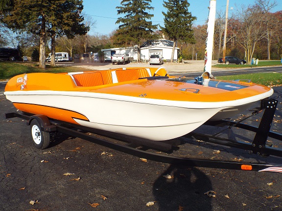

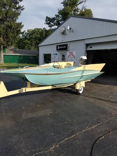

Here the pontoon trailer but I also make a 8x8x2ft block in middle to center boat
Powercat- what does your trailer look like? 7 years 11 months ago #138388
