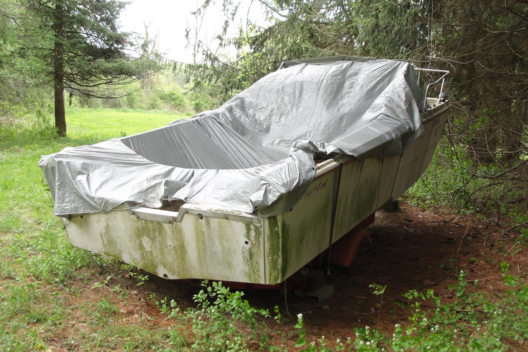

Hi,

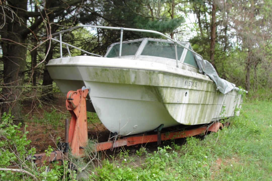

Does anyone have or know where to find the length, width, and transom to bow eye measurements for an approximately 17' Thunderbird 1960's Tri-Hull boat? I have attached some pictures. I need these measurements for a new trailer. The boat is in New York and I am in California.
Many thanks!

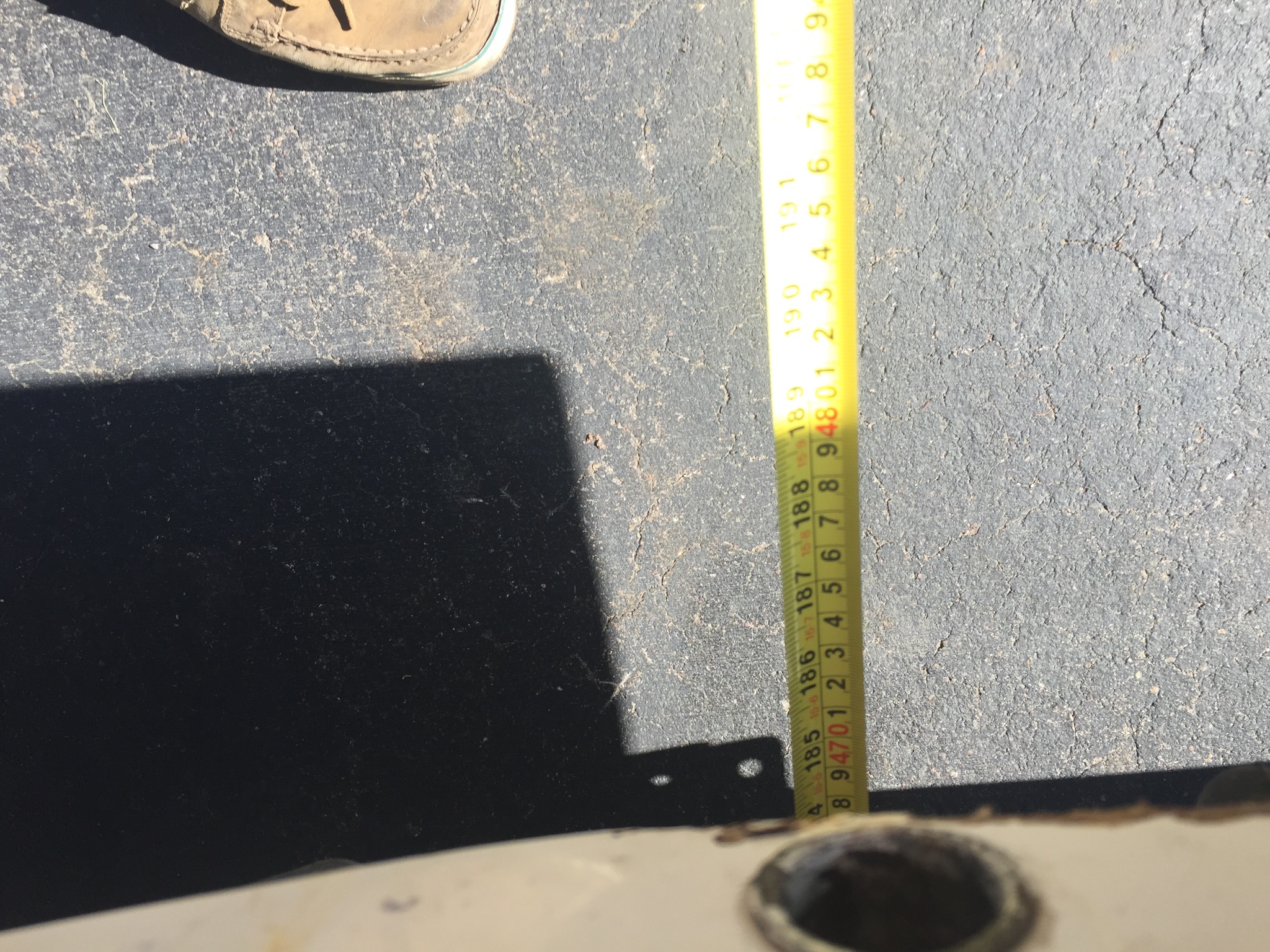

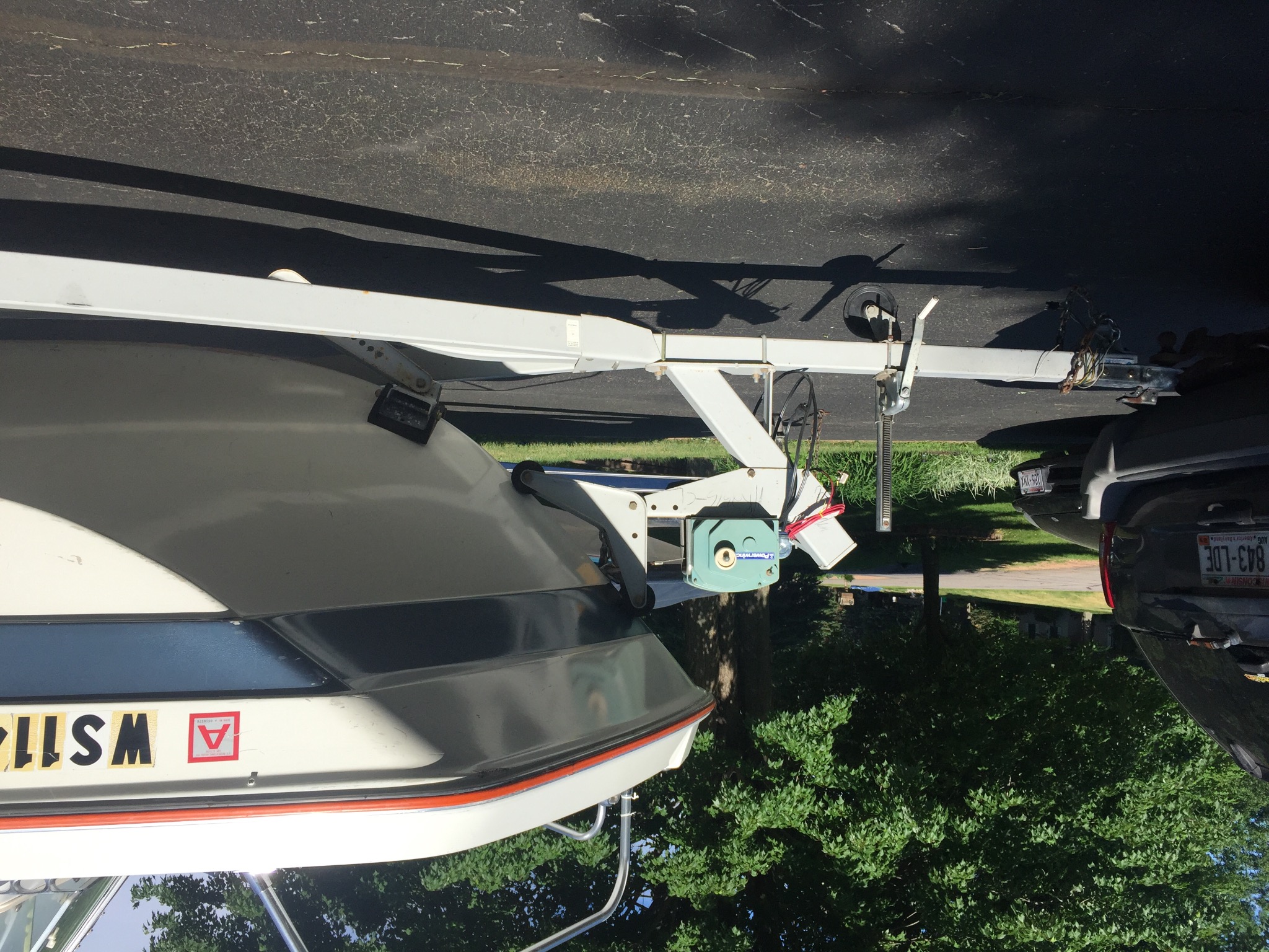

Here are those measurements. Width at transom 6 feet. Length 17 feet - maybe plus an inch. Under side of bow eye to transom at bottom 187 and a half inch. Ithe front of the tape measure was laying on the trailer and I was eyeballing up vertically. I will attach some pictures. Sorry if they are upside down or sideways.

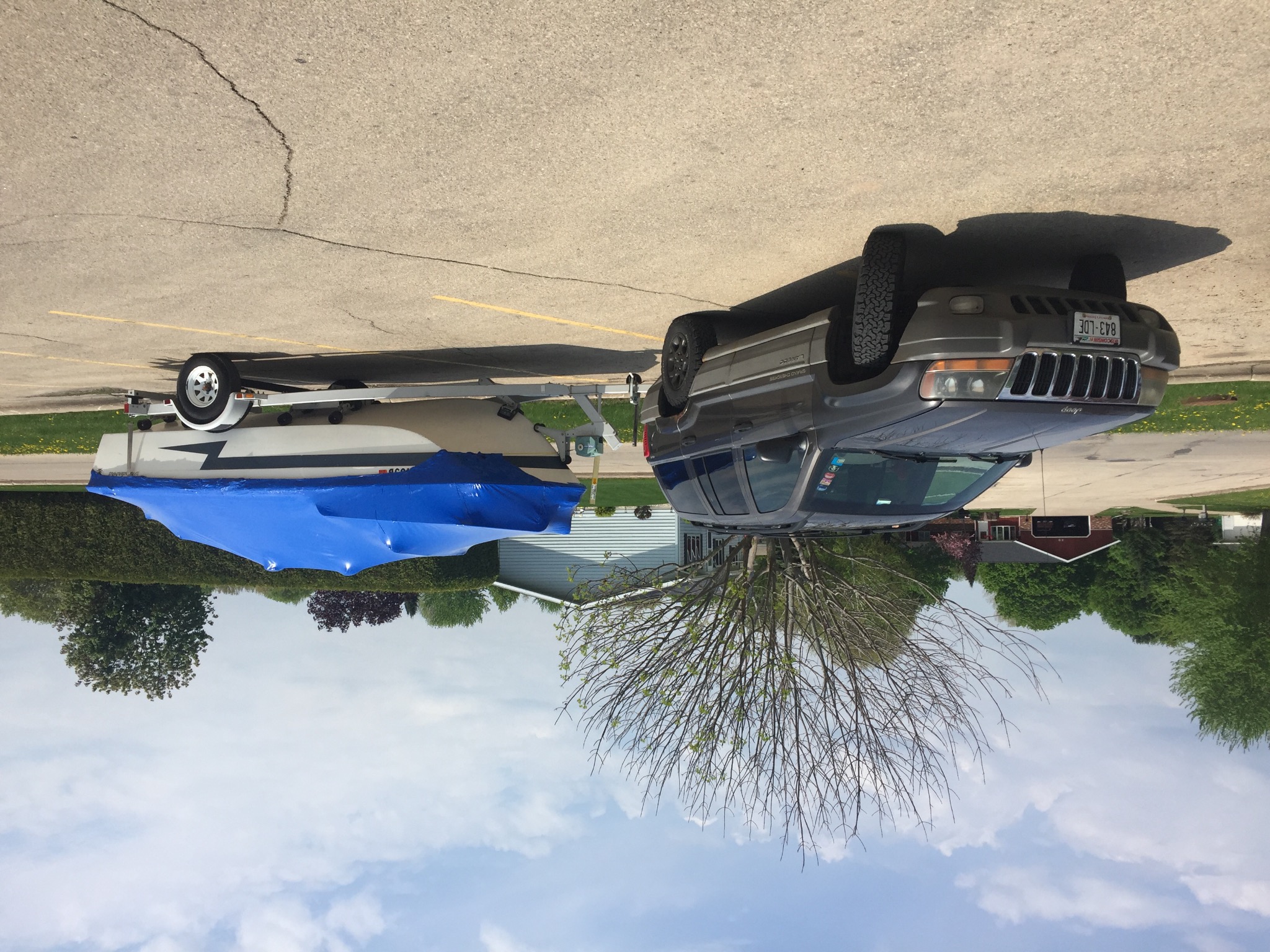

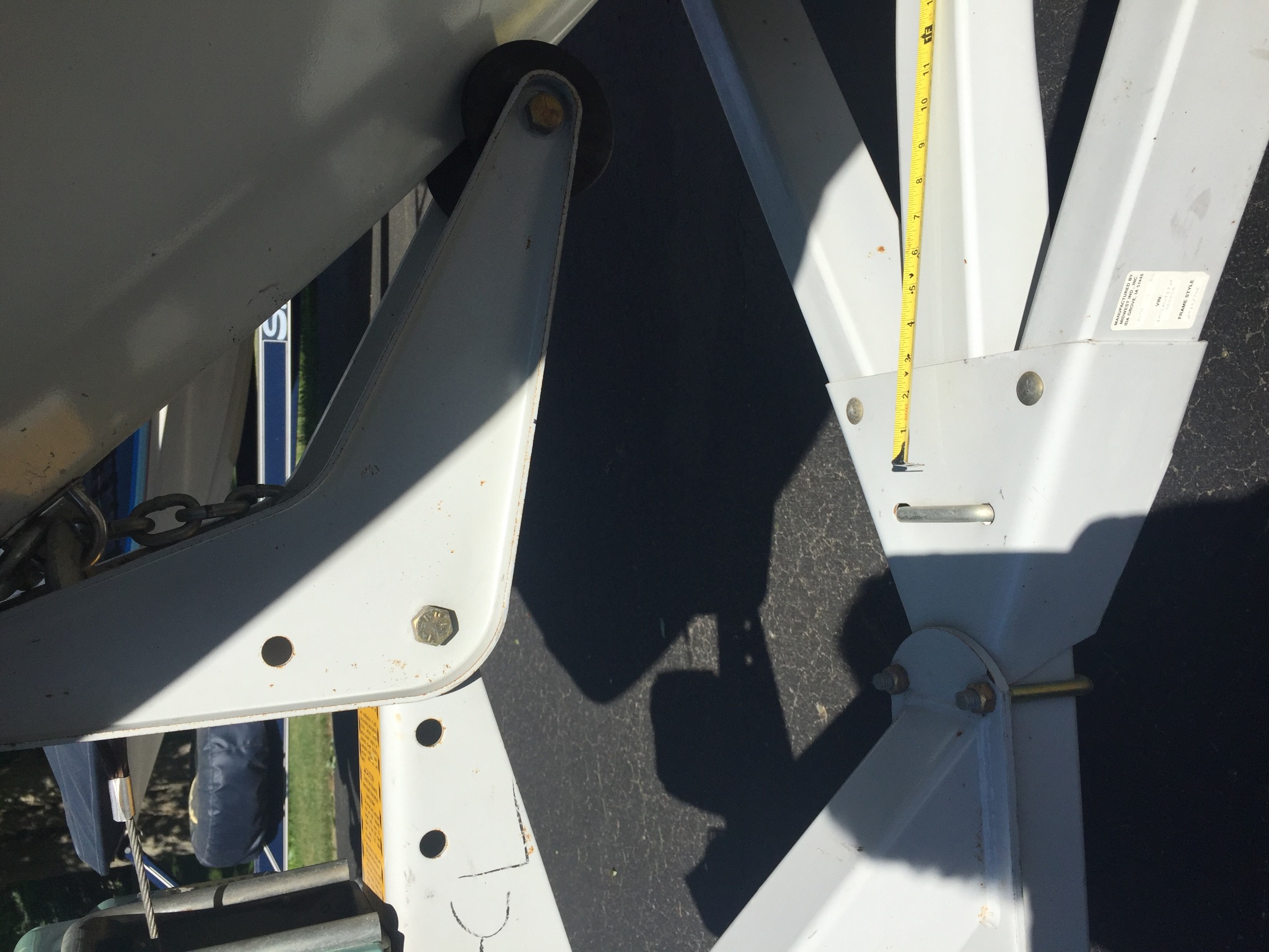

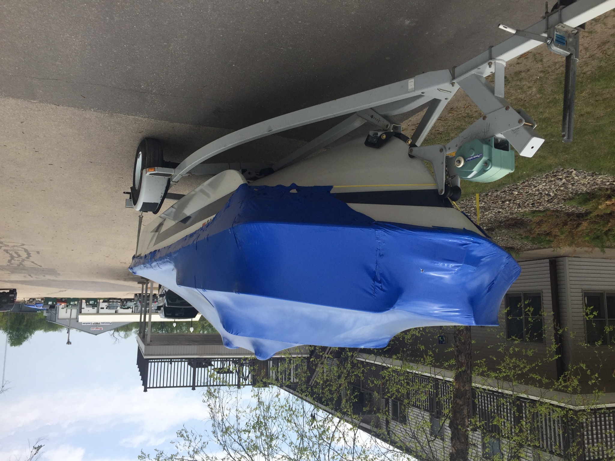

the last picture is the trailer tag. I have not looked up the company to see if they still make this. Likely their are many roller trailer brands that make a similar trailer. I would think with these pivoting roller trailers would adapt to any slight differences in hulls. I included several other pictures just so you can see the geometry and tongue length. Hope this helps a bit more.

Tongue to tail length was 20 feet. Pivot roller type per previous pictures.
