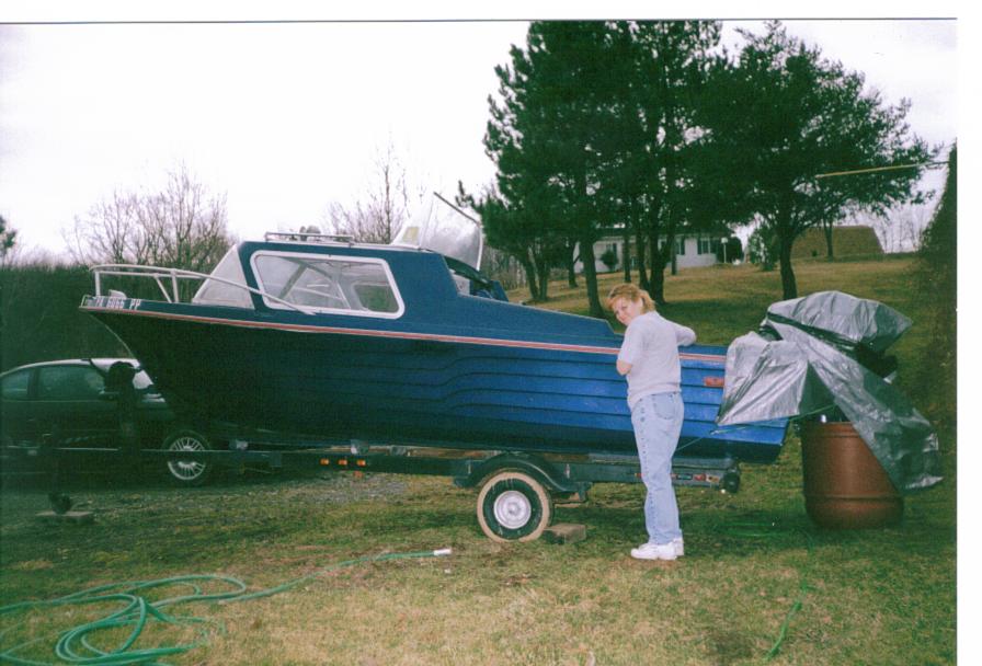

i had a 1964 seaking cabin cruiser with the original seaking 1964 trailer,with 8 inch tires,and had a flat,i carry fix a flat in emergencies,got back on the road and i go slow with a trailer,and then the side wall blew out,so i put 12 inch tires and rims,they were to big to put back on the fenders ,but what the heck,it gave me more peace of mind,i think 8 inchers were not enough for that old boat,it was very heavy.below is before and after.
